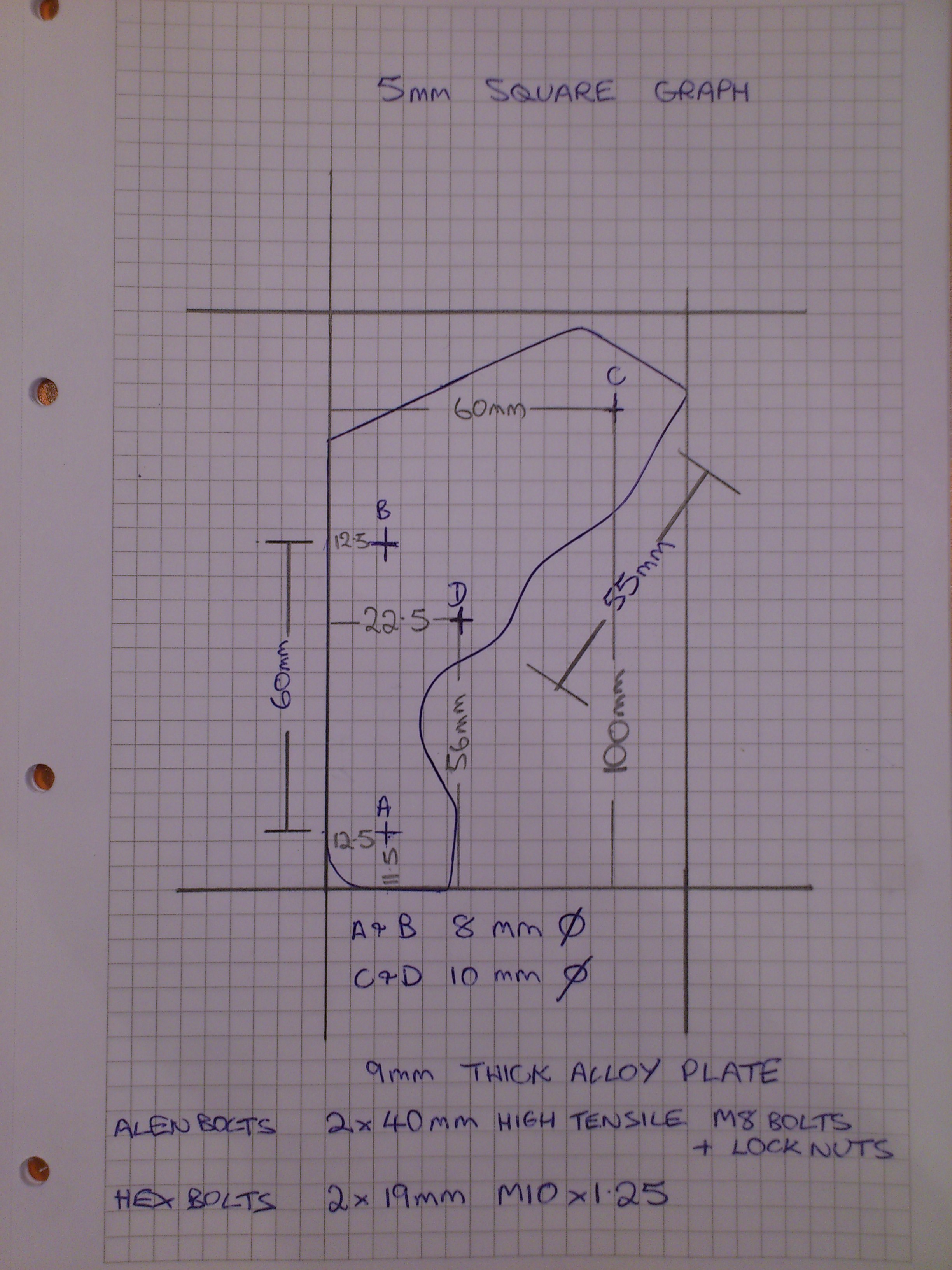

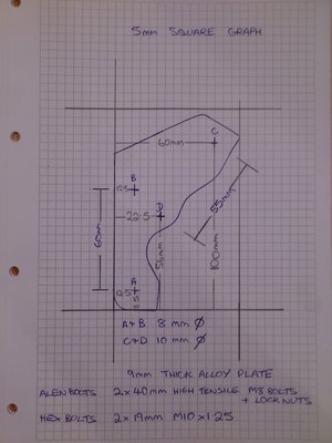

Postby Malcvtr » Mon Apr 08, 2019 6:10 am
I can’t remember where it was - it could have been here - but someone posted this:
Baghira front caliper plate
This is to suit a K5 or K6 650 Suzuki (arse) Bandit left hand Tokico caliper (non ABS), a cheaper and easier to find alternative to Brembo.
It perfoms much better than the OE Grimey thing even with the original master cylinder.
