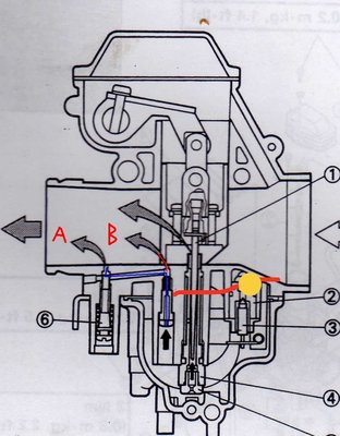

I have a problem with poor low speed running after heavy acceleration followed by heavy braking (The two often go hand in hand!) on the Mastiff.It has the symptoms of a semi-blocked pilot jet -won`t idle, coughs and splutters at small throttle openings, fine at larger ones.
It doesn`t sort itself out, but draining and flushing the float bowl (Which takes just a few minutes) gets me running fine until the next time.

I`m curios as to the `mechanism` by which this happens, if there is muck in there it should always be a problem not just after its been `given a big handful`surely?

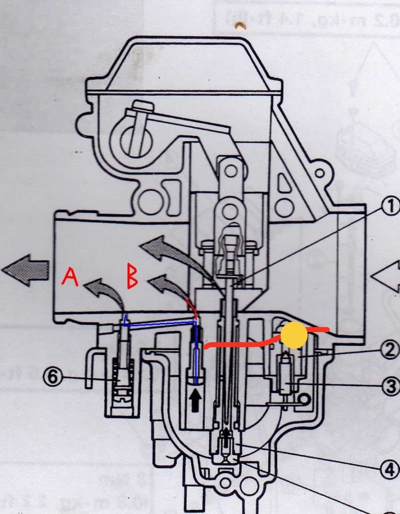

Took out the slow running adjustment screw(6) and blasted aerosol carb cleaner up the hole it came out of, and put the screw back in; it`s been fine ever since!!! :D :D
