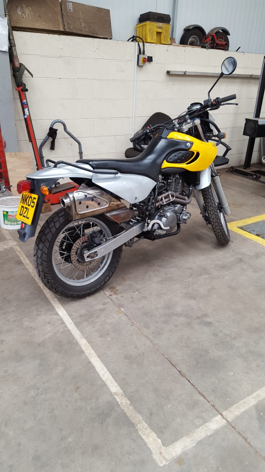

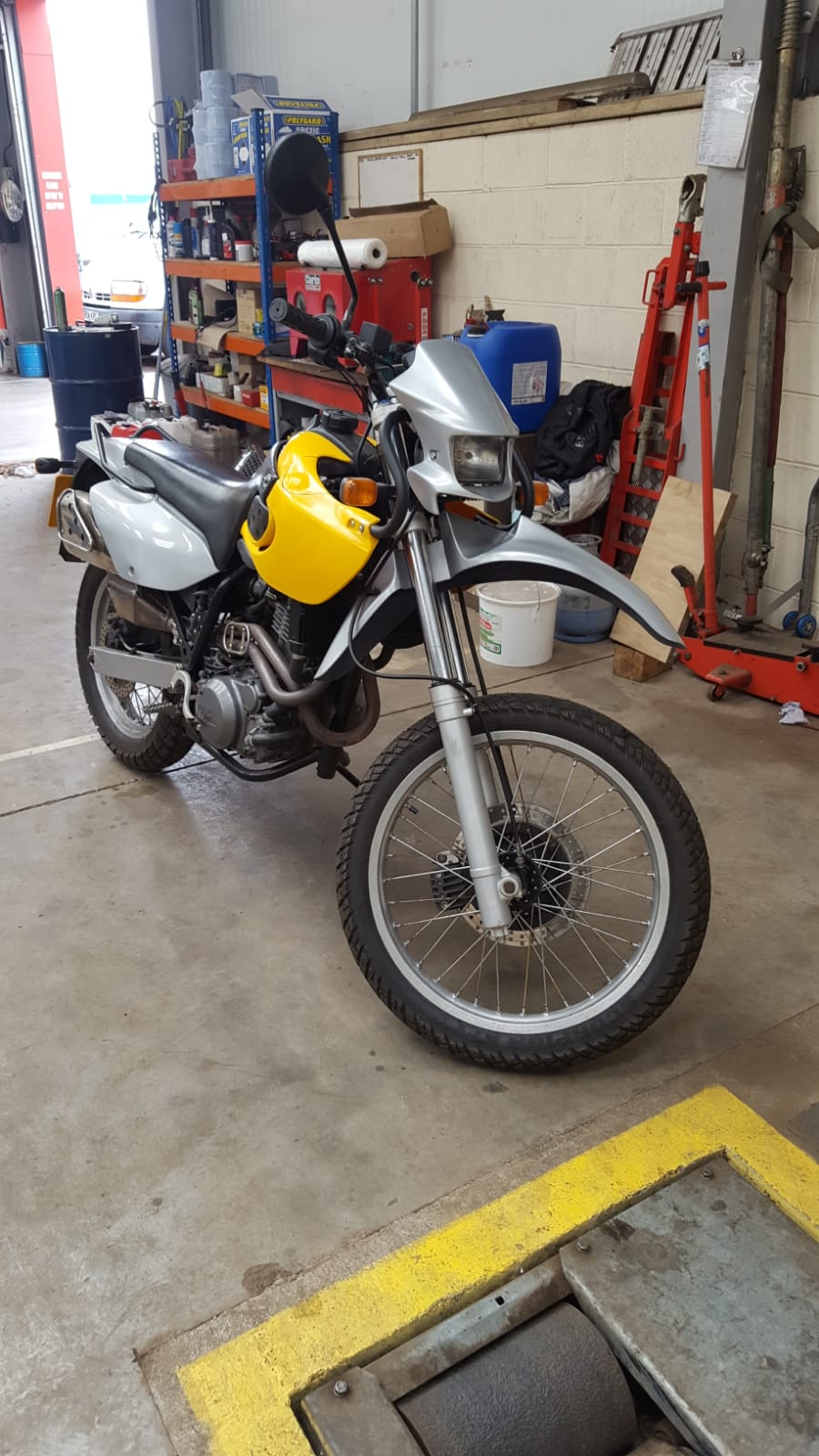

Postby Malcvtr » Sat Jul 28, 2018 12:59 pm
The bike...

Postby breakwellmz » Sun Jul 29, 2018 1:03 am
It does look low at the back without the front having been lowered by the same amount, how about sliding the forks up in the yolks when you change the fork seals? Having material added to the subframe sounds tiresome and expensive!
