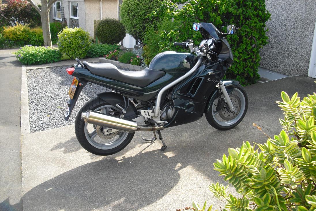

Postby manxie » Sun Jan 14, 2018 10:10 am
I sold my Skorpion Sport because I couldn`t get on with the riding position and to be truthful, was a bit of a dog. However, apart from the riding position I loved the bike.
So today I went out and bought a 2000 Skorpion Traveller. All original except indicators (originals with the bike) in lovely condition and also comes with the original panniers. I`m taking delivery of it next week end and just looking forward to some dry warm weather now :( :(
