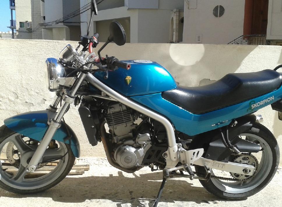

:smt006 Hi agian,
can someone redirect me to a list of Paint codes for MZ 660 Scorpion Tour ?
I am about to spray the front mud guard. its a metallic turquoise color (original)
being on the same subject I would like to know the paint codes of the
Frame :
Wheels :
Engine :
and of course Bodywork :
wishing a good day to all :)

David, I found a list compiled by Norman Wade.
190 dark black RAL 9005
200 mint green RAL 6029
220 traffic white RAL 9016
240 signal yellow RAL 1003
270 aquablue, pearly C5U
280 brilliant black metallic A9V
290 classic green pearly C6V
350 bordeaux, pearly C3Y
360 tornado red Y3D
370 turquoise metallic B6T
380 blue pearly LZ5M
390 green classical C6U
400 orange RAL 2008
A10 avant garde blue KI2NM6B
A20 cobre natural ICI ELT2B
A30 flintback metallic NH526M-4
A40 ferrari red 304
A50 light red mica ICI7KW6B
A60 Iceland metallic ICI8MT1B
B10 cup green/white p
Hope it helps
