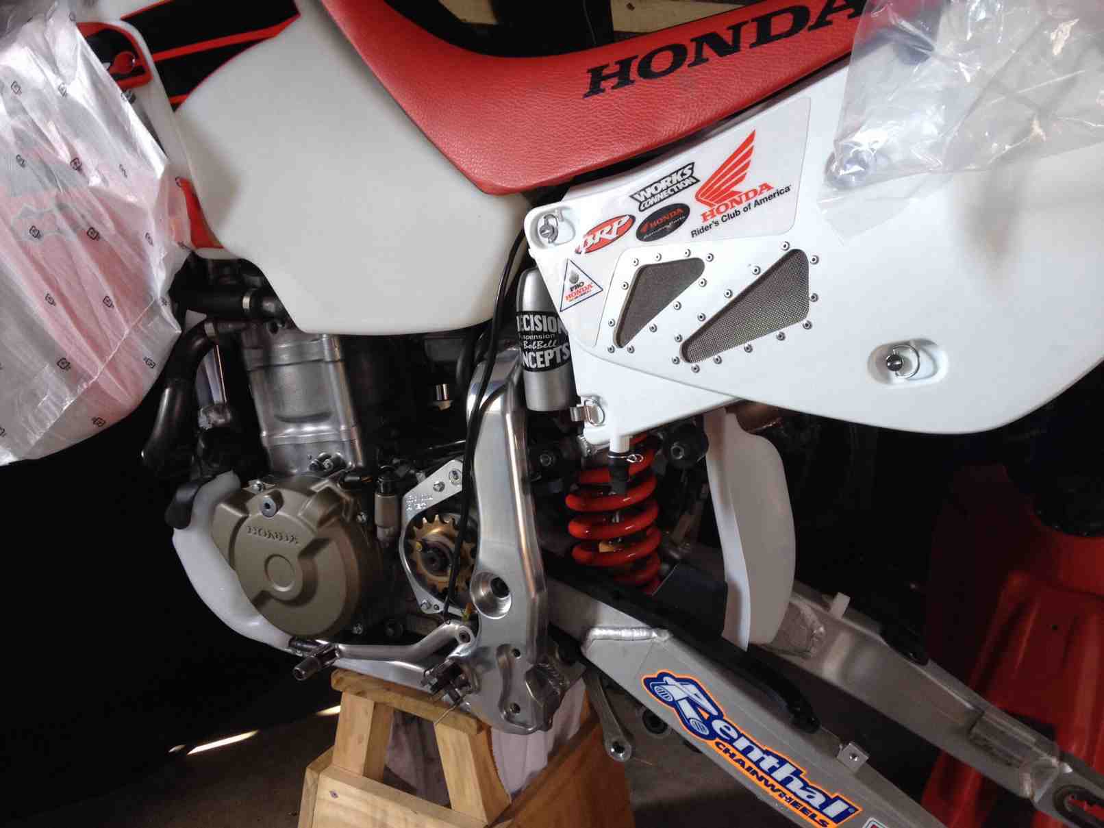

The snorkel is usually on top of the air box, under the seat, and usually made from rubber like the boots between the air box and carbs. Just removing it usually provides a much more freely flowing pathway to the carbs if your filter is up to the task. The XR650 supermoto guys are doing this(refer to pic) to get more flow into the box. There's a kit that provides templates and screen material but pulling the snorkel achieves the same goal if you have one to remove.
