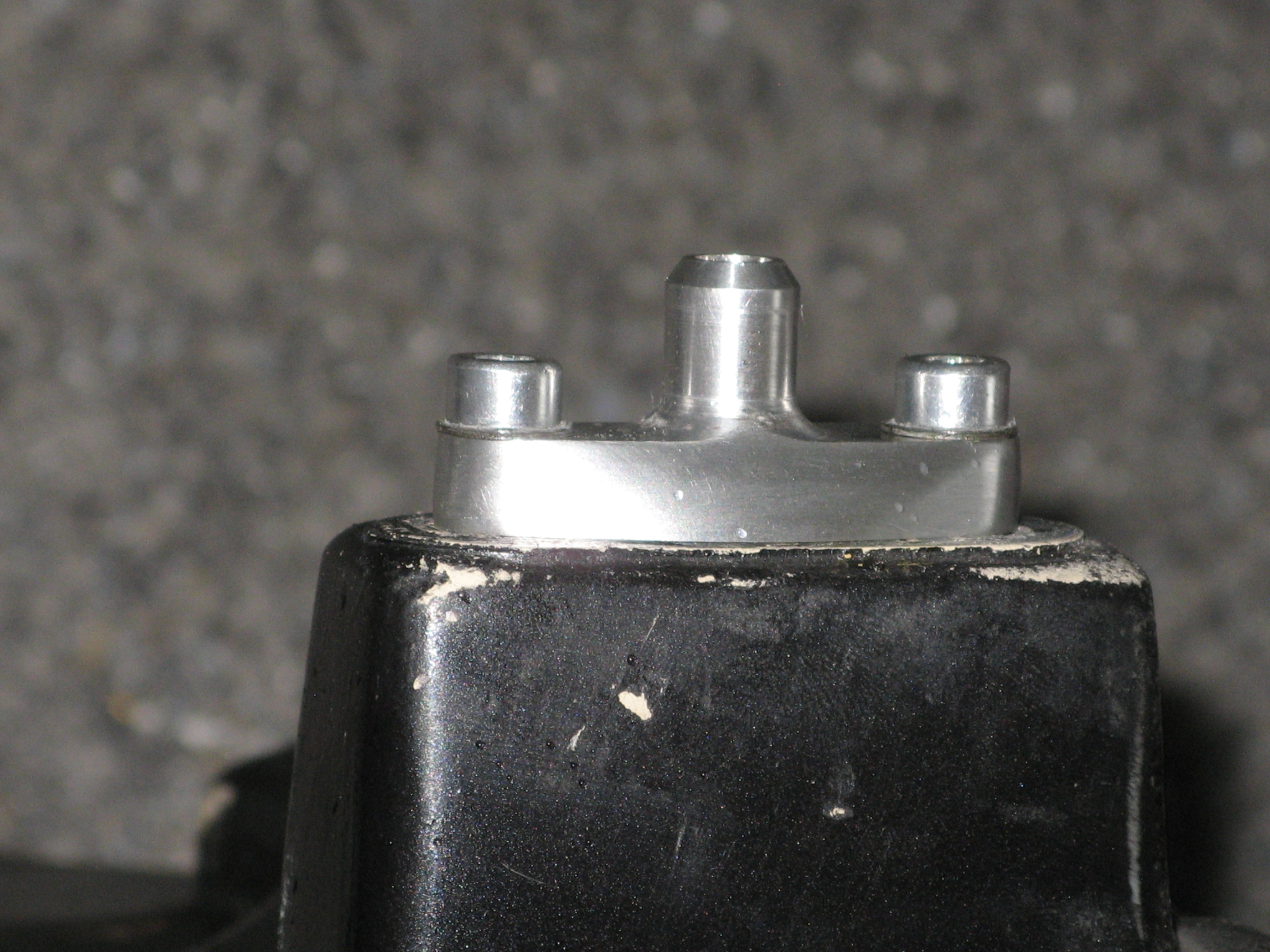

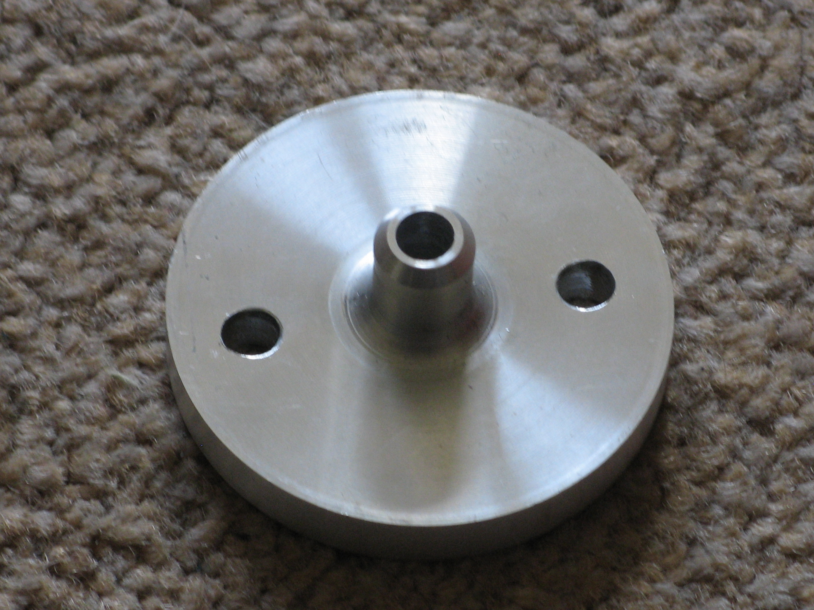

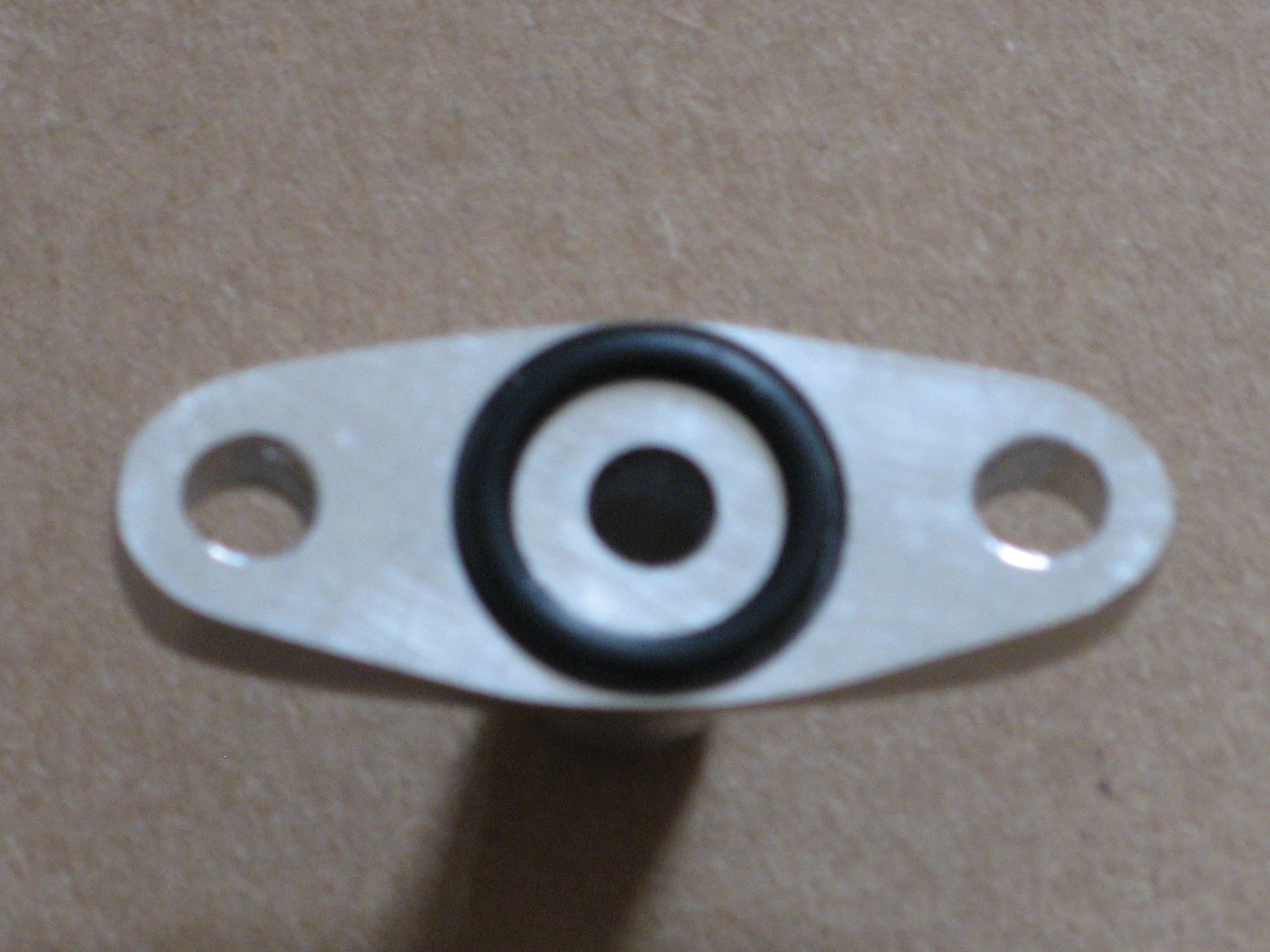

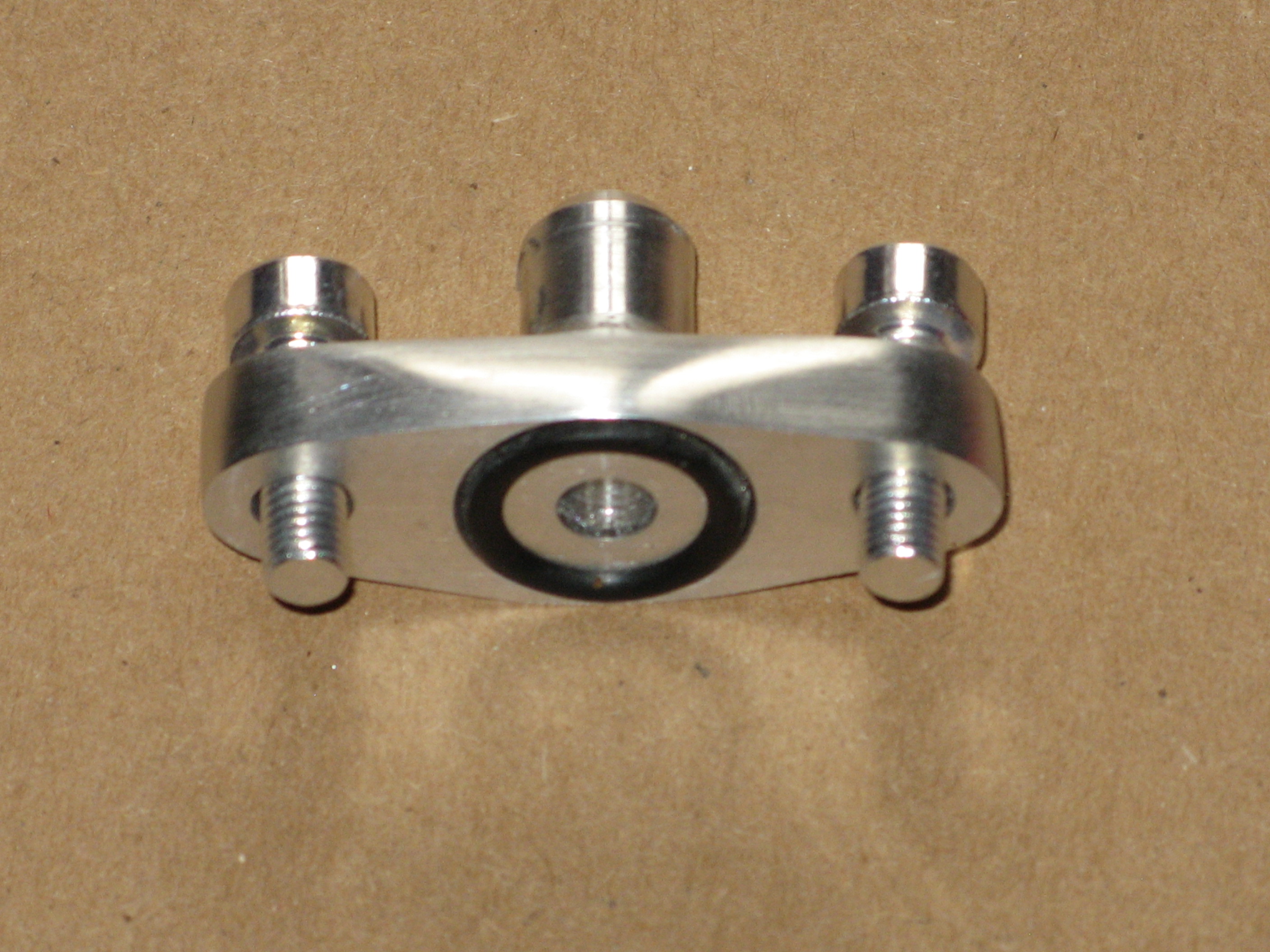

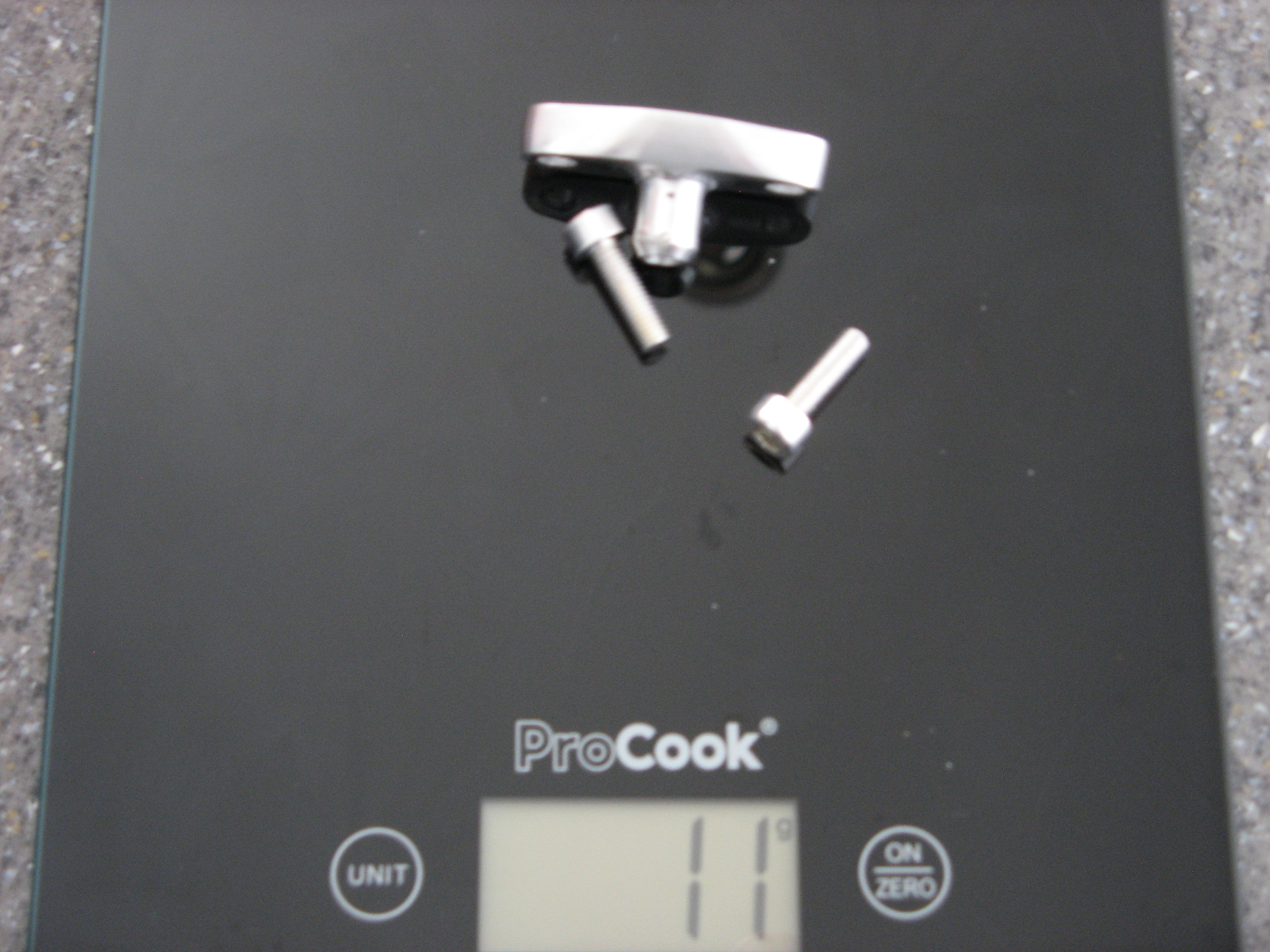

Being thoroughly fed up with having to remove the standard Skorpion fuel tap each time the fuel tank had to be removed, I made up a straightforward fitting to replace it.
I turned a piece of 2 inch 7075 Aluminium round bar in the lathe and then drilled the mounting holes.
Finished off by shaping using hand tools.

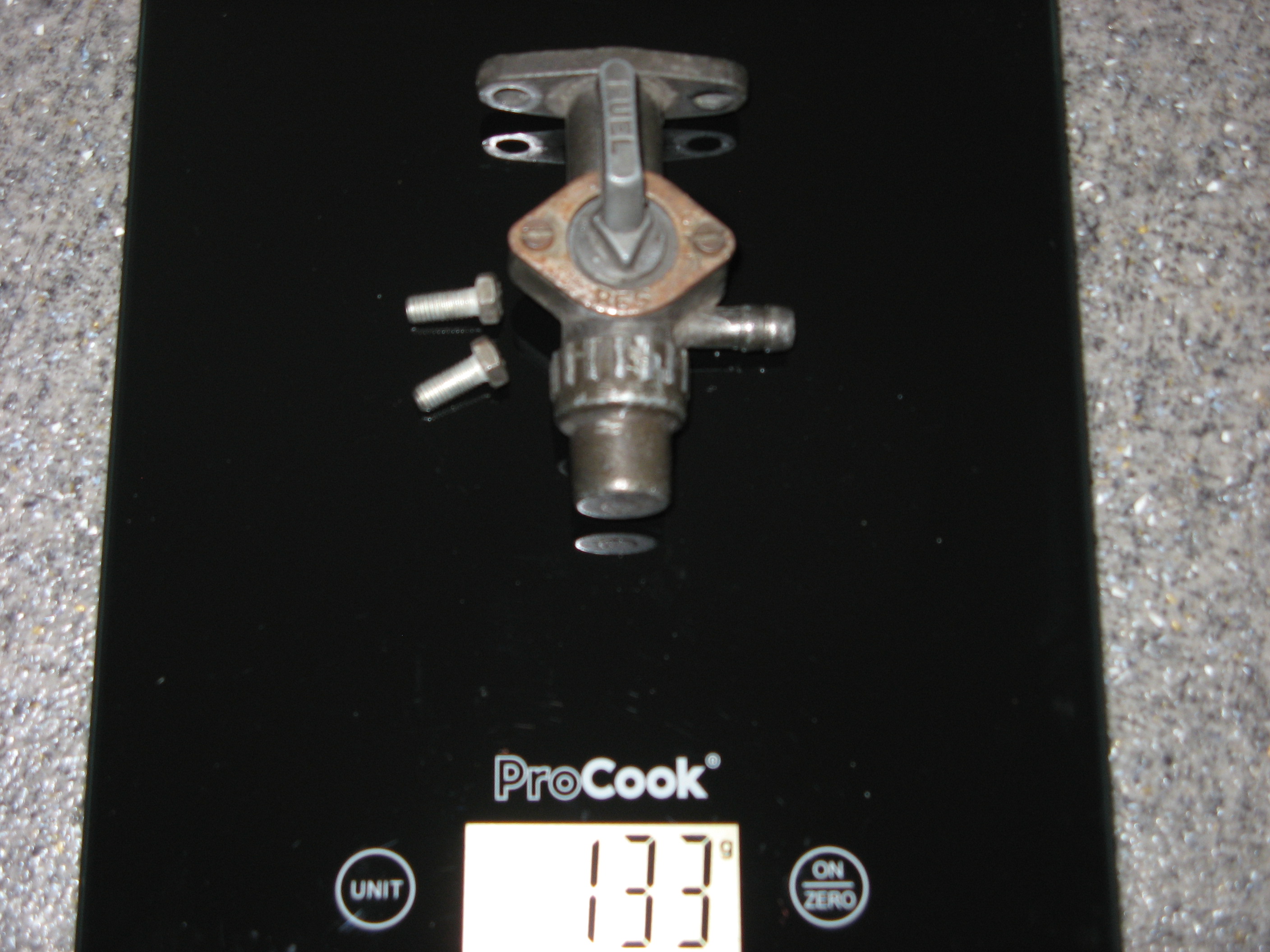

It was quite a bit lighter than I anticipated, which was a bonus.
Compared to the original tap
Mark.

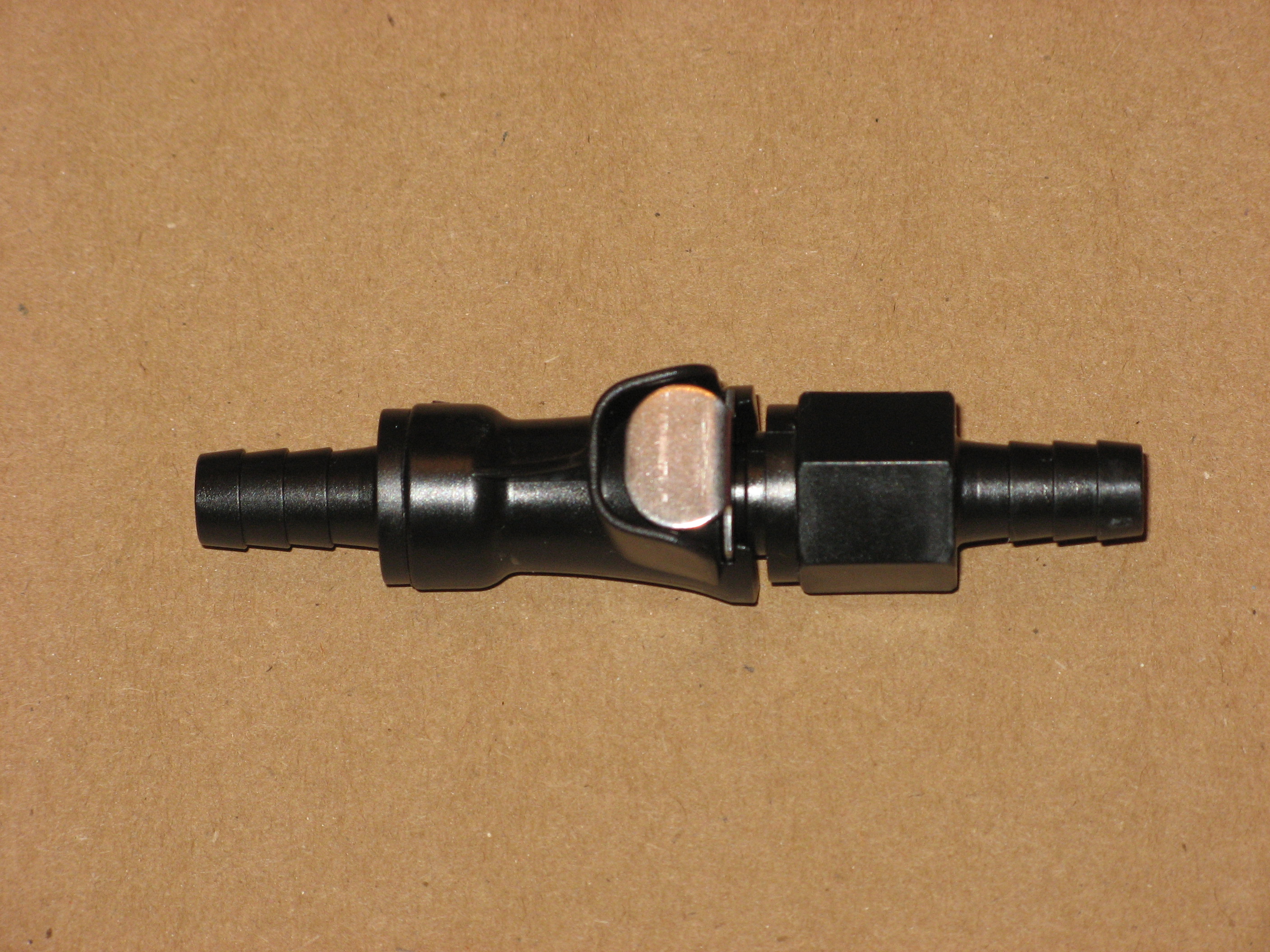

Of course the above is now used in conjunction with a quick release coupling which weighs just 15 grams. All in all a worthwhile little job that should maintenance tasks just a bit less of a faff.
Fitted to tank.

Postby sanddune51 » Wed May 03, 2017 12:25 pm
Thanks Mate. The fuel coupling was purchased from Kayla at Projection components.
They seem to be widely available on the internet.
