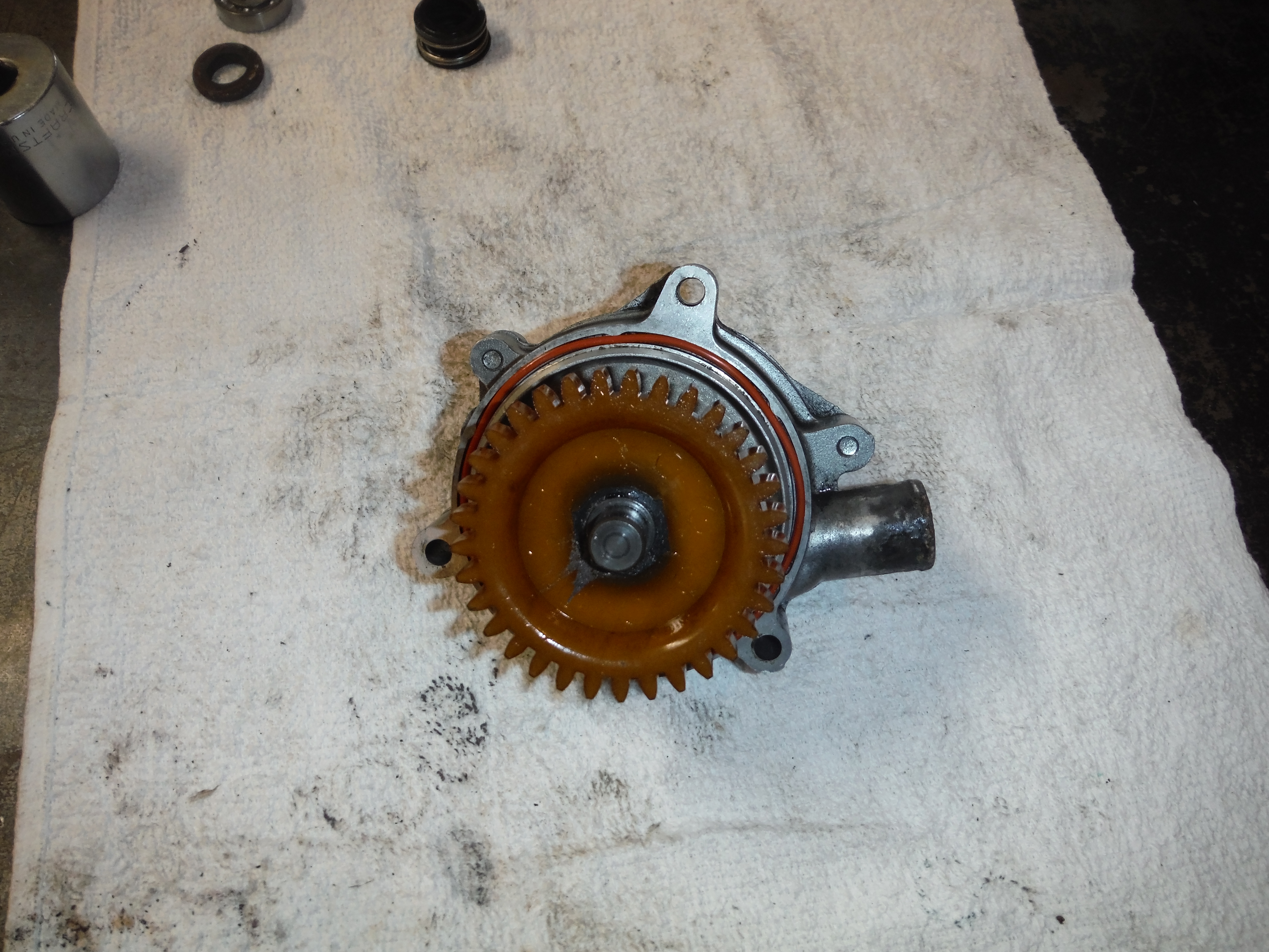

I cant get pump to stop leaking out the vent. Using a Raptor 660 pump repair kit. ??

Sounds logical but I don't know for sure if there are any differences in the water pump area. Can you compare the Raptor 660 rebuild kit to the one in the link I provided? If they look the same, you are probably headed in the right direction. The site in the link also sells a great kit for the carb on our bikes. It improves throttle response and overall flow through the CV carb. But don't use their jetting recommendations.
Re: Water pump wanted.
Postby chief » Sun Apr 09, 2017 8:08 am
The kit's do look identical. I have another kit on the way.

The raptor pump which looks identical. The clocking is just off by about 2mm. That cost me 35 bucks. I will keep looking. Trying to find SZR pump ? Thanks for imput.

what do you mean by the The clocking is off

All the bolt holes on housing to case line up except one is off by about 2mm.

try rotating it and see if there is any where it lines up
and the pump fits
may be something in the case that required them to make one a bit off instead of equal spacing
so they could drill the hole and not have the bolt cause a problem
or on purpose to keep some one from putting the pump in the wrong engine

My friends I picked up an OEM Yamaha water pump kit and pump is now working and not leaking. The only difference I could see with the kit is that the rubber gasket that houses the porcelain washer that sits in the impeller is of better quality. Again thanks for imput. I would like to know if the SZR pump would fit the MZ ?
