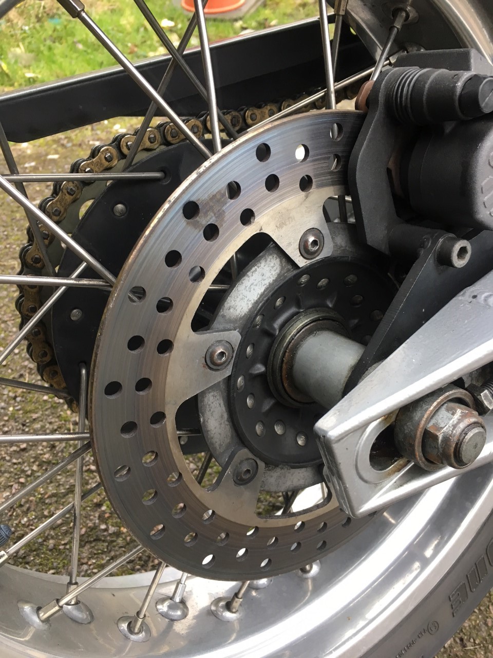

hi all , i got an issue with the rear rotor/disk on my baggy.When ive finished my run i notice the disk/rotor is blue and very hot,,ive checked nothings binding and the foot lever has play,,i suspect its riding style,dunno,,what you guys thin.

if your wearing riding boot you may be putting the brake on
put a buzzer on the dash hook it up to brake lamp and go for a ride and see if its buzzing when your riding and not braking
i trashed a set of pads on the rt 125 when i first got it riding the brake when i did not mean tooooo
also check the leaver adjustment the lever may not be returning back far enough when you release
it and the fluid gets hot and expands and puts the brake on because excess fluid can not return to the master cylinder reservoir
