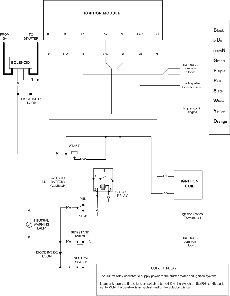

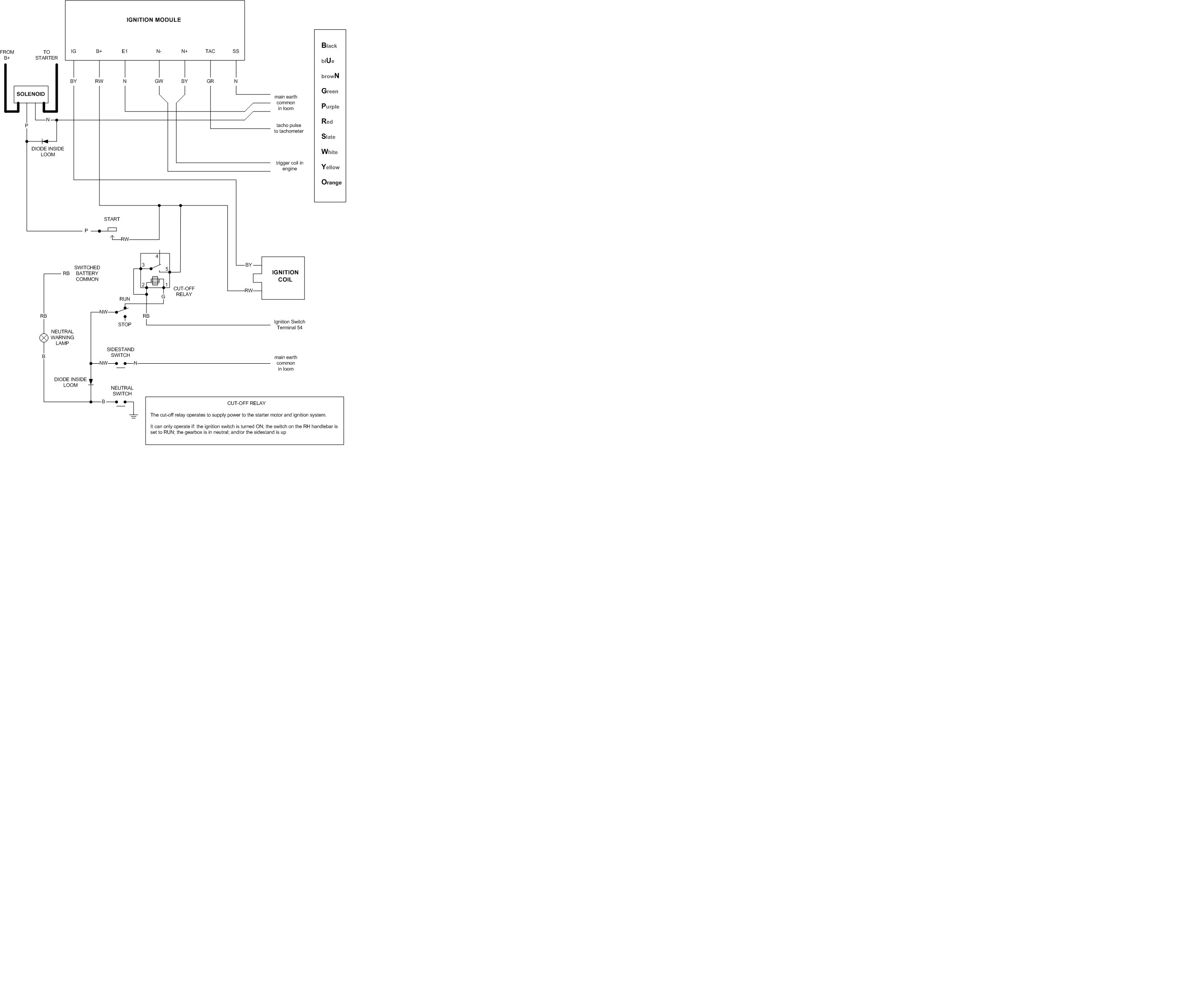

Postby DAVID THOMPSON » Sun Feb 19, 2017 10:06 pm
something is not plugged in right
there are diodes in the mz electrical system they can cause fits
attached file may help
look here
viewtopic.php?f=3&t=8464&p=44419&hilit=tony+idle#p44419
file is part of this post
click on it to make it bigger
and save the whole post an put a copy in your shop manual
the 660 bikes have an electric system you can learn to hate
lot of this also is relavent to the 125 bikes as well
:smt006
print below attachments for your shop manual i email this info out more than any other files
print them soon when you really need them your printer will be broken or out of paper and ink :smt023
