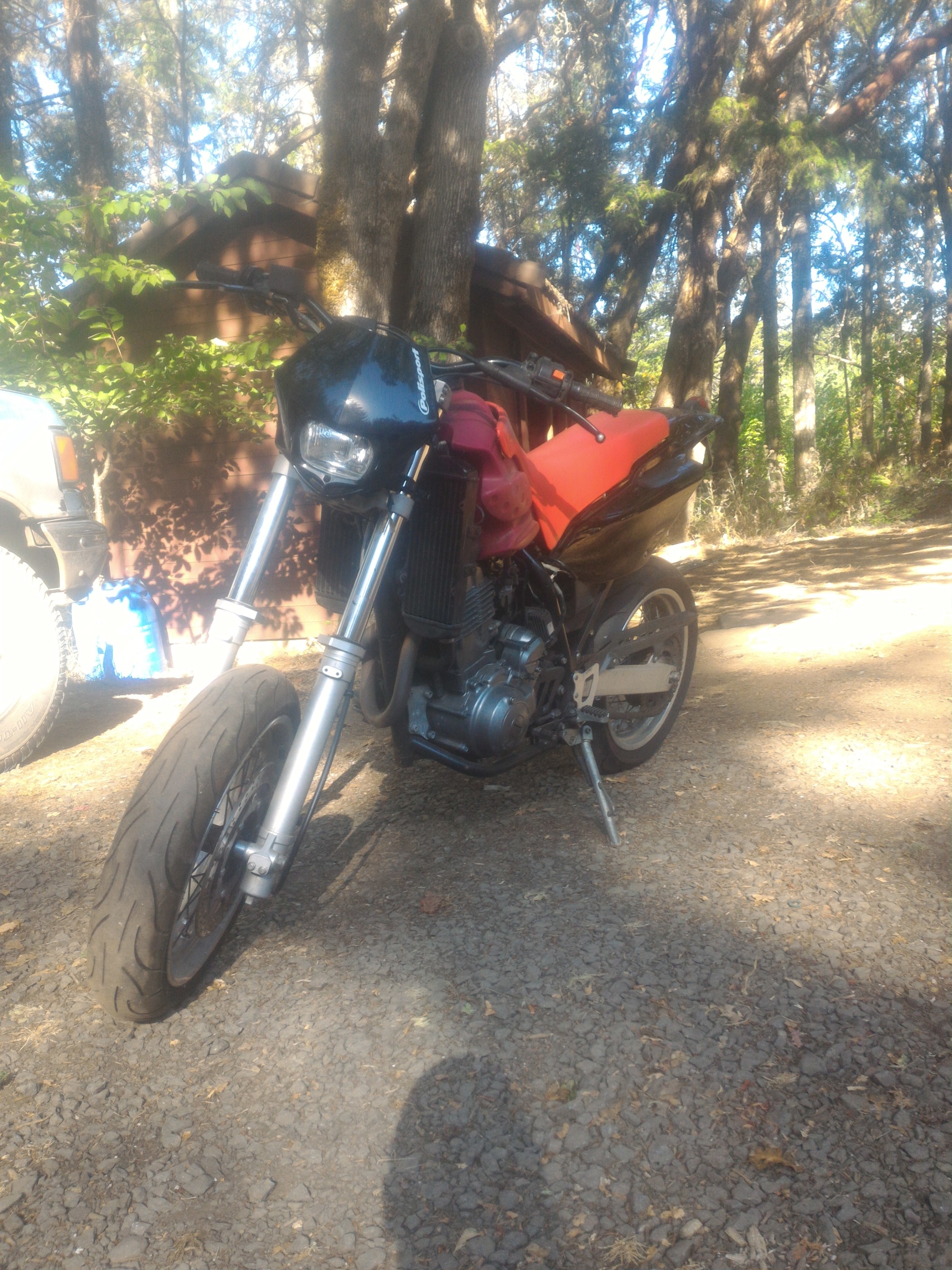

First post here, but I just purchased a '98 mastiff for 1200$ with a supposedly bad starter solenoid and starter clutch. Turns out it was just one wire on the wrong prong on the run switch relay. Easy cheap fix there.
Then its running but only runs well above 4000 rpms with 1/2 to full throttle. If I try to let it idle, then it pops in the intake and dies.
So I rebuilt the carbs, adjusted float height, adjusted valve clearances (waayy to tight, negative clearance...) and verified cam timing.
So im thinking this bike has stock internals, but no airbox lid and very open slipon fmf muffler. It has a #48 pilot and on the third groove on both needles.
My next thought is maybe a bent valve. I will go get a compression tester and verify compression, but this leads me to the real problem of not having any specs for anything anywhere. Does anyone have any year mastiff manual? An also where do i get parts for this thing?
Photo attached to show what im working with.

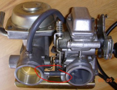

Postby roachdogg28 » Tue Aug 30, 2016 10:40 am
:cry: So the diaphragm looks in great condition. no holes.
Anyone have any other ideas, things to check? This intake pop is not a big backfire, just a little poof i can hear then it dies. Seems to get worse as the engine warms and will only start on full choke.
So i started spraying carb cleaner everywhere to check for intake leaks, and sure enough the idle clean up and motor revs up a little when spraying near the top of the primary carb. Im not sure where in the hell i could be leaking from, but I think this is my problem.

Re: New 1998 Mastiff... Already need help.
Postby roachdogg28 » Tue Aug 30, 2016 11:07 am
Found it.
This is why some ppl should just take it to the dealer. Prev owner missed putting this little guy back on.

Postby MZ in Oz » Tue Aug 30, 2016 3:05 pm
That would be a problem. Hope it settles the running, a little more back pressure exhaust will help.
These motors don't really like an open pipe for running around the streets. Racing different matter.

Postby DAVID THOMPSON » Tue Aug 30, 2016 4:07 pm
good one to check if it has set for a while rotten rubber tubing lurks every where
