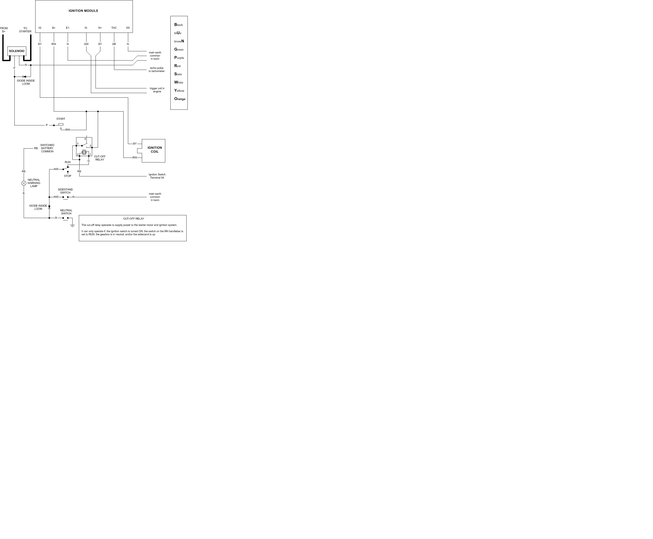

Postby DAVID THOMPSON » Mon Jul 11, 2016 6:02 pm
the side stand switch controls the main relay 19 0n the 125cc bikes and relay 30 on 660 engine bikes
the oem relay is too small and it carries all the power for the whole bike except main power for starting
see this drawing Thanks to tony idle
click on it a couple time to make it bigger PRINT A COPY FOR THE WORK SHOP INFO WALL
print this and nail it on the shop wall

Postby Muzzyrider » Wed Jul 20, 2016 5:16 am
If the relay is too small then should it be changed for a bigger capacity one?
Niall
Muzzyrider
Posts: 2
Joined: Wed Jul 20, 2016 4:45 am
Re: transmission kill sensor??
Postby DAVID THOMPSON » Wed Jul 20, 2016 11:27 pm
this relay can be replaced with one from a car parts store
but all the associated diodes and switches need to be in working order
this relay is a major cause of many people hauling a bike home
good luck fo
