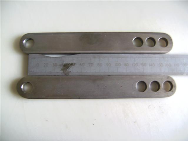

Postby breakwellmz » Thu Jul 07, 2016 10:37 am
Some i made earlier.
5mm x 25mm stainless steel (OTT!), holes are 12mm.

Making my own has to be an option. The ones you illustrated have centres at about 125, 140 and 155mm. Having a choice seems very sensible, what effect in terms of lowering did you get with each of these settings? According to Graham's in Taunton, who have been very obliging, a 10mm extension gives about 40mm of lowering so I was aiming for a hole centre of around 130mm which should give me around 45mm. Best i have found on Ebay so far is 145mm which is likely to be too much. Don't suppose you made a spare set?

It was years ago i made these.The seat was re-shaped to give it a flatter profile at the same time, which actually raised my seat height.(I didn`t like the dip behind the fuel tank)
Could you get a local engineering firm to make you ones with the hole centres you want? Using something like 1"x1/8" (or 3/16") steel strip would make it a very cheap job.They don`t need to be a fancy shape.

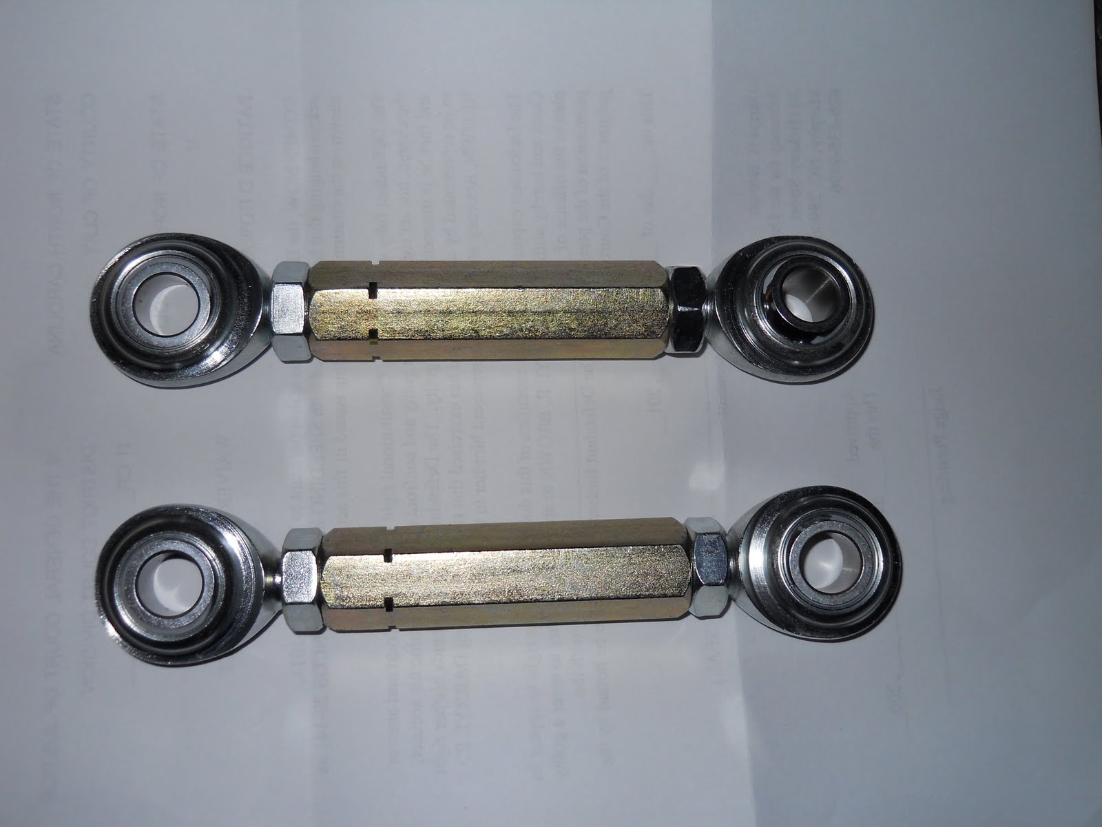

so make some fully adjustable with rose joints,like used in track rod ends
