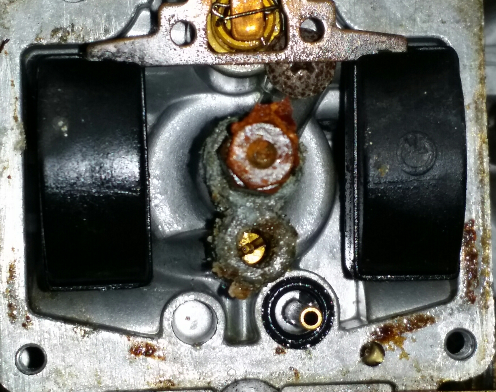

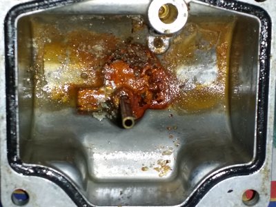

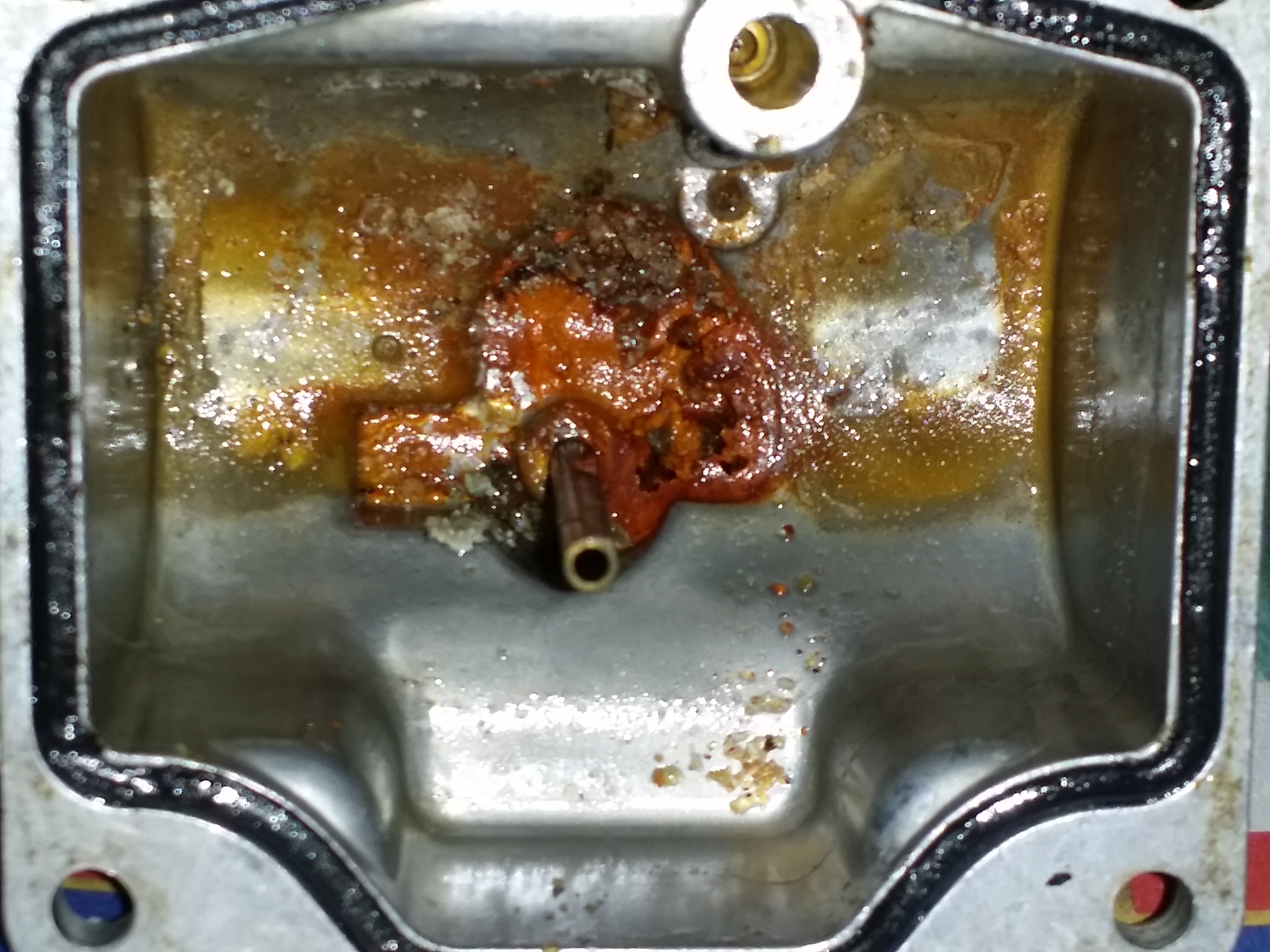

Postby dearden05 » Tue Apr 26, 2016 11:26 pm
So, with the fuel turned off, and no stabilizer added, the carbs got nasty in a year and a half, but the fuel in the tank was still useable(I know, I know). With the choke issue resolved, all she needed was a second carb cleaning(the first one being done by me when I first aquired the bike). After the carb was cleaned, I fired it it up and rode it for the first time. I was elated! Will wait to fine tune until a fresh tank is filled up, VERY SOON. Now, I need to replace a headlight bulb, replace front fork seals, clean fork oil off of my front brakes, clean her for the first time since I don't know when, shop for a front tire, test fit my travel gear, figure out why she doesn't like to go from 2nd to 1st, figure out why the Neutral indicator doesn't light, figure out why the rear brake is soft, and get the registration finalized.
