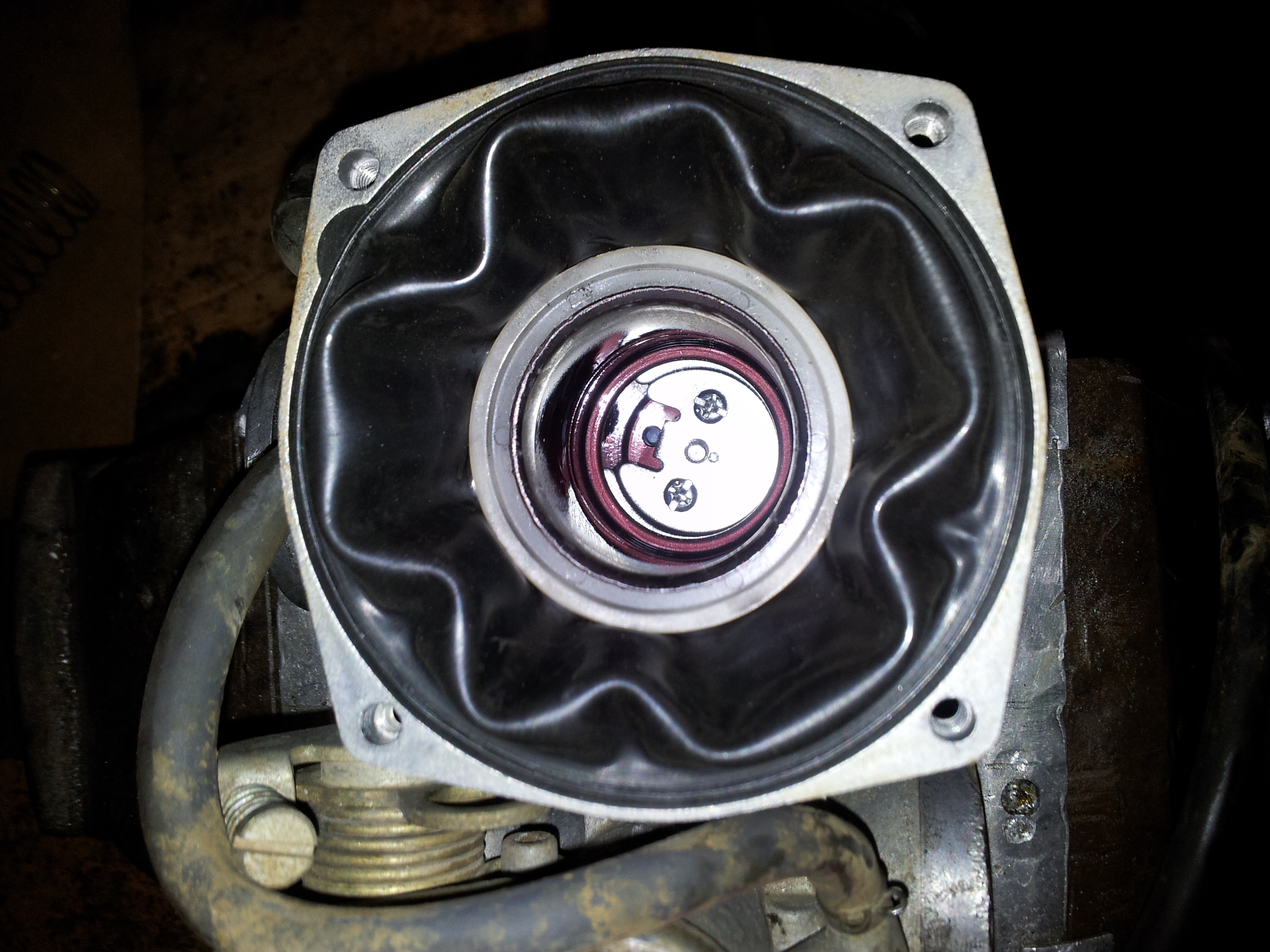

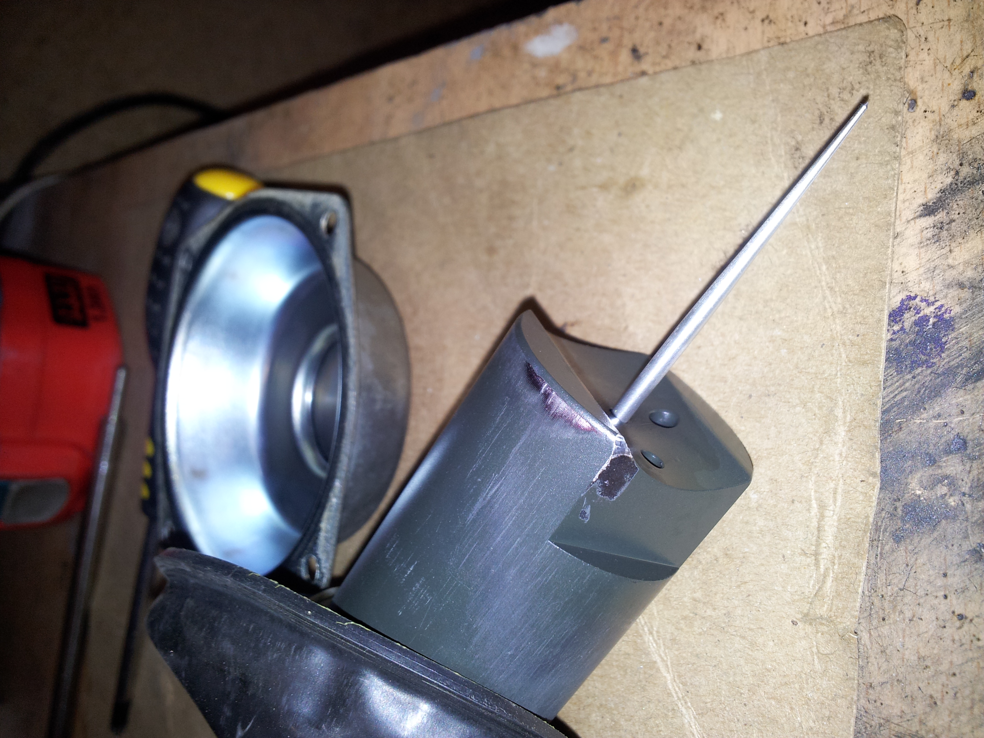

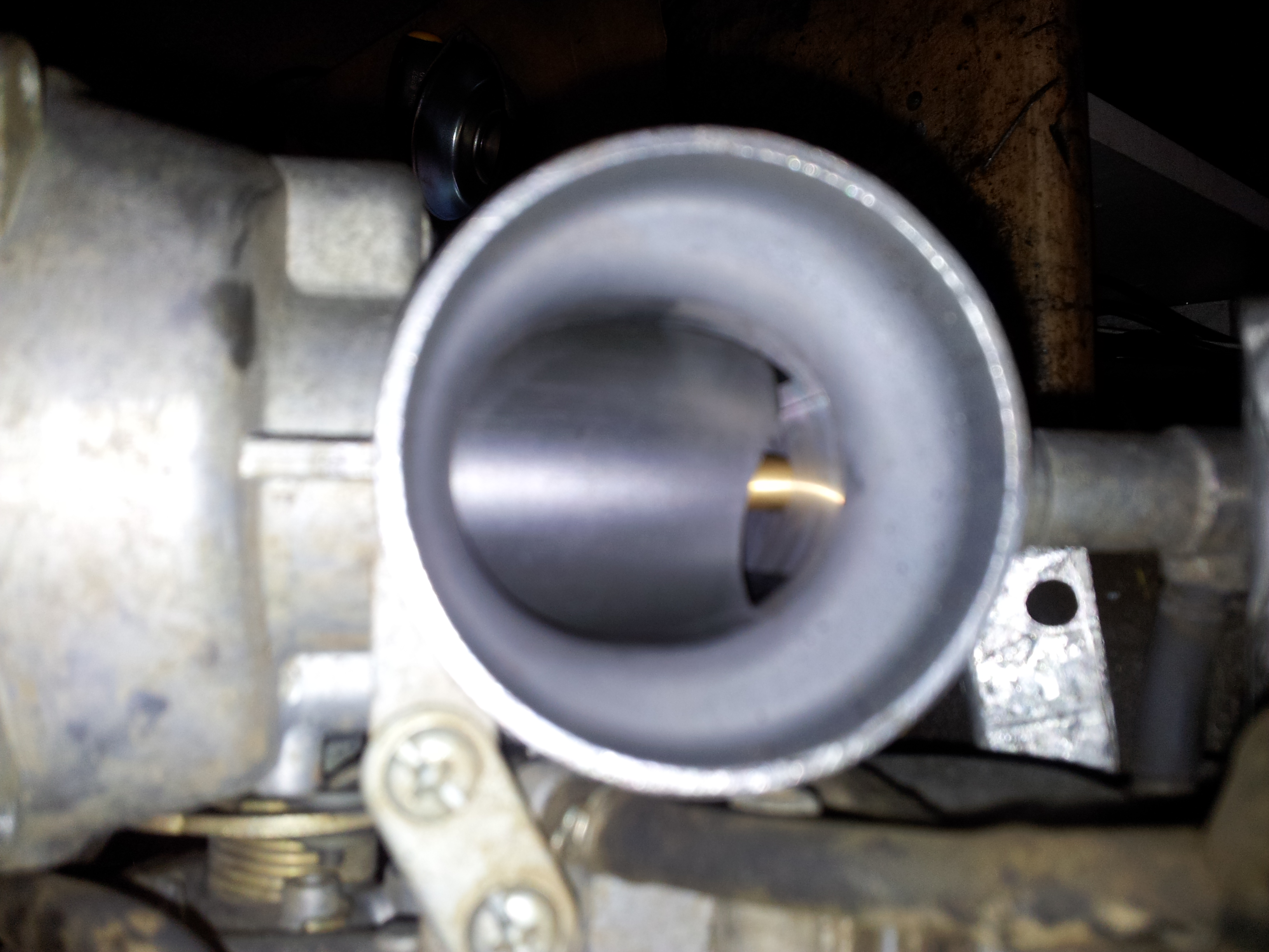

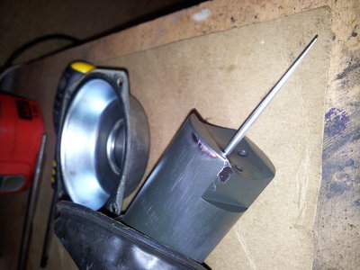

hi,have givern my baghira a service today,valves,oil and filter etc and decided to give the carbs a clean as had trouble starting from cold lately,anyway found the slide on the cv carb has twisted slightly, so removed diaphram and was able to twist it slightly to re-align slide with the diaphram,before i put the carbs back in is there any further adjustment/settings i should do whilst there on bench,there seems to be a lot of movement on the first carb before the cv starts to operate,is this normal,thanks in advance,rodge
i have owned bike from new and this is first time the carbs have been off so no idea how long slide has been like this but it has wear marks on the slide where it has been on the piss,2008 model with about 16000mls.

pics of the offending item and thanks for the tips and advice

cheers everyone,did a strip and clean of jets and carb body,sorted the valve throttle opening settings with a drill bit,carbs back in place now, refit radiators,add coolant and put bike back together then good to go.
well bike starts mega quick now and very smooth on acceleration,not sure if its the valve clearances or the dodgey throttle valve that was the cause but the end result is great,and on choke the bike now has a higher smoother rpm where as before it was a very erratic lumpy tick over that would often kill the engine
