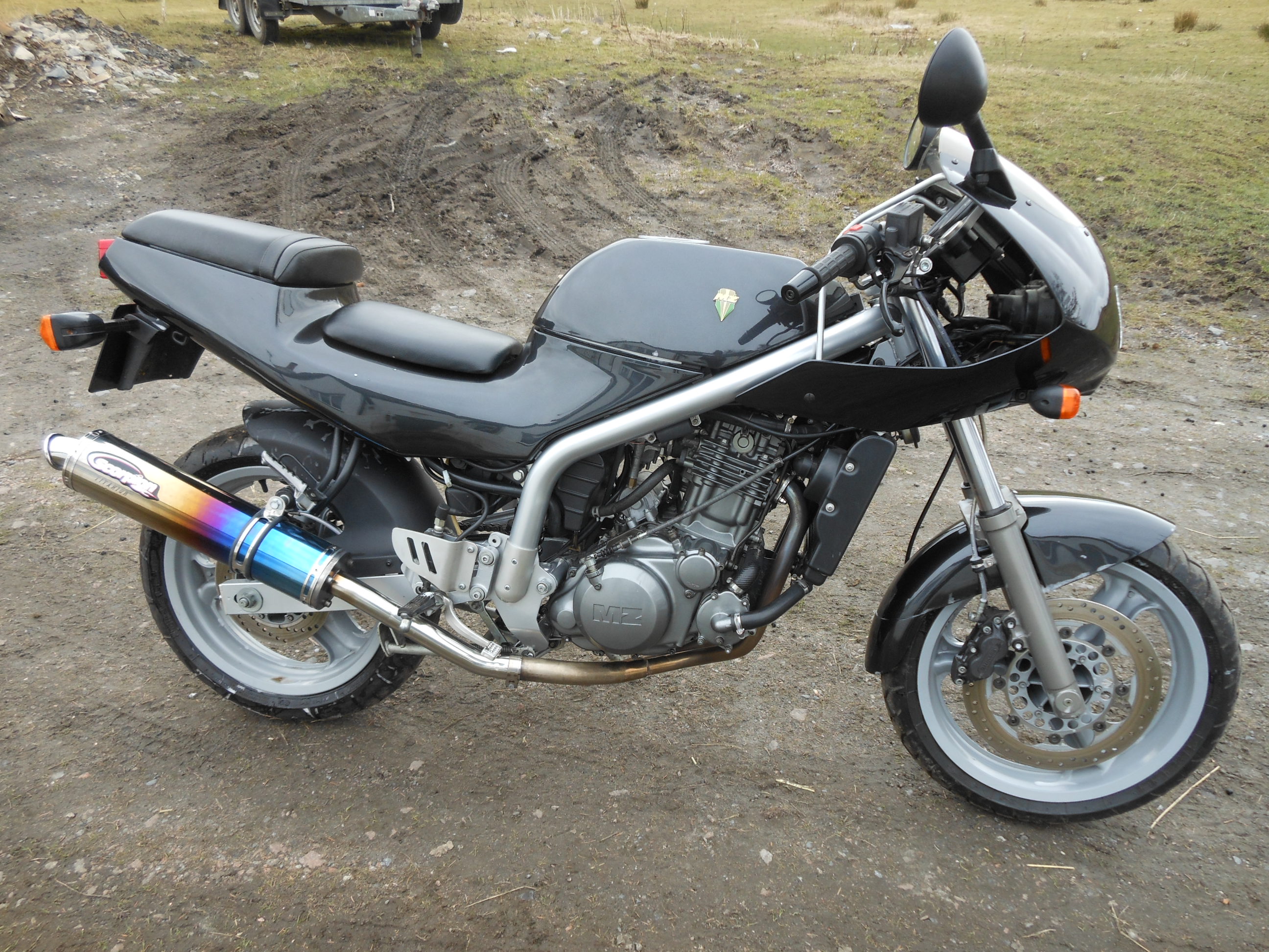

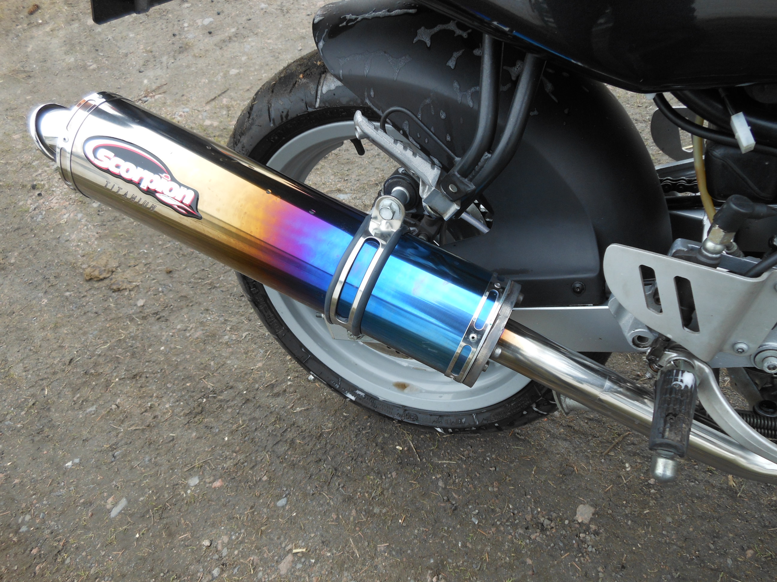

Just recently, I have been getting the Skorp ready for summer and wanted to make it sound more like a big single without being too loud. Fitted this Scorpion titanium end can with a home made link pipe. The flange was laser cut from 10mm stainless, silver soldered inside to the pipe and the link pipe was made to replicate the original length of the exhaust to its outlet.

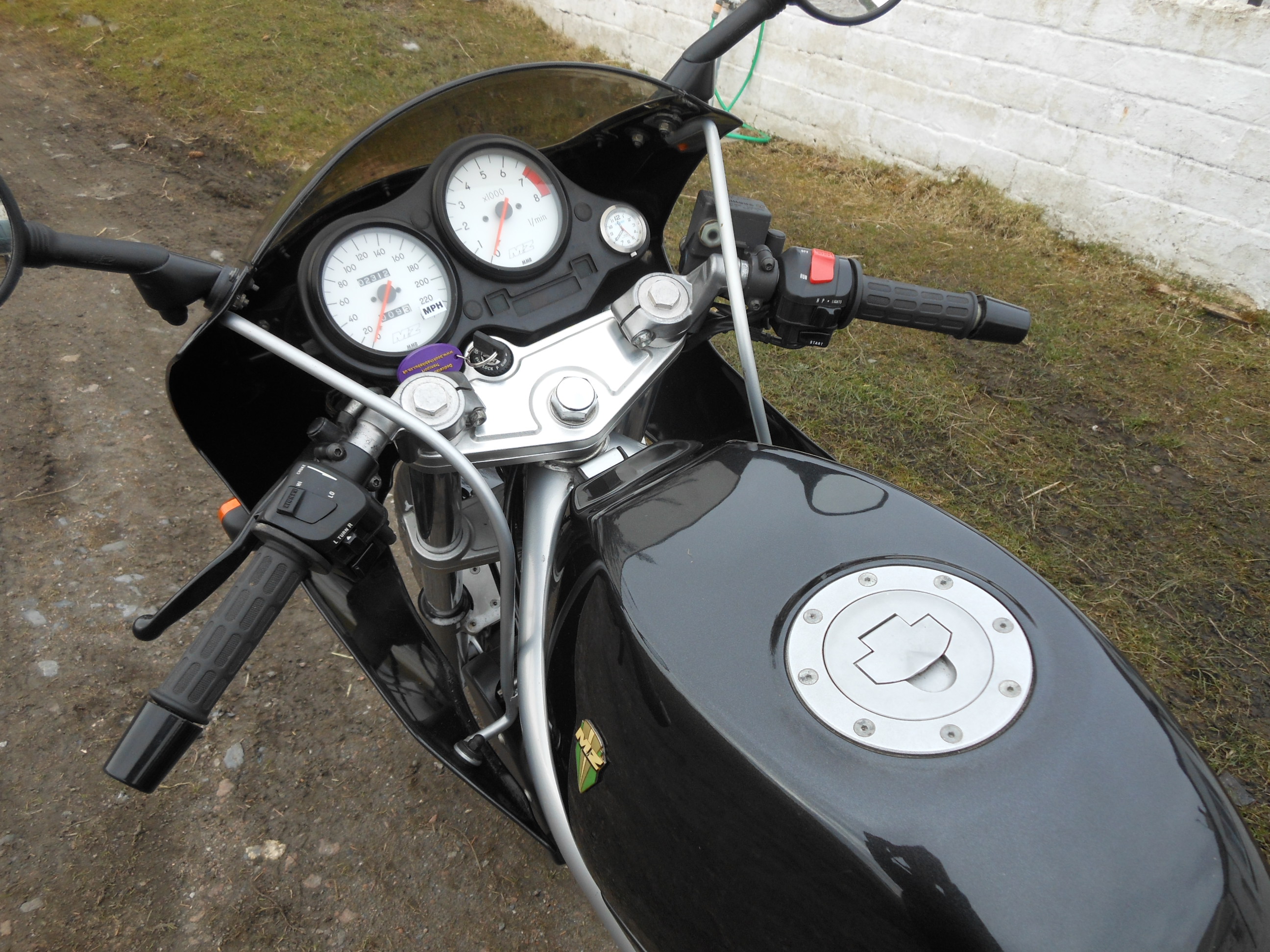

Fitted a pair of VFR750 handlebars which fitted being 41mm diameter , but the choke needed to be resited to the carb using the XT600 unit previously covered on here.
It seems to run better, revving cleaner and idling better, I wound the mixture screw out to 7 turns.......quiet pleased now, all we need is a good spring to ride it a lot :D
