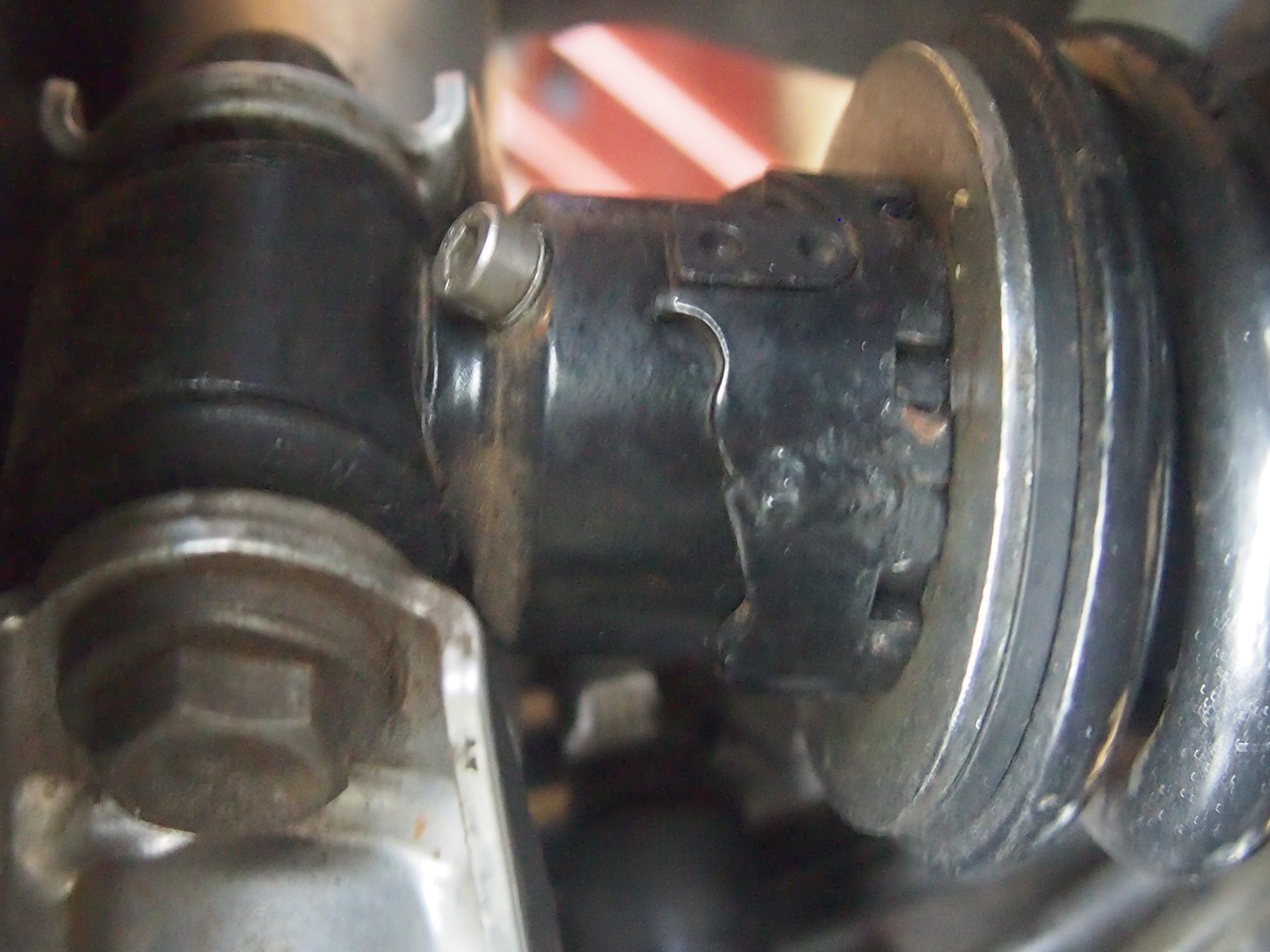

rebuilt shock
timston wrote:
It would appear that rebuilding the original shock is not possible. I can't see any way of dismantling it and my local suspension specialist wouldn't touch it.
here's a photo of the top of the original shock I had rebuilt, totally rebuilt - to be rebuildable, it can be done to virtually any shock, SOS suspension in Penrith (AUS) did this work http://www.sossuspension.com.au/, The socket head cap you can see is to recharge the gas. maybe your local suspension specialist isn't really that good?

crunchybits4 wrote:The socket head cap you can see is to recharge the gas. maybe your local suspension specialist isn't really that good?
It's been ~18 years since I put food on the table by tuning motorcycle suspension, but emulsion-type shocks don't have a "gas charge" as in a pressurized system. The hole is simply to remove the old oil and replace it with fresh, the screw simply seals up the hole.
Oops, remembering wrong (and found the Race-Tech page on rebuilding non-rebuildable shocks here ~ http://www.racetech.com/page/title/SPNV%20Installation ), so apparently there IS some pressure which means the OEM units were assembled in a pressurized environment. Not sure how the shop would pressurize the shock crunchybits4 has (and I never personally did this, I was working on aftermarket units from Fox, Ohlins and Penske mostly).

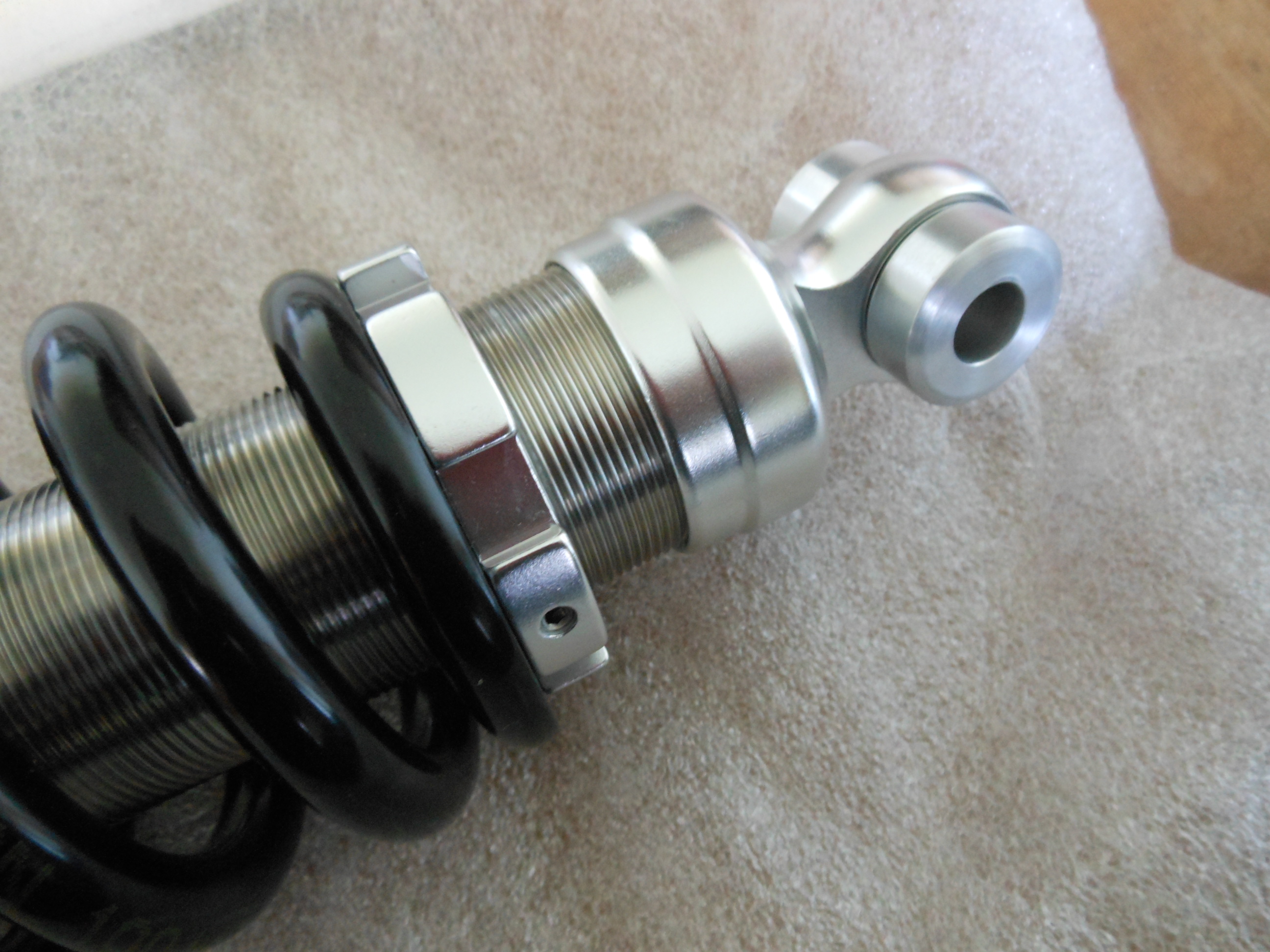

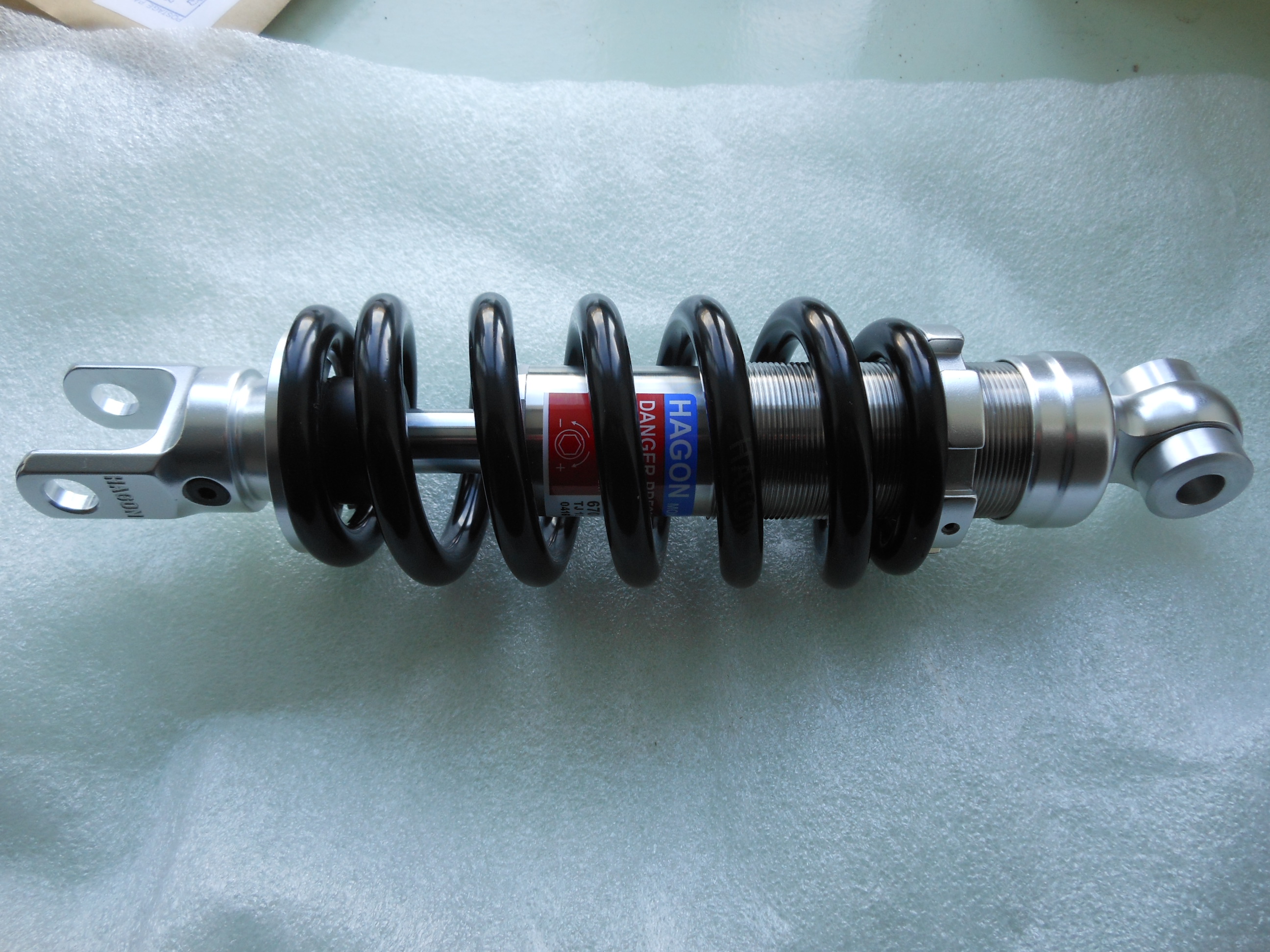

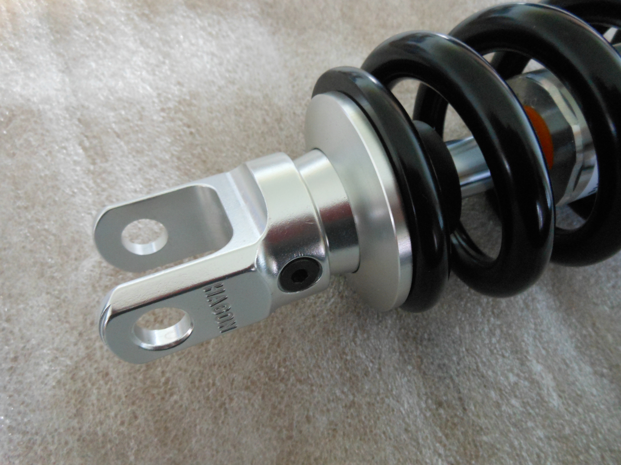

Postby Petrolhead » Wed May 04, 2016 1:42 pm
Fitted this Hagon shock to my Sport , its got variable damping with automatic rebound and compression balance and it is nicely made. After a short trip on a bumpy B road, it seems to have lots of travel, damps well and offers a controlled ride with no trace of bounce or harshness. Hagon build them to suit rider weight at no extra cost, I had mine built for solo riding with a lighter spring which gives me a bigger window of adjustment. Shame about the front end now, as it shows up its lack of sensitivity.
Preload at top - easily accessible
Variable damping at bottom - range set to suit the spring selected
