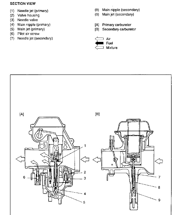

Hi Krusty, before blaming the carb for this popping and banging: check the header gaskets if they're the culprit. If there is an air leak this gives you the biggest bang for the buck as well ;-) Old reused gaskets are a no-no and new gaskets sometimes need some tightening after the first heat cycle.
About your question: 2,5 out should do with stock setup. Turning the screw out is richer, look at #6 in the drawing:
The pilot screw adjusts the amount of extra fuel mixture through it's secondary fuel orifice.
I have to admit i'm running a far from stock engine with Mikuni's and the my little Teikei knowledge from practice is fading...

by krusty
Thanks Hajok
this helps a lot! I can see now that I should be turning the screw out rather than in (like on most carbs!) to 'richen' the fuel mixture.
I definitely have no exhaust leaks... all new gaskets have been fitted when the system was installed and I have actually nipped them up since so I can verify this is not a problem :D
Like I said, I have it set back to the stock 2 and a 1/2 turns out right now so I will give it a run in a second before it goes dark with my little mixture screwdriver haha and if its popping still then I will pull over and turn it out 1/2 a turn and so on until it is the best it can be.
