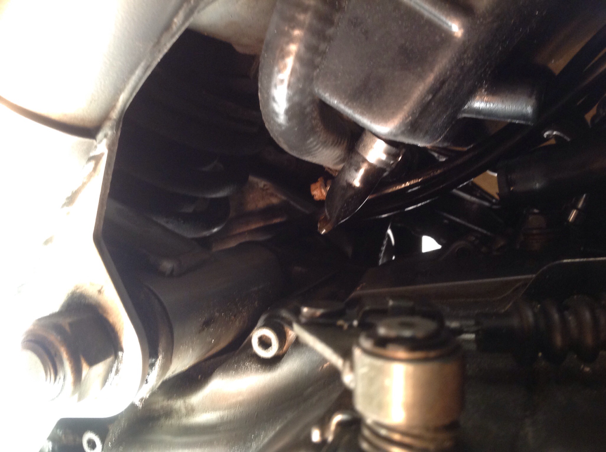

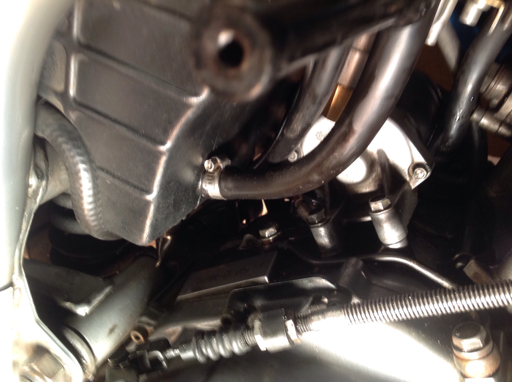

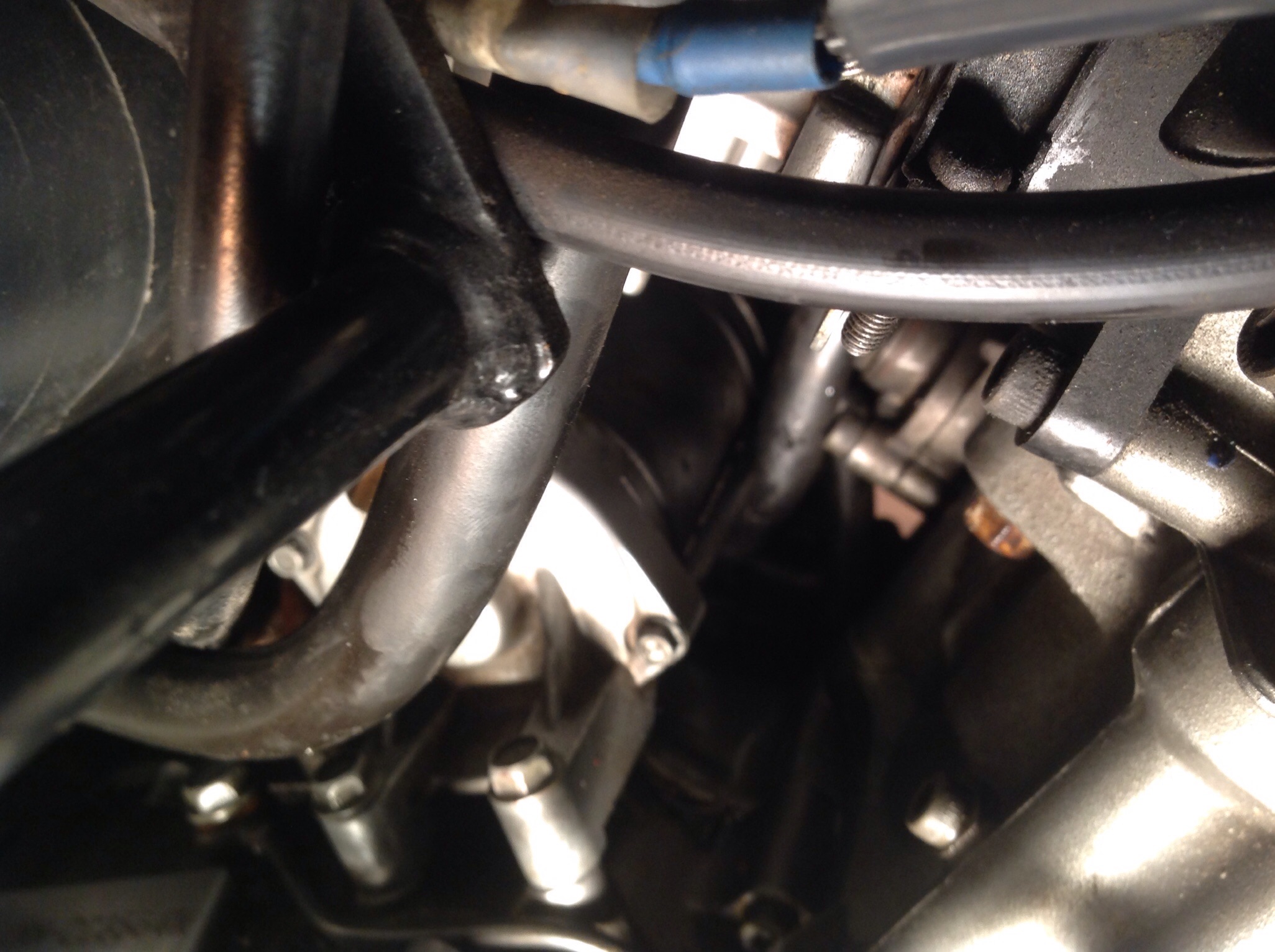

Postby Blind bob » Thu Jan 14, 2016 12:28 pm
Hi edfmaniac. Thanks for the reply. Not had chance to remove tank yet, but pictures of pipe to bottom of airbox. Until remove tank can't really tell if it is the same pipe as comes from vent in front of starter. If so it must pass right over the top of the engine. Is this correct. There is also a blanked of inlet right on the bottom of the airbox, not sure what this does or did. Bob

Postby KevinLS » Thu Jan 14, 2016 1:47 pm
The breather hose does indeed go right over the engine. It has an internal spring reinforcement to help prevent it collapsing in the heat up there. The connection to the bottom of the airbox looks right in your photo. I doubt that a blockage in this breather would pressurise the system enough to blow the blanking plug out unless there was something causing a lot of blow-by. Sorry that isn't very helpful, I'll take a look at mine later tonight to see if I an come up with anything else.
