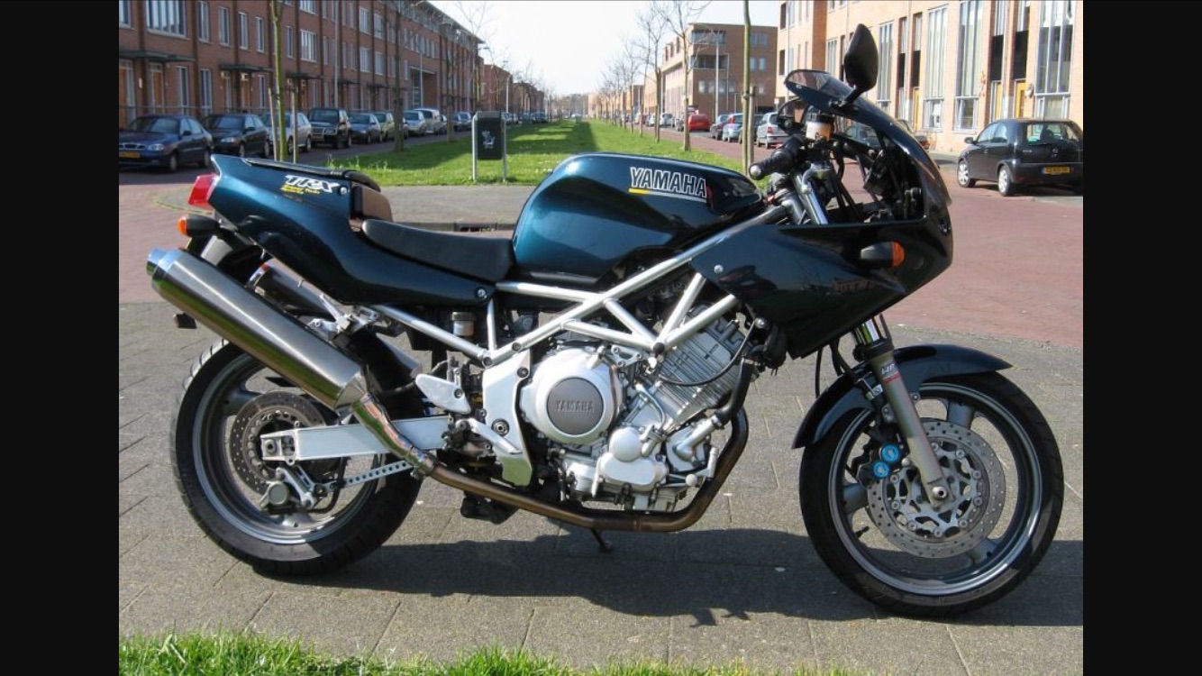

A common mod is the Yamaha trx850 light as it fits straight in. See if that's any good?

The trx also ran in Europe so if one was bought then buy it from maybe Germany.

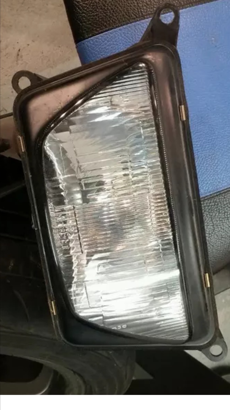

Picture two is Skorpion sport (and also Yamaha fzr400 I think)

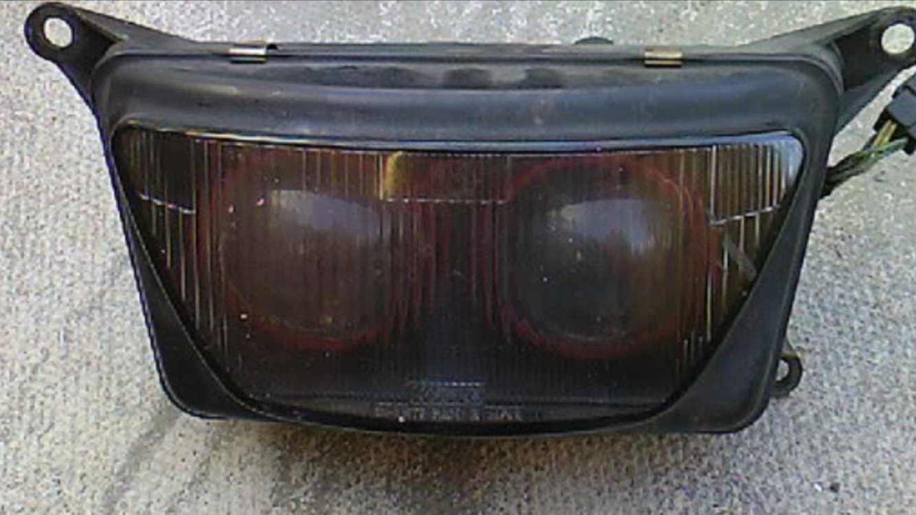

Picture three is trx850. Bolts straight in!

I did the swap and the improvement isnt huge to be honest.
Not a great bike to ride at night, my old ETZ is much better.

Its more down to a poor pattern on the ex TRX headlight than power. If it went to the right places it would be better.

My trx850 light was shite , I have fitted a 90/130 watt bulb it's now ok it's better than my etz headlight so fitt a better bulb.

Well the bike went in for MOT and the light spread was so awful it failed.
I have put in another TRX headlight i had to hand and it was much better in terms of its pattern. I suspect the old one had a problem.
For my next trick i shall put t in a relay and more powerful bulb. It will need a relay as when i put a similar bulb in my /7 BMW. It damaged the wiring.
