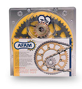

does any one know How many teeth are on the front and back sproket. Also where is the best place to get a new sproket set one, two or three teeth less. also what the best chain By the way I have a baggie 660

AFAM makes the sprockets that fit the baggy. any front for a 90-95 yamaha XT600 will work. stock is 15t, they have 14,15,16. I just ordered 14t front. I dont know off hand what rear is. 3t in rear=1t in front. 16t front is a very tight fit, and the largest you can use. all high quality chains are good. I like the Renthal, or the new Xring from d.i.d I think. they claim less rolling resistance, but better sealing.

15teeth front 45teeth rear and 108 links from AFAM $184.95 what do you think

Postby phlat65 » Wed Mar 10, 2004 10:18 pm
15-45 is probably a good combo. stock is 15-43, will give you a bit more tourque, and you shouldn't gain too many rpm's on the freeway.
I am gonna try the 14t front (same as 15-46) because it will only cost me $20.00.
BTW, checked my sprocket bolts today, and they were all 3 or 4 turns loose. Check them all the time!
