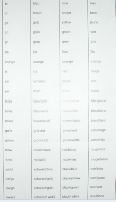

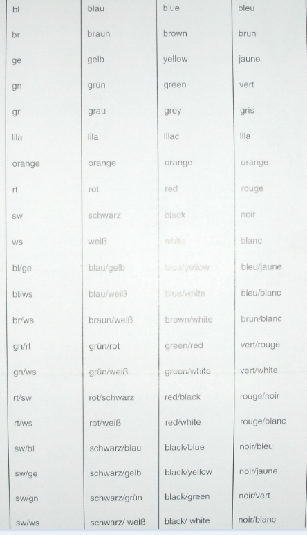

This seems like a good time to ask about the colour abbreviations in the wiring diagrams. I couldn't work it out. Guessing they're German abbreviations.......? I gave up very quickly because my wiring was messed with in the past!

Here's the translation part of the factory wiring diagram.
