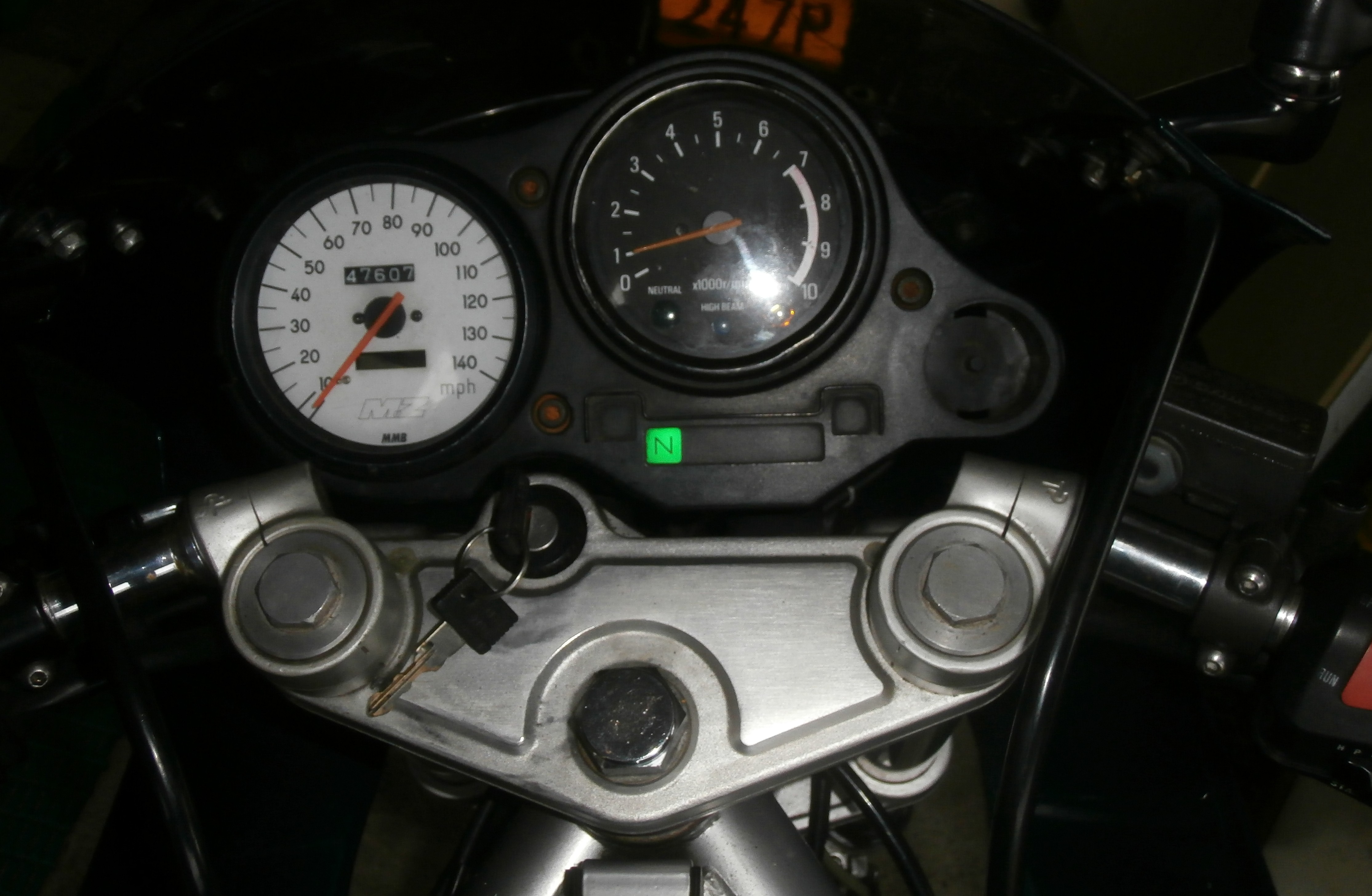

Photos as requested.
Taken with engine ticking over to prove it works !

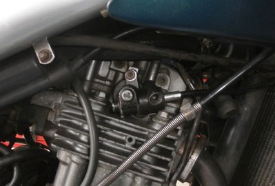

And one of the gearbox itself - yes I know I have not fitted the cable retaining bolt yet....
