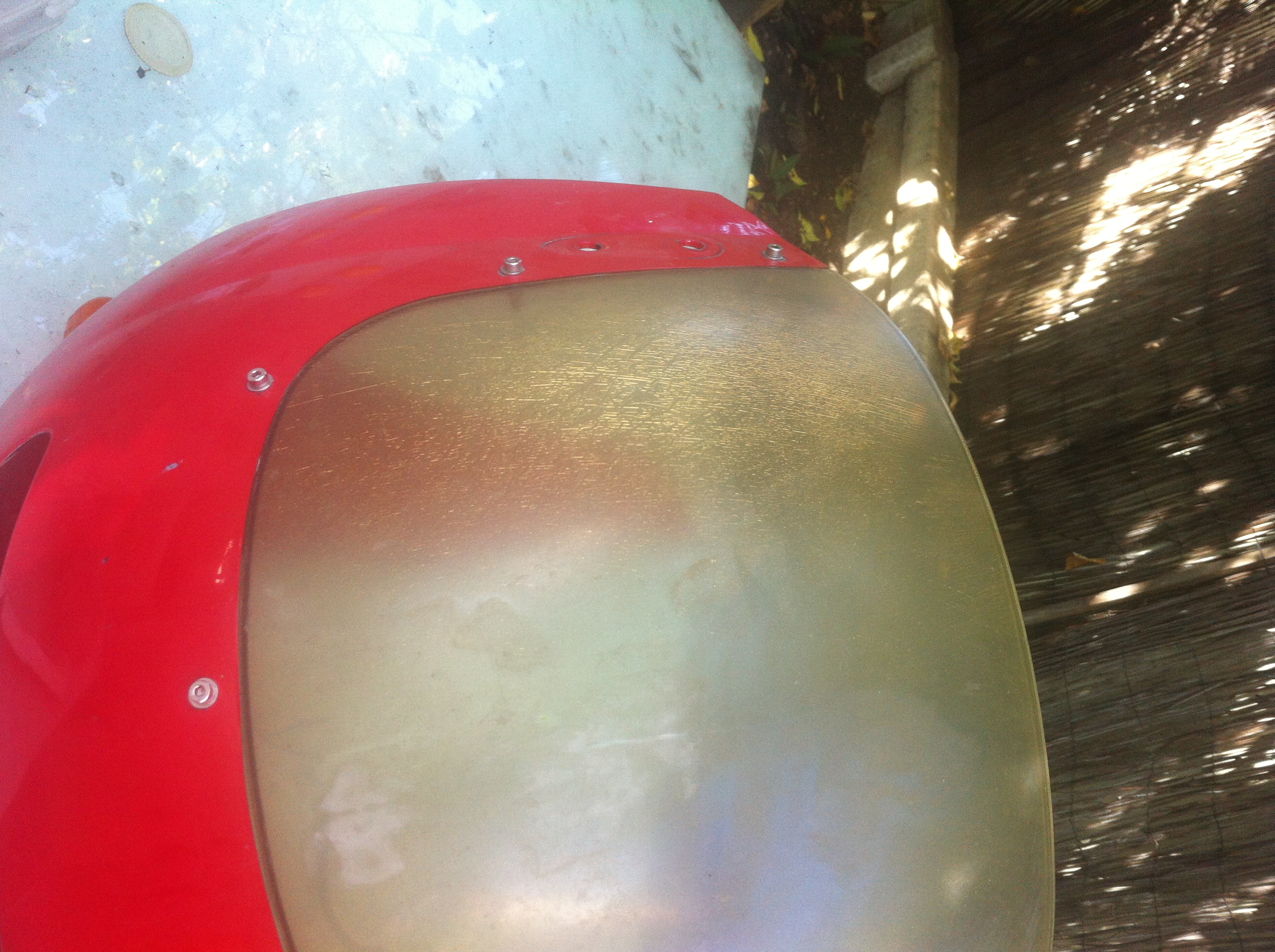

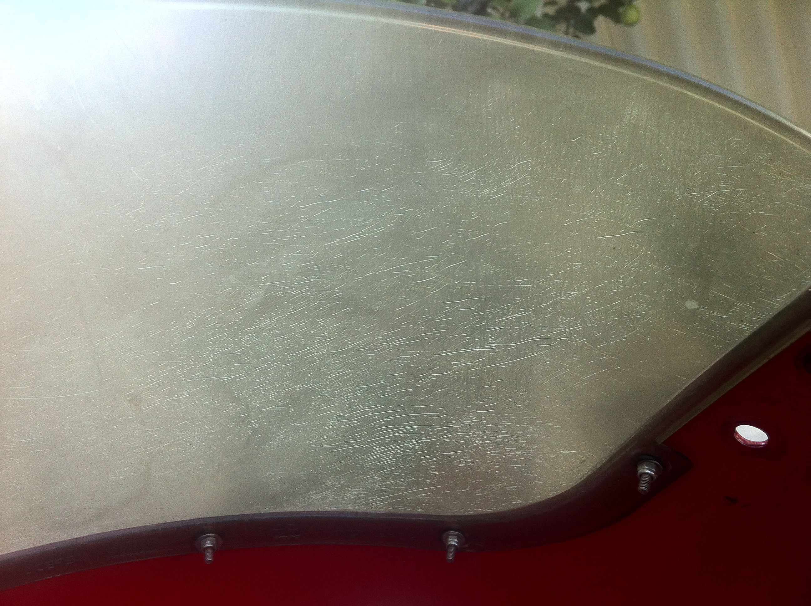

The transparent part of the fairing has major crazing:
Fairing showing sun cracks in the perspex

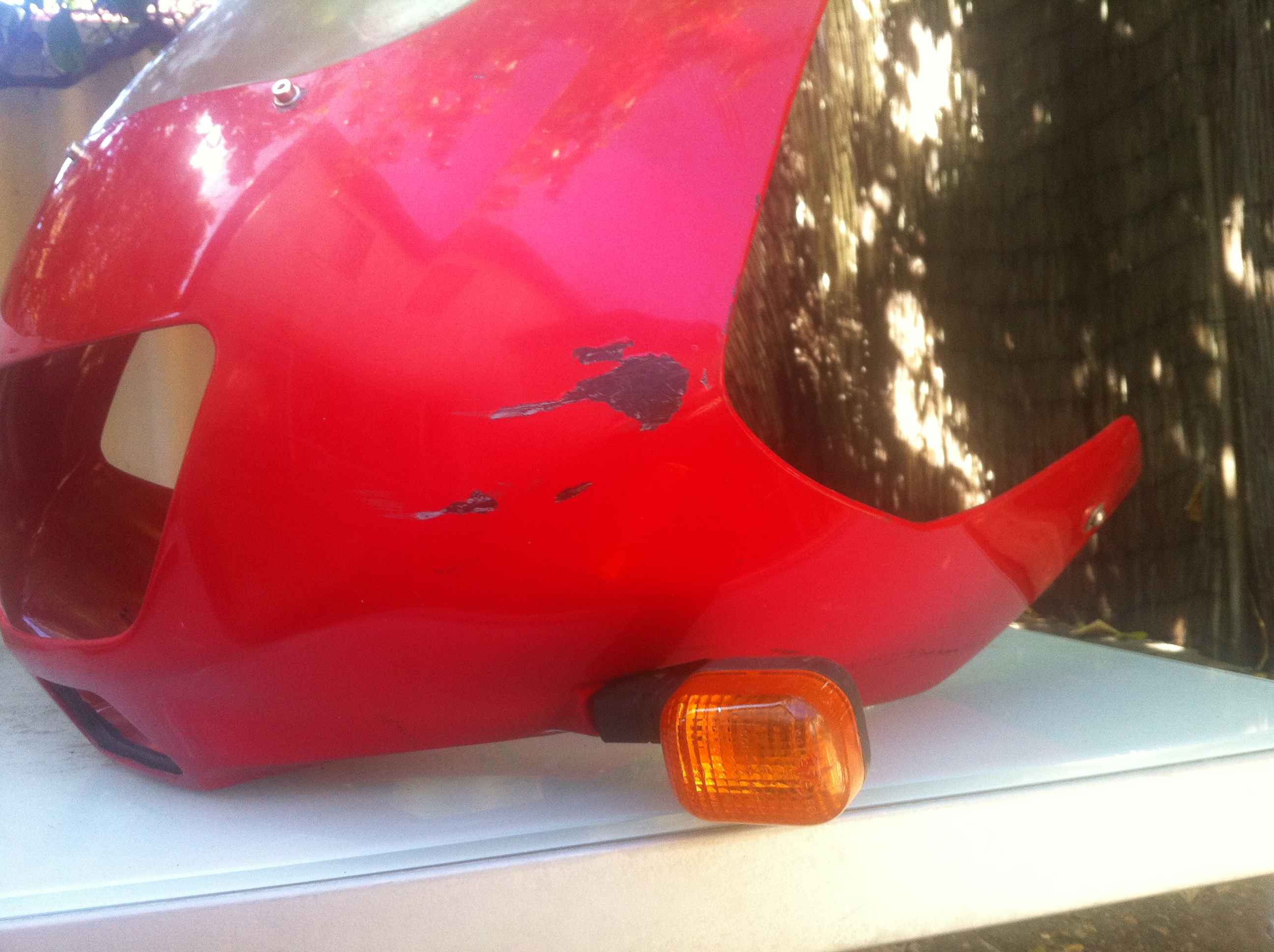

The fairing also suffered at my hands. I had a clutch cable snap and when carting the bike home, the guy driving hit a kerb and swerved violently. The tie-downs parted and the bike did a nasty cartwheel in the back of the ute (for a heart-stopping moment I thought it had gone clean over the side and dropped over a meter onto the road!). As a result, it looks like I dropped it at speed and one day I need to repaint the fairing.
Speaking of the clutch cable snapping - this has happened twice. I think there's a problem with it being caught on full steering lock and being pinched so pulling the lever snapped it near the top.
Fairing showing the damage from bike falling whilst being transported.

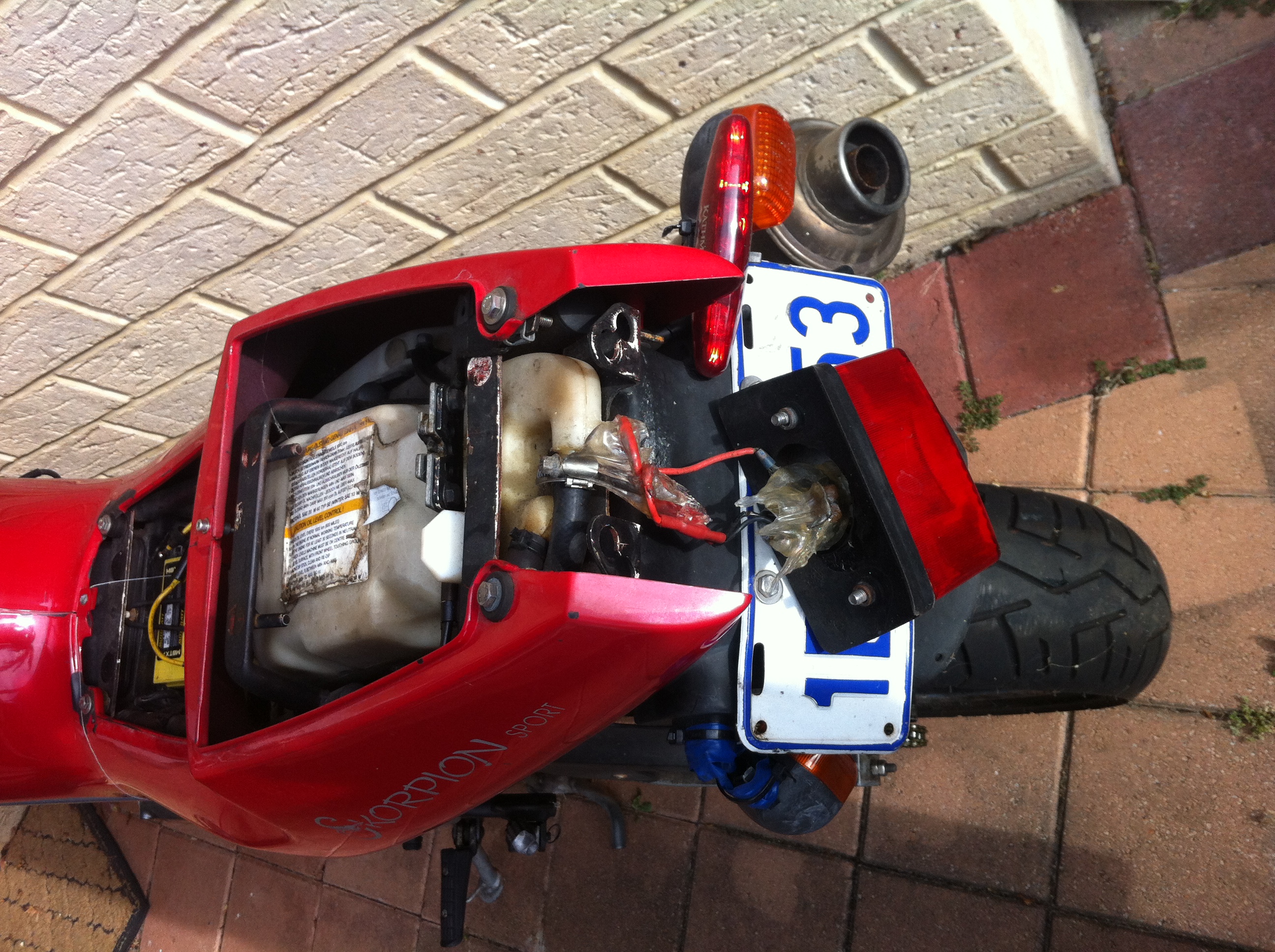

Sad tail-light. A lot of silastic had been used to hold it in place. When we moved to our new, temporary house, instead of being in a nice garage, the Skorp was outside under a bike cover....
in full Western Australian sun...
Taillight drooping from big block of silicon

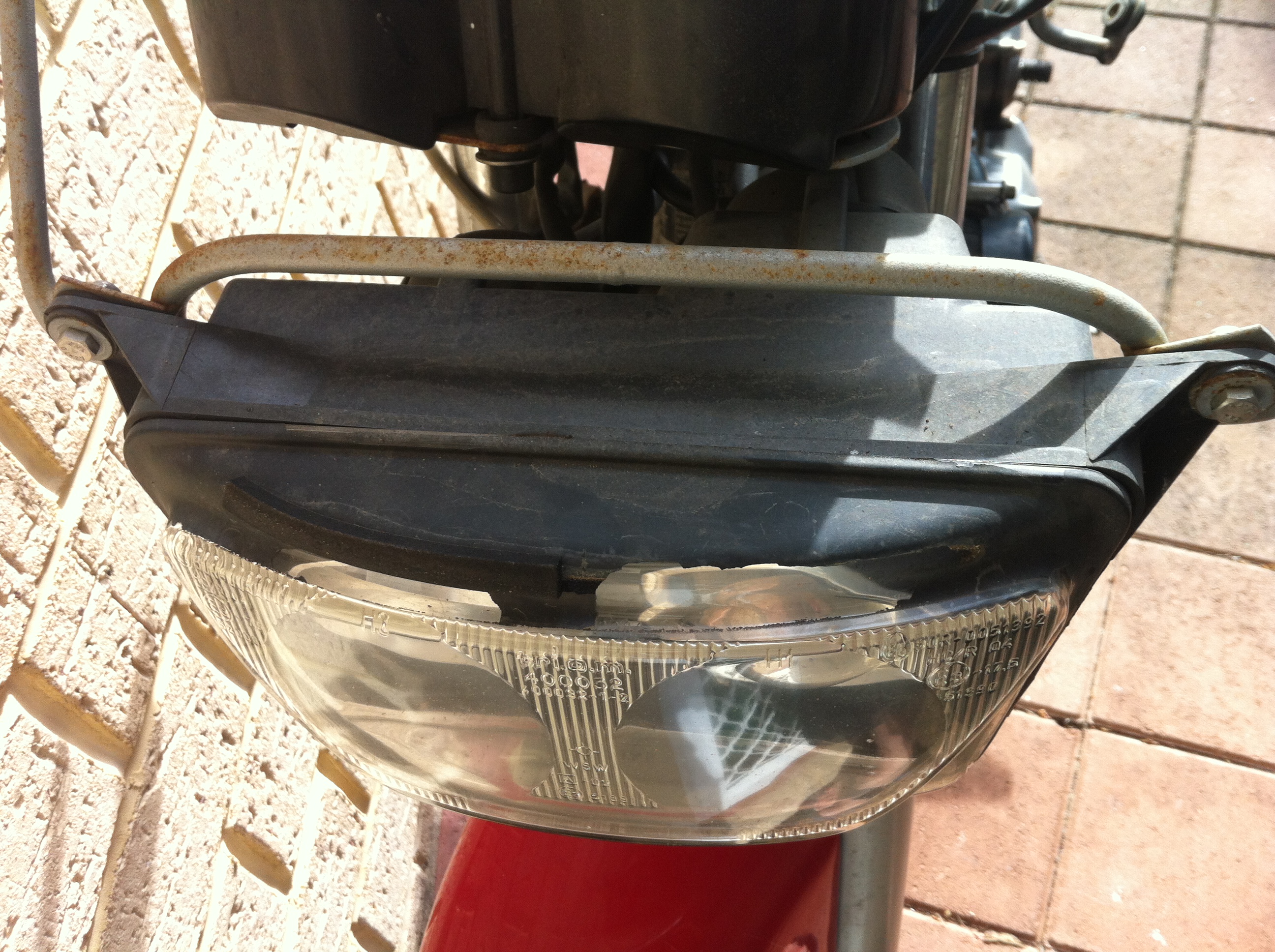

The headlights are fine but one of two small foam pieces providing a buffer to the fairing came off with the fairing. Not sure if I should replace the foam or use a bit of double-sided tape to put it back when the fairing eventually goes back on.
If you click to see the full-sized picture you can see all the rust on the grey frame that supports the fairing. This is all original rust from the previously-mentioned coastal location of the guy before me.
Headlight with one foam trim bit missing from upper rim

Replace the foam on the fairing. Craft stores have foam sheets,you may have to laminate to desired thickness. The tail light shud be replaced as well. I use a Lucas style from Emgo ....it is metal framed and works a treat..some spacers needed though...I used nylon bushings.....Have fun
