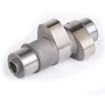

He`s only looking to find the optimum position to check clearances as i see it which is over a fair number of degrees.
This for example has a lot of constant radius opposite the`lumpy`bit where you are checking your clearance.
