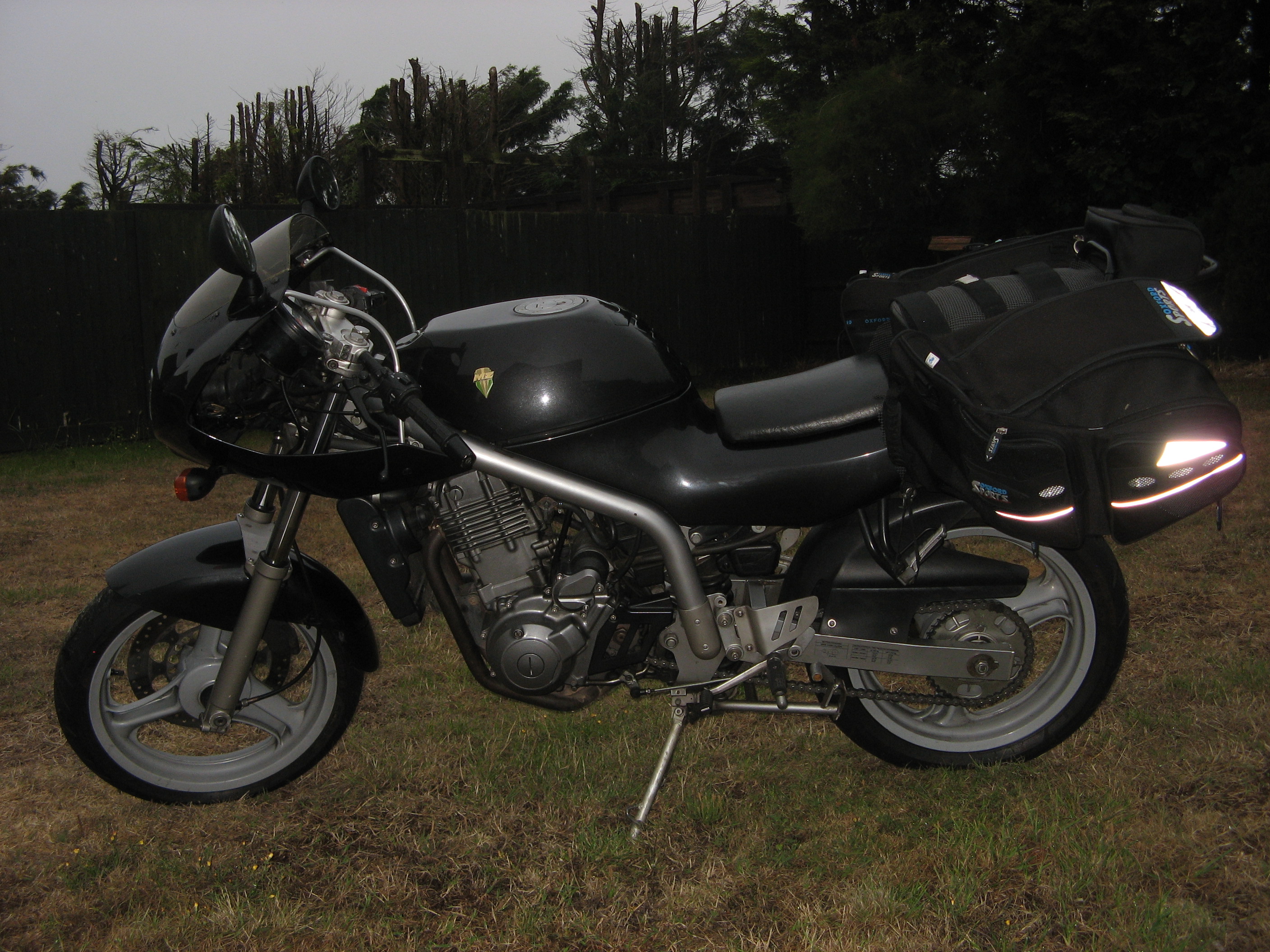

Postby sanddune51 » Fri Jul 11, 2014 2:31 pm
Took a train up to the extreme North West of the UK picked up the Skorp and rode it approximately 400 miles back to the extreme South East of the UK. Brilliant sunshine and blue skies up North and dreary drizzle and dark skies back home in Kent.
Bike performed well all things considered, but will need one or two things attending to.
Throttle is extremely slow acting and needs two bites to get full throttle. I'll have a go at making a quicker action tube to fit in the standard housing.
Carburation feels miles off. Really lean or has a massive air leak. Carb stripdown and investigation called for.
Standard master cylinder offers good overall stopping power from the front disc but feels really wooden with a massive apparently unadjustable span.
On the positive side, the old girl got me home without incident and sports a new pair of diablo's and a new X-ring chain so I shouldn't grumble too much.
As it stood an hour and a half ago when I arrived home. I'm pretty happy with it :)

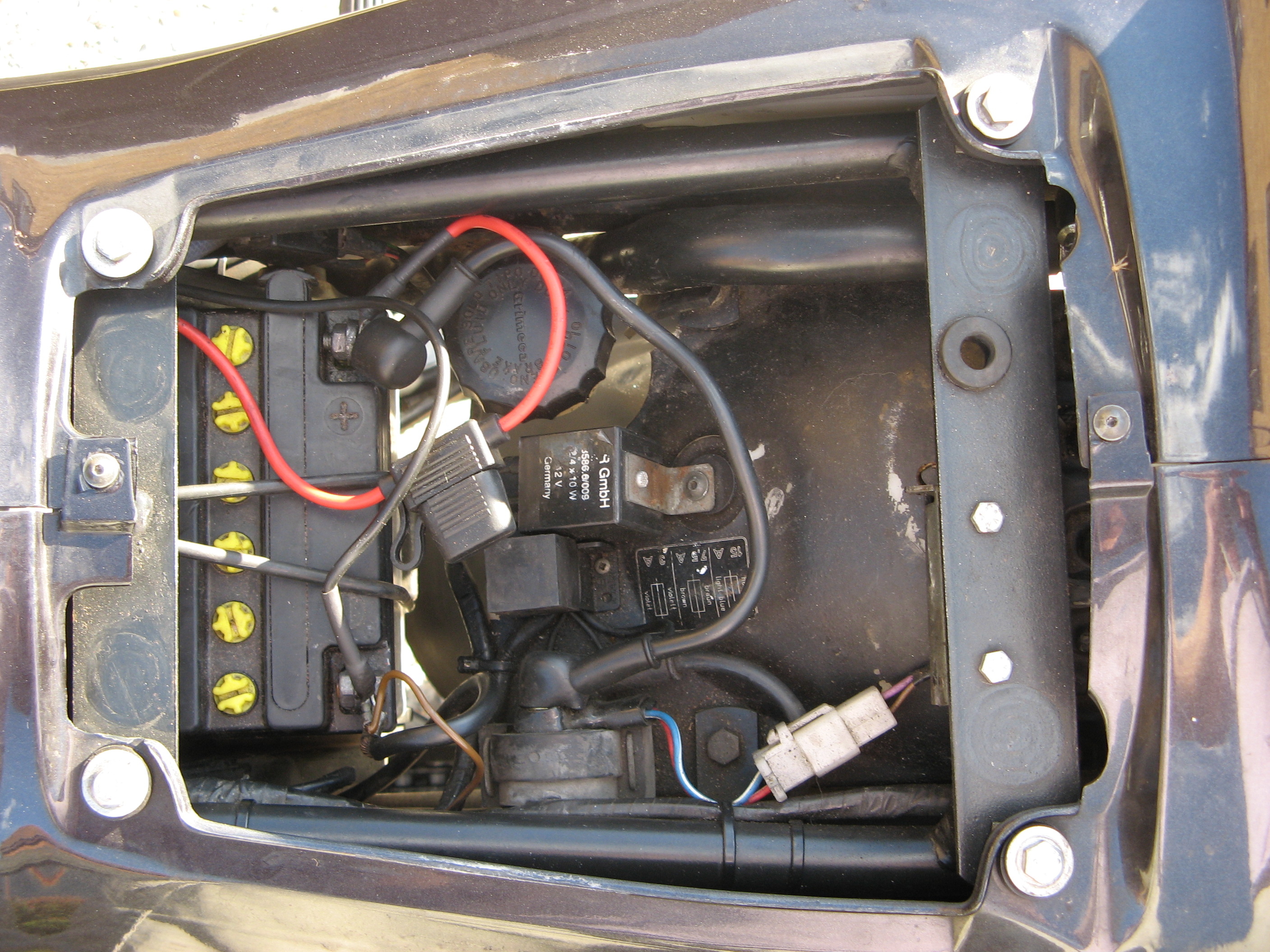

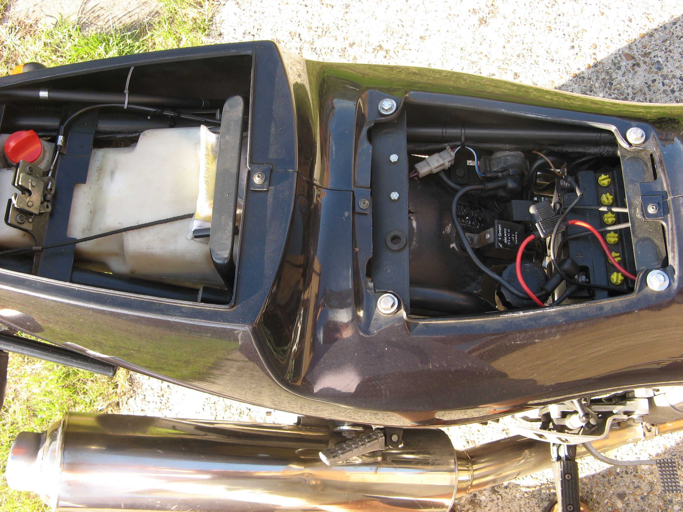

As a first step to improving the bike I want to fit an Ignitech igniter. Had a look under the riders seat, where I'd expect to find the standard ignition box ....... so where have the Mz engineers hidden it away?
Mark.
sanddune51
Posts: 48
Joined: Sun Jan 24, 2010 2:32 pm
Location: South Kent
Re: My Skorpion Sport
Postby Srinath » Wed Jul 16, 2014 9:30 pm
Under the left side cover - just like almost any other jap bike lol.

Postby sanddune51 » Thu Jul 17, 2014 4:35 am
Cool indeed :) Thanks.

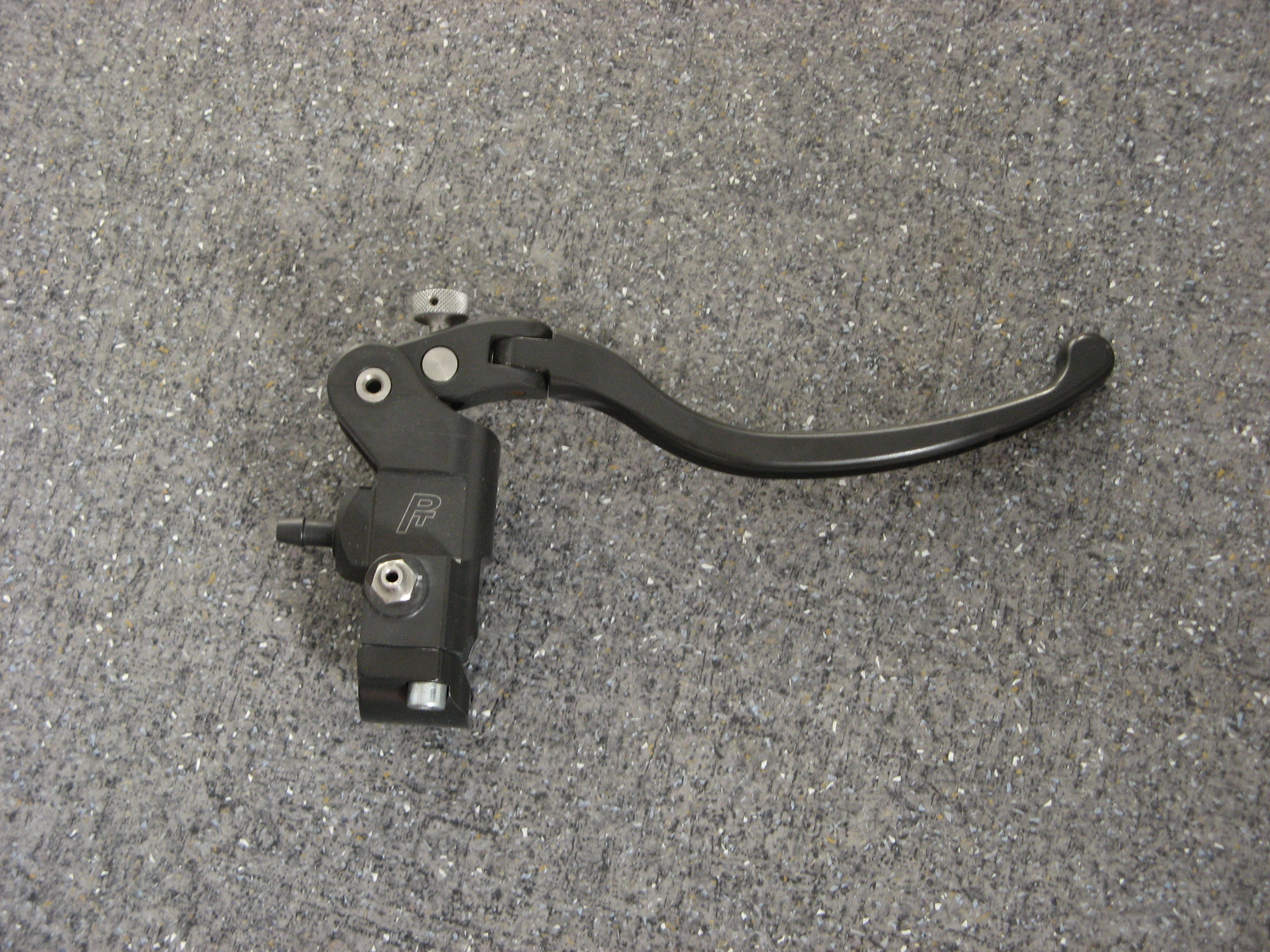

Postby sanddune51 » Thu Jul 17, 2014 12:28 pm
I actually think the caliper works well but it may or may not be really heavy.
I have this which will do the job in spectacular fashion, but it does seem like overkill for an old Skorp :)
Mark.

Postby edfmaniac » Thu Jul 17, 2014 2:14 pm
phoenix76rb wrote:I am thinking of replacing both the master cylinder and the non-adjustable lever on my Skorp with this item:
http://www.oppracing.com/product_displa ... -wlever45/
Expensive. Haven't made up my mind yet.
The 13mm pump is a bit too much power for the stock caliper set up. It would be like a light switch and prone to sending you over the handlebars. My PS11 is almost mushy but provides a nice long linear throw and still has more than enough power for emergency stops. The 12 may be the way to go if you are looking for something more aggressive, yet still controllable.
