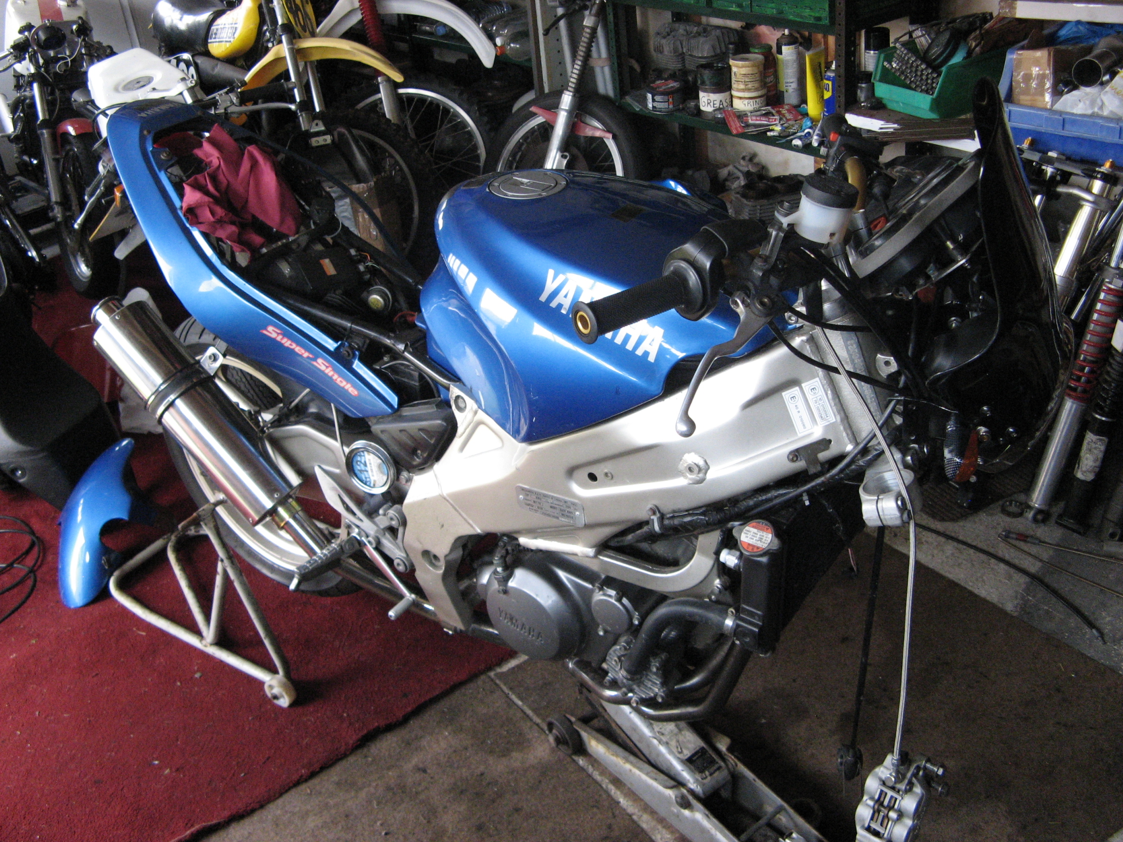

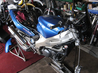

Hi,
Hope I'll be moderately welcome here. Do tell me to sod off if I'm not.

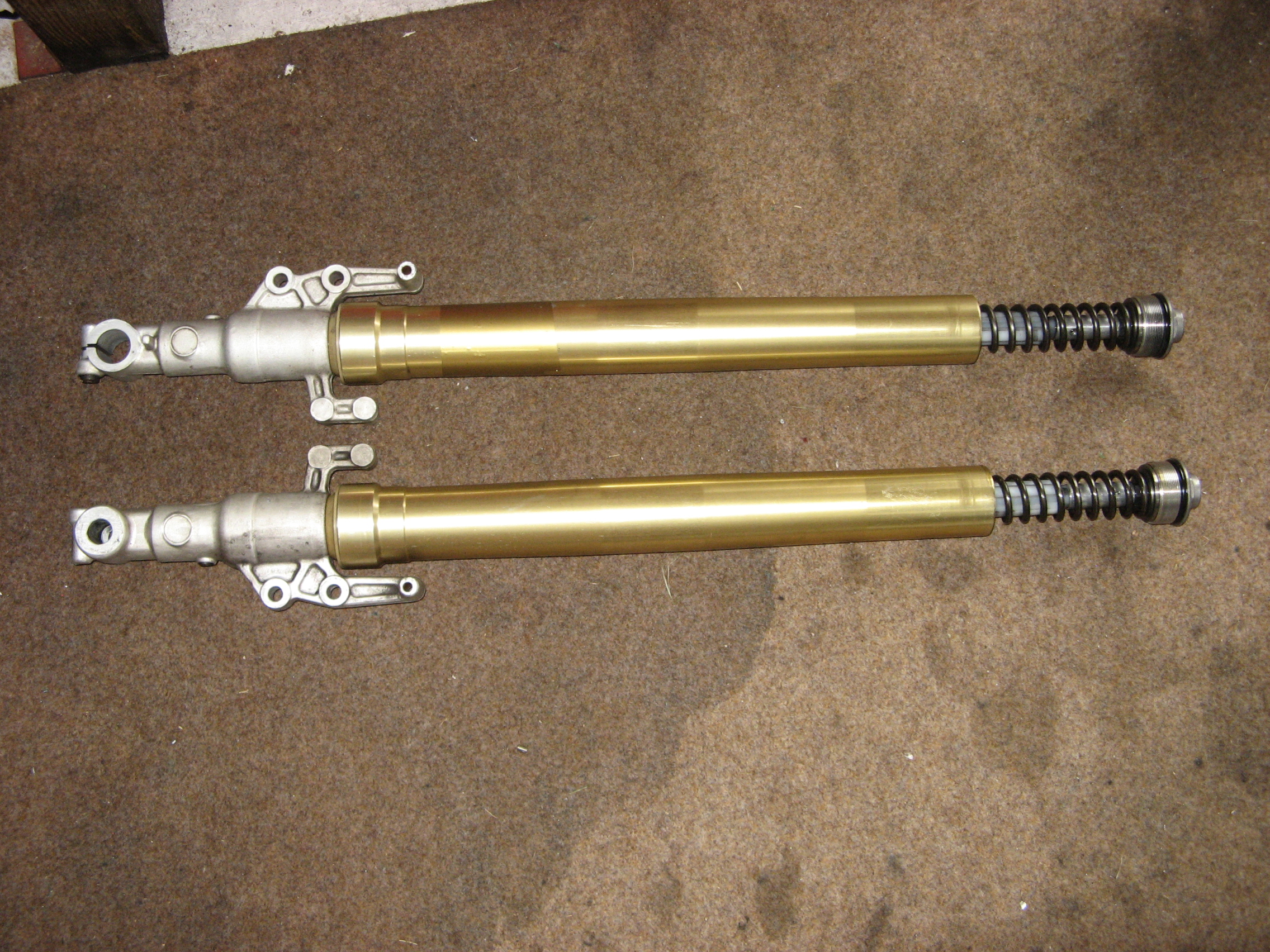

I've recently purchased on ebay, a ratty, hacked about Yamaha SZR660. Upon trailering it home I discovered that both fork seals had failed . I whipped the fork legs out, only shearing one 6mm mudguard bolt flush. I managed to weld a washer to it and then a nut to that to have something to screw it out with. Luckily it came out with a little patience. The fork springs need compressing to loosen the damper rod securing nut and I am currently knocking up a spring compressor.
It's not pretty, but should make a reasonable base for some tuning.

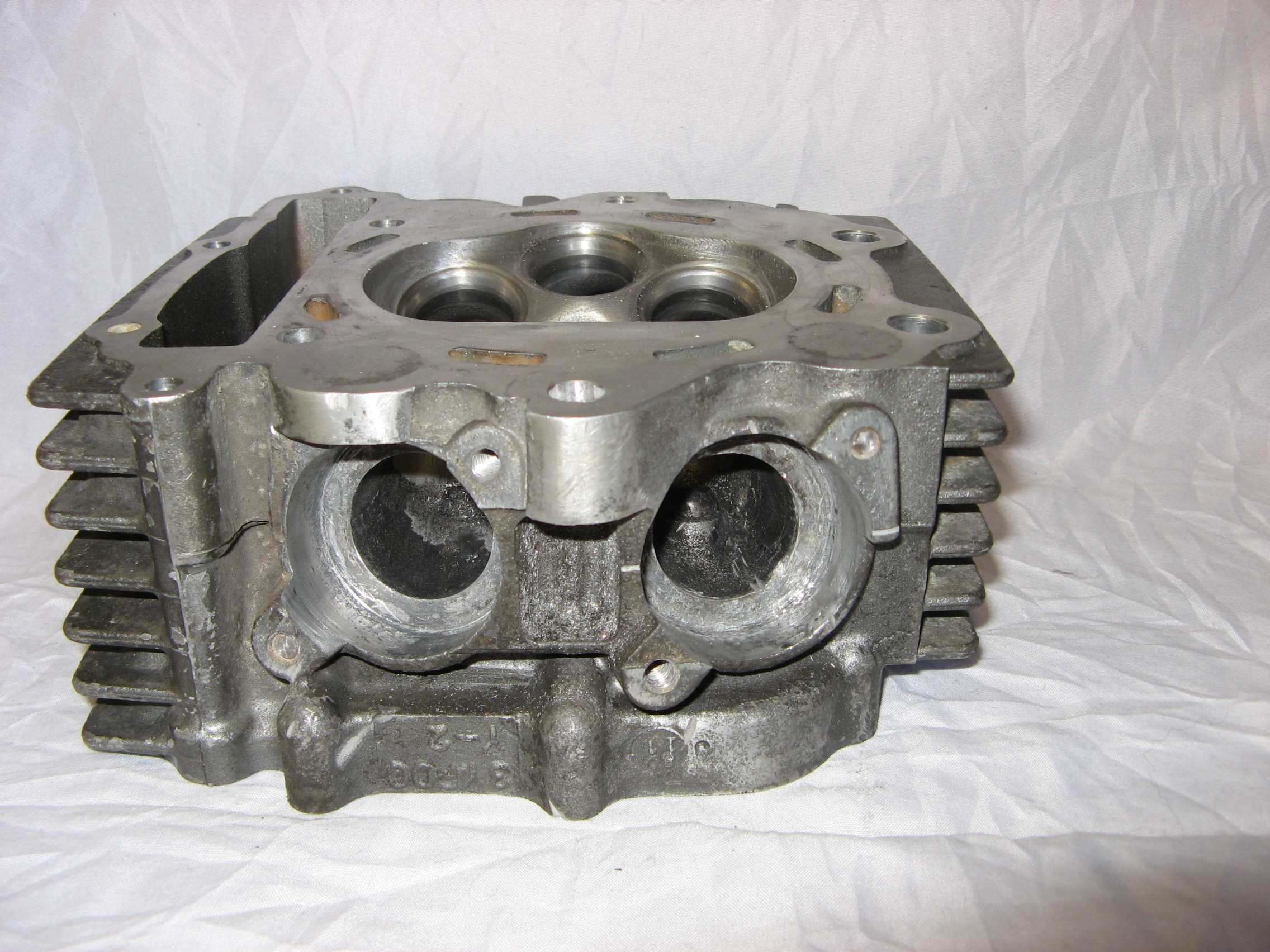

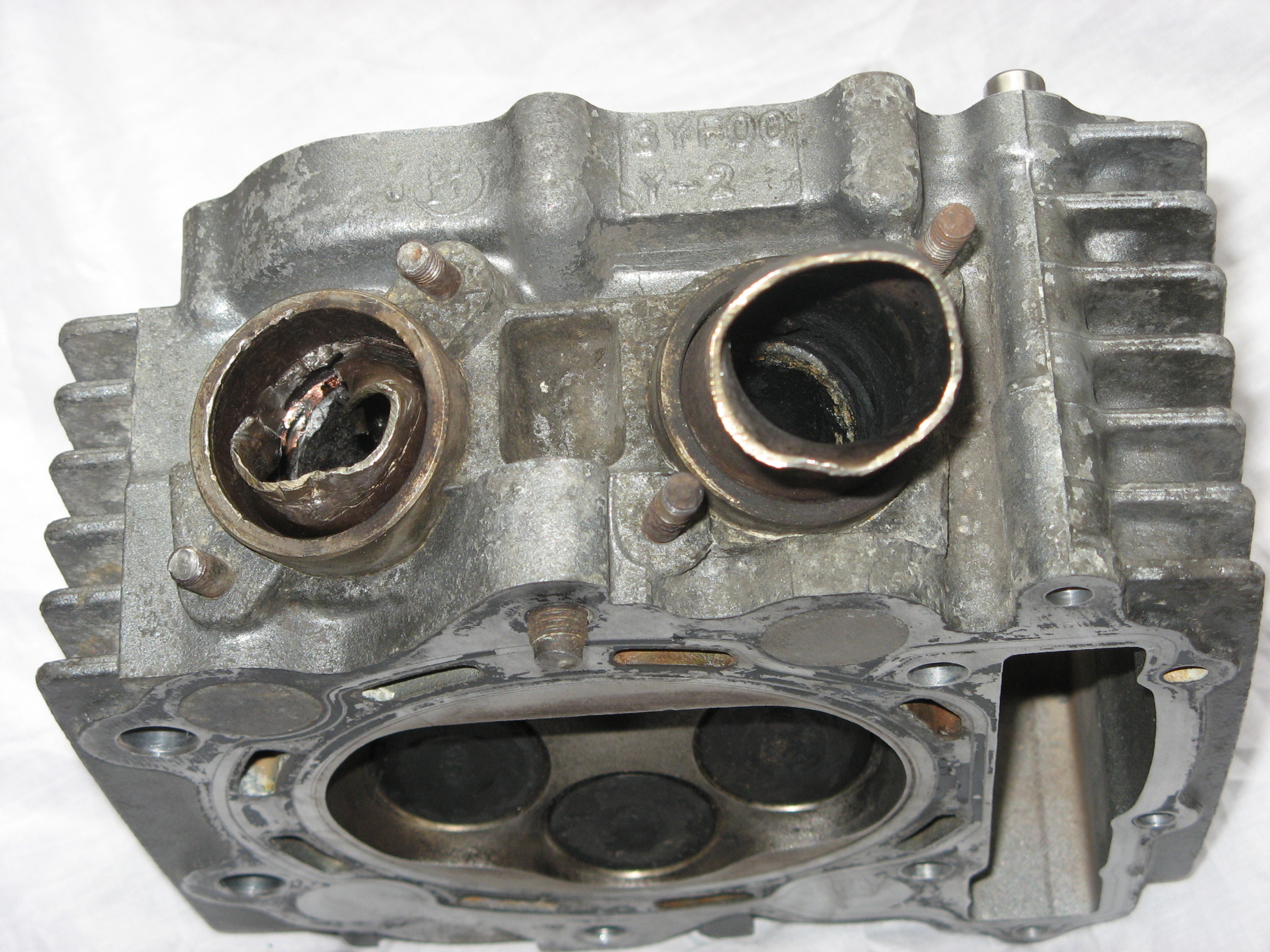

I am currently rescuing a cylinder head from a spare engine that needs a little bit of Tlc before I set to and big valve it.
As you can see it has 2 seized exhaust collars,2 broken exhaust studs an a broken cyl hd bolt :shock:
Some lateral thinking is required here methinks :lol:

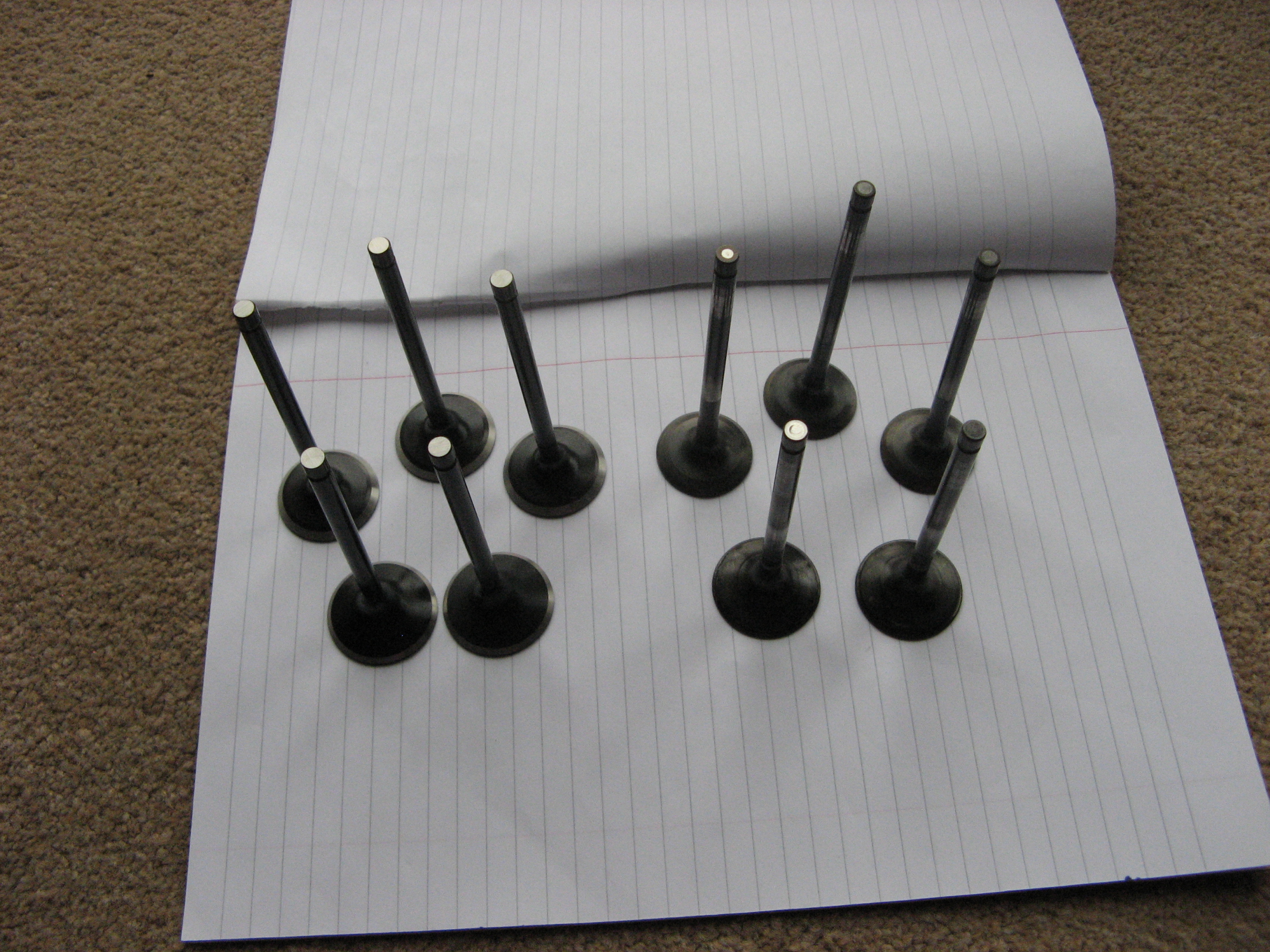

I was primarily looking for a spare cylinder head to rework and his engine came up at a price too good to miss. I intend to big valve it with 5 of these little beauties......
I have pictured the standard valves on the right as a comparison.

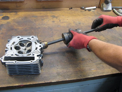

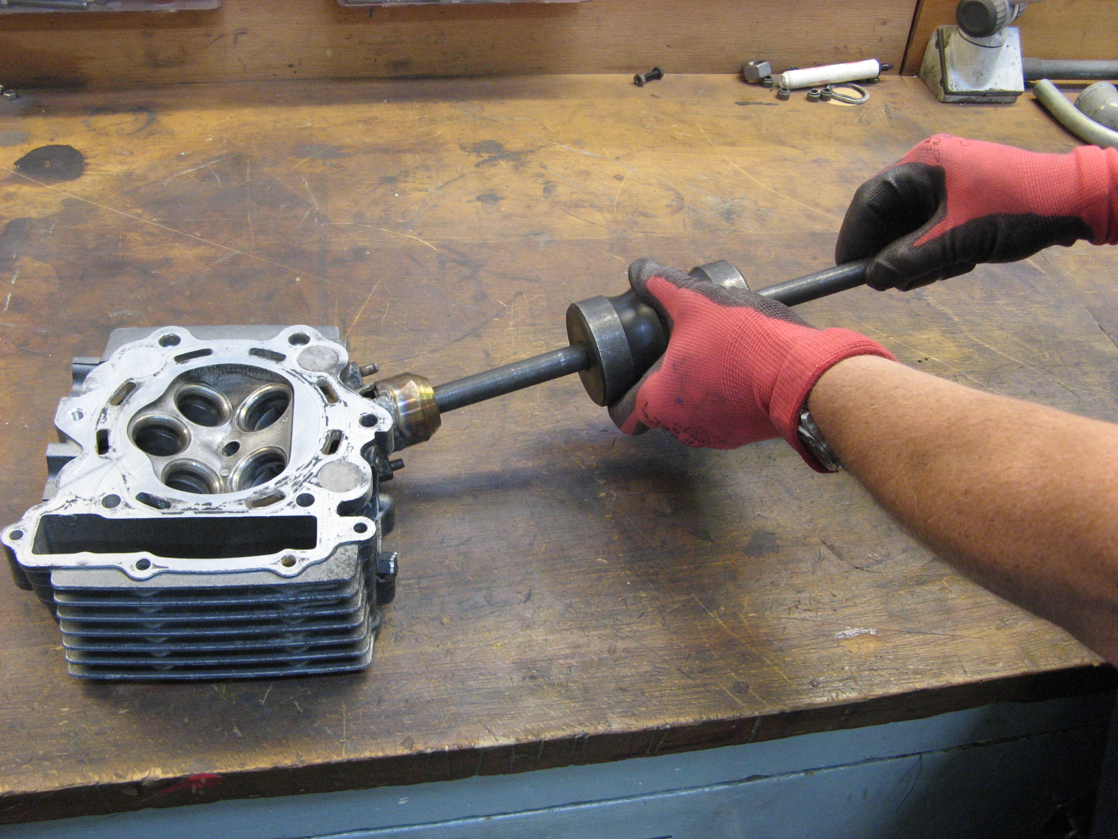

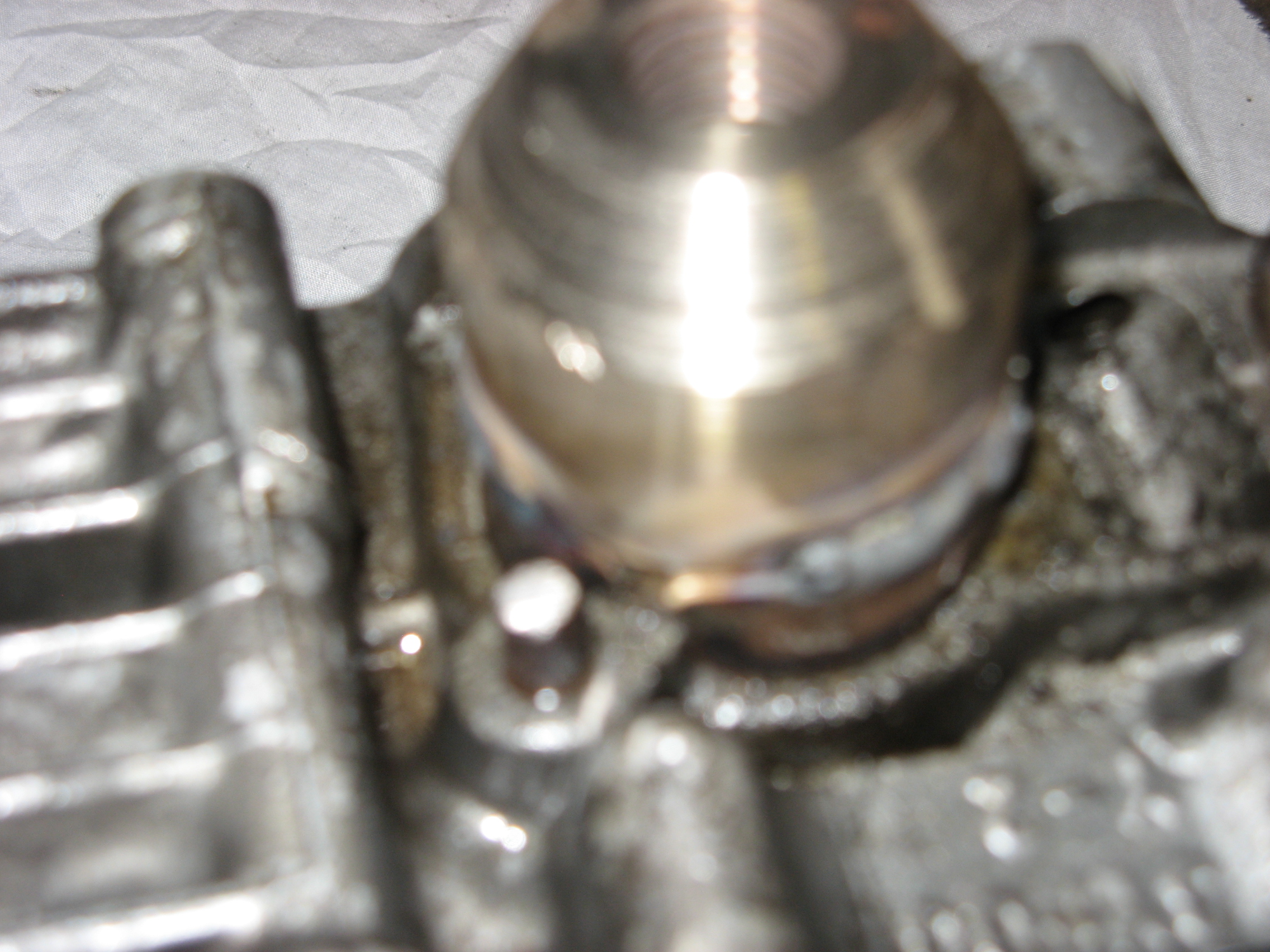

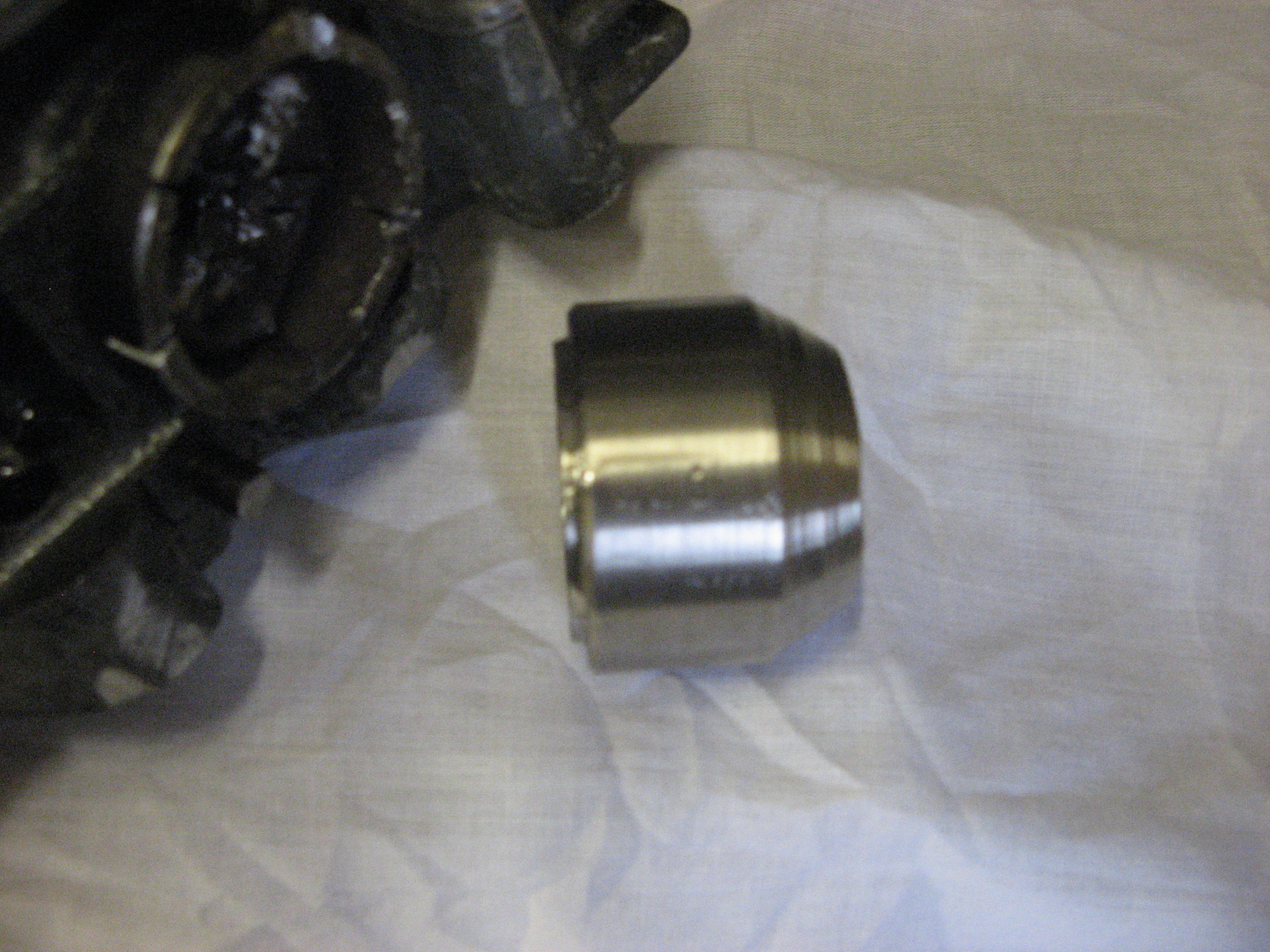

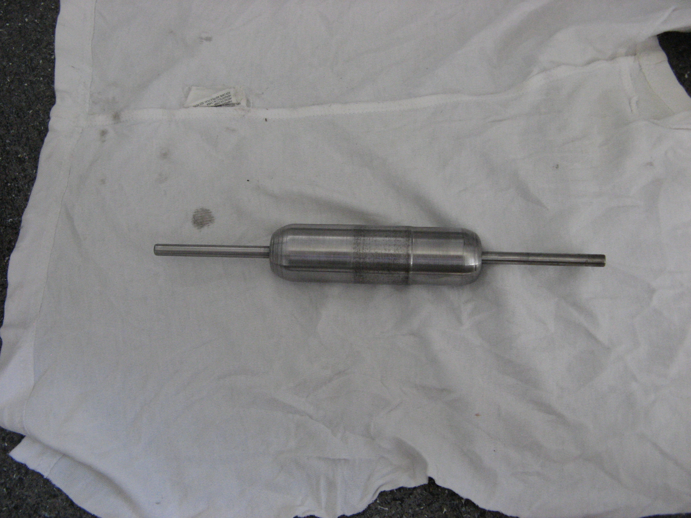

Have had some success with the head. Turned up an adaptor for a slide hammer
It has a little spigot to centralise itself in the collar.

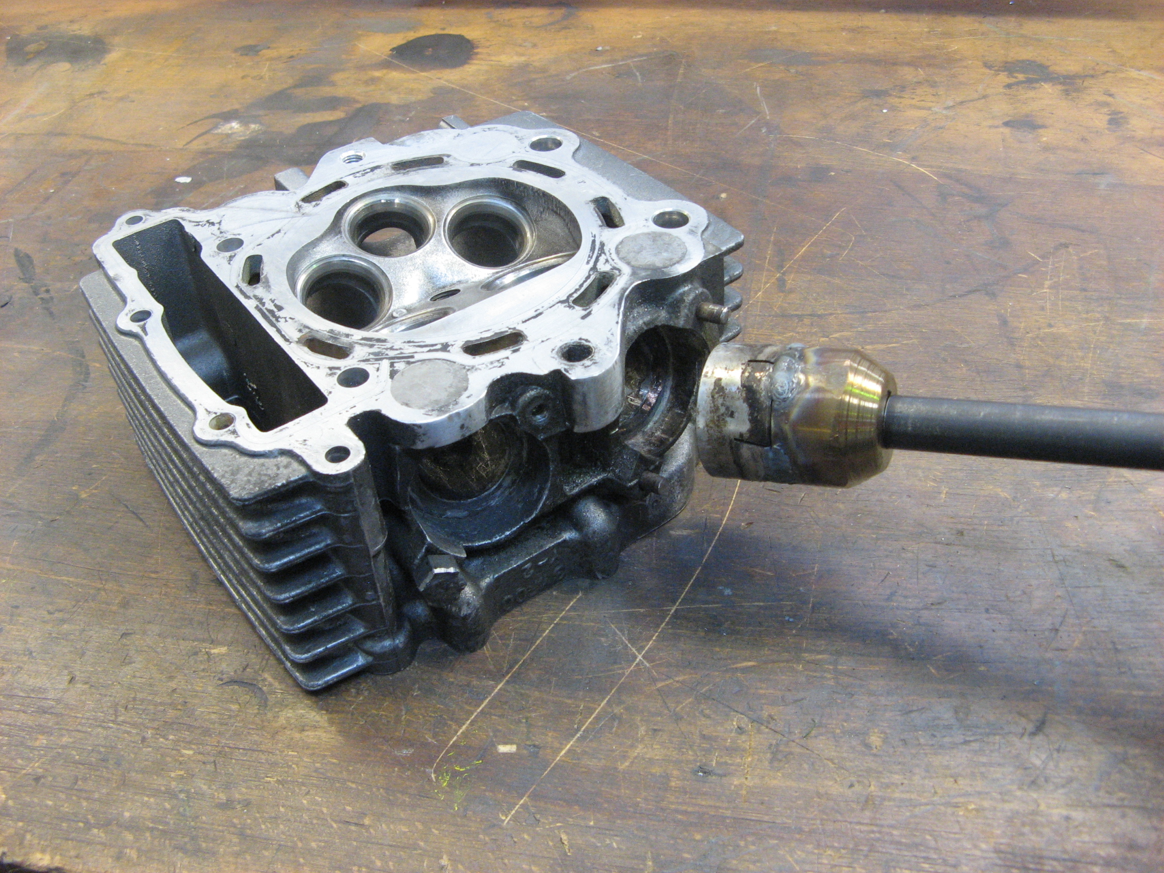

Postby sanddune51 » Wed Jun 25, 2014 8:50 am
Welded to the collar and then pull out with a slide hammer.
So a little way to salvaging a head that many would have scrapped. I just want to get on with porting it now :)

I have removed 2 of the broken 6mm exhaust studs by welding a nut to the stud stumps. All four required removing and unfortunately 2 sheared off below the surface. I tried welding a nut to the cylinder head bolt stump and wouldn't you know it, that sheared off too, just below the surface. I have drilled out this bolt remnant and may "Helicoil" it or fit an weld in an oversize aluminium plug, re-drilling and tapping back to standard.
I feel confident of removing the 2 remaining exhaust studs later.
I have dressed the exhaust collar bores and may or may not enlarge them for some homemade collars and oversize headers. For now at least they will do.

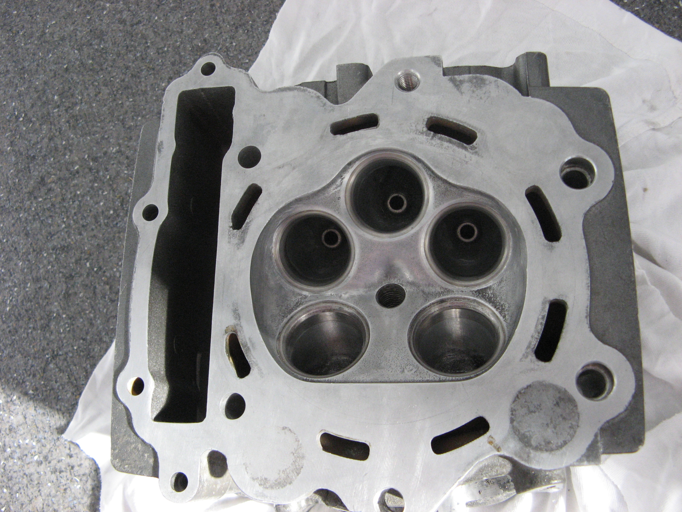

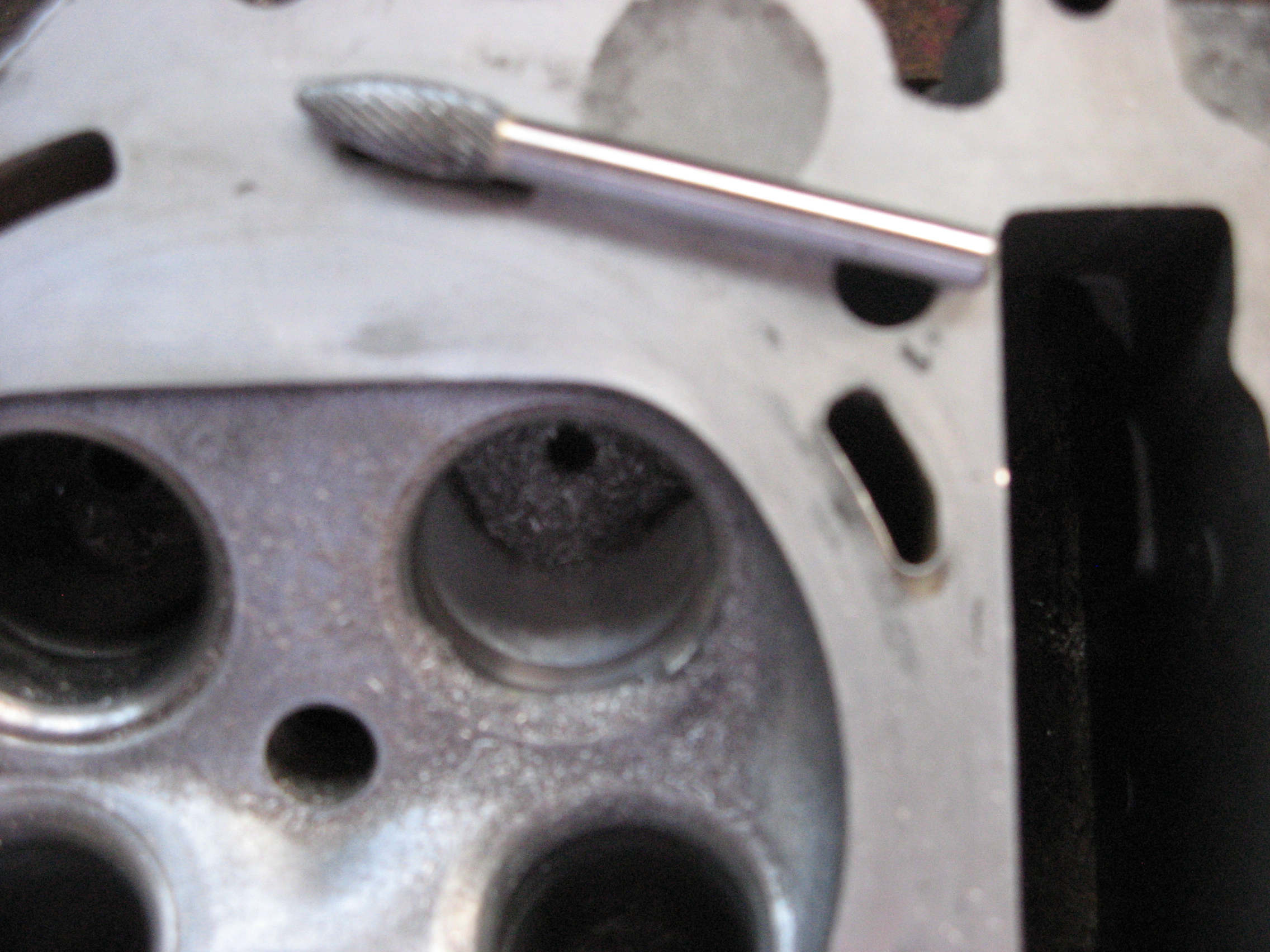

I have distracted myself from the unglamourous repair work by the distinctly more exciting task of porting to accept my oversize valves.
Here I have made a small start on an exhaust throat. I need to make up some gauges to ensure concentricity with the valve guides.
Mark.

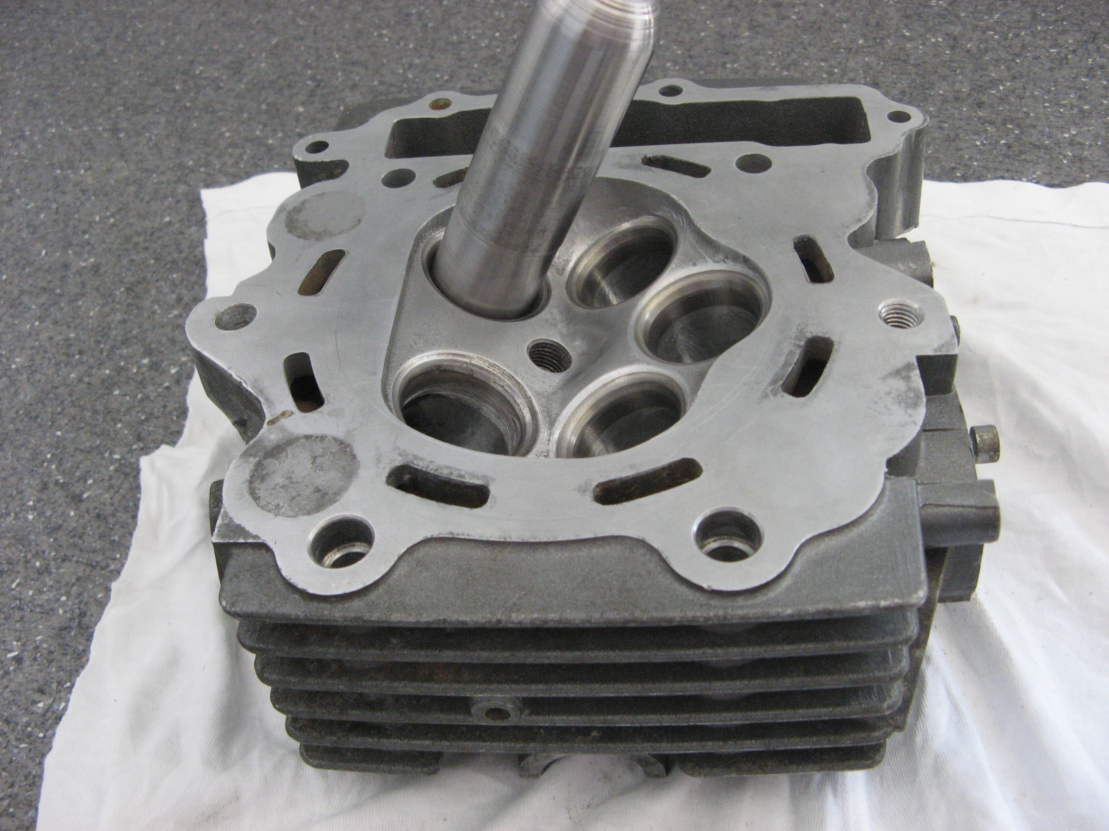

Postby sanddune51 » Wed Jul 02, 2014 3:48 pm
I managed to turn a couple of gauges/test plugs with stems that fit directly in the valve guides to ensure concentricity as I bore the valve throats manually with a Dremmel.
After some careful work opening out the exhaust valve throats to accept my test gauges, I have almost achieved my desired diameters.
I have used engineers blue on my gauges to mark the areas of the throat and port where material needs to be removed. Finally the plug gauge fully enters the port.
Mark
