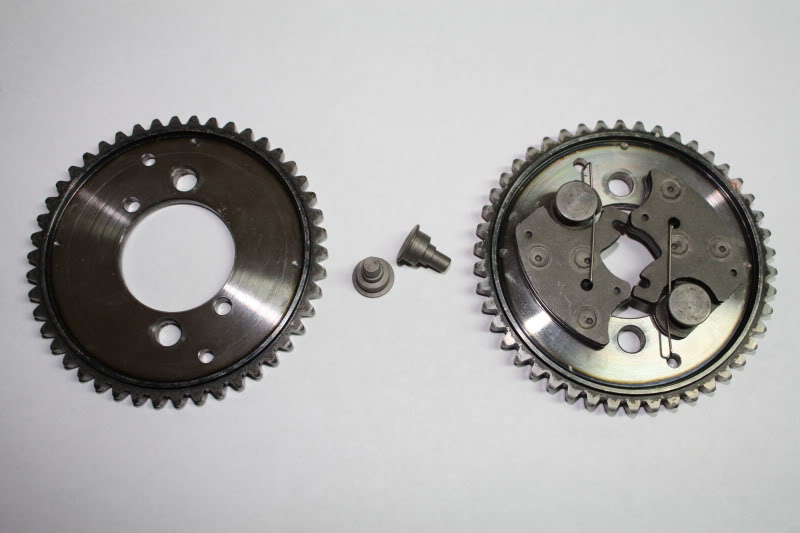

According to memory, there are three dots and they need to be lined up properly in order for your engine not to eat itself. If the cam sprocket were the face of a clock and the gasket surface were level, the dots should be at 9, noon and 3 when the crank is at TDC and the timing chain is slipped on. Also make sure the cam is bolted to the sprocket correctly. I think it will bolt up either way, but only one is correct. Do you have a service manual for the Raptor 660? It will help on the top end work.

I didn't unbolt the sprocket form the shaft.
We set it to tdc and put the valves closed, the 9 and 3 marks were there, we never looked for the 12 o clock mark.
The motor was spun over and it made puff puff compression out the exhaust, no issues, I will open it and make the guide seat in the lower groove, and the silicone seal for the cover and look at the timing marks ... you see the brace is out on the frame, it will be unboltable, I can yank my head cover in about 3 mins ... the motor stays in the frame ... heck, I may do it to the other bike too ...
