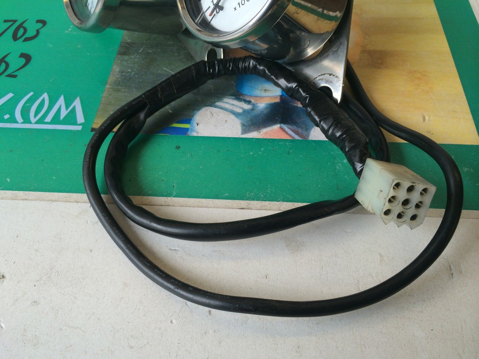

I spotted these on Ebay:
eBay item number:151320472487
http://cgi.ebay.co.uk/ws/eBayISAPI.dll? ... 1320472487
