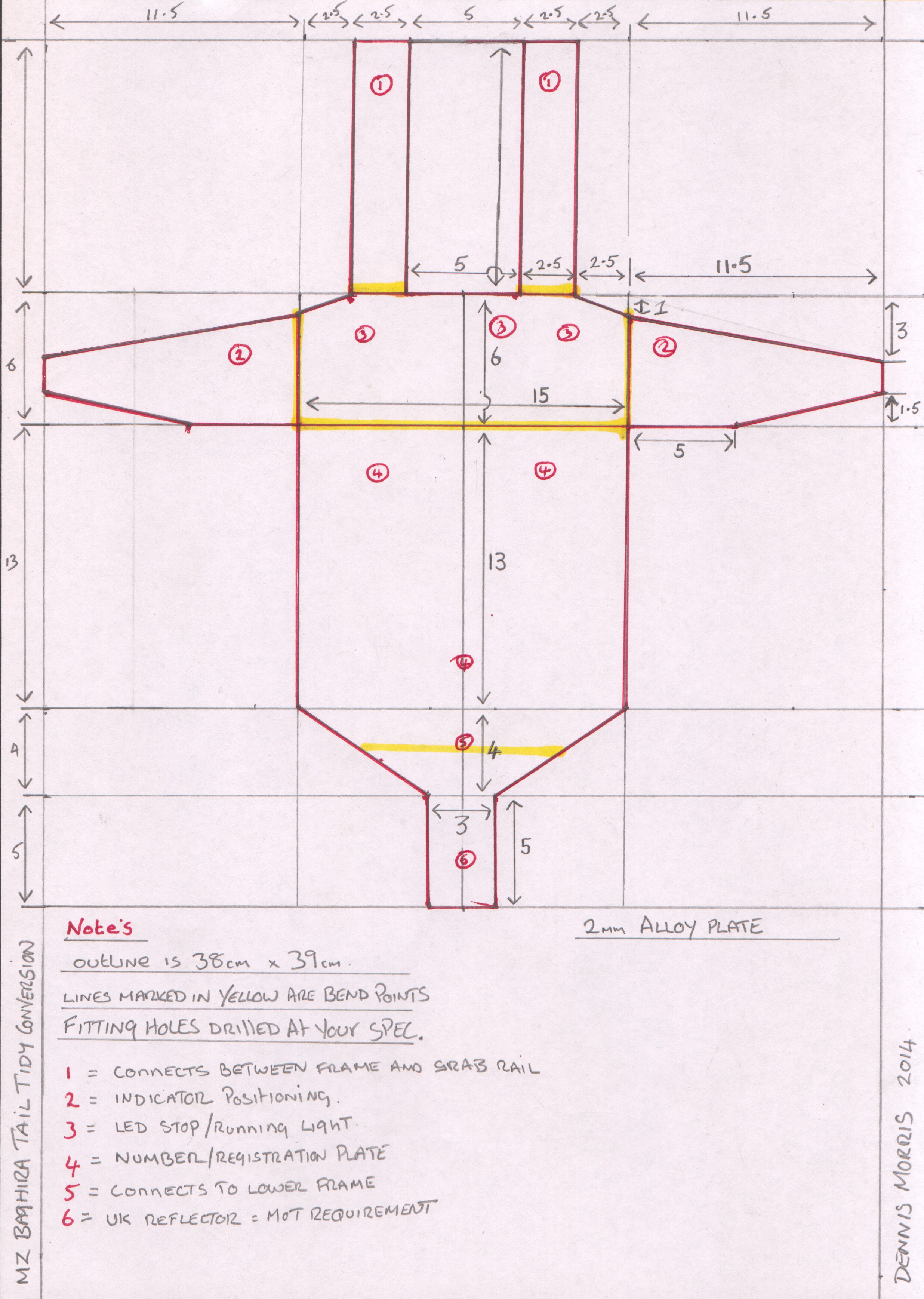

thought i would share the plans for a tail tidy,,
no cutting of the frame needed,
all original parts can be returned to put the bike back to standard
MZ Baghira tail tidy plan 2mm alloy plate

Thanks Den I feel another project coming on.

Thanks Den, I might get one of the lads in the fabrication shop at work to knock one up for me, might use Stainless instead as its free :wink:

Baggy_Al wrote:Thanks Den, I might get one of the lads in the fabrication shop at work to knock one up for me, might use Stainless instead as its free :wink:
Al.
soo jealous , stainless would be nice , too hard for me to work on though , thin plate is very hard to drill and jigsaw,,burn out all my drills,, :lol:
so glad to see my diagram has been useful , its been downloaded over 250 times,,probably see on ebay soon,,lol,
