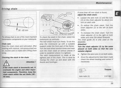

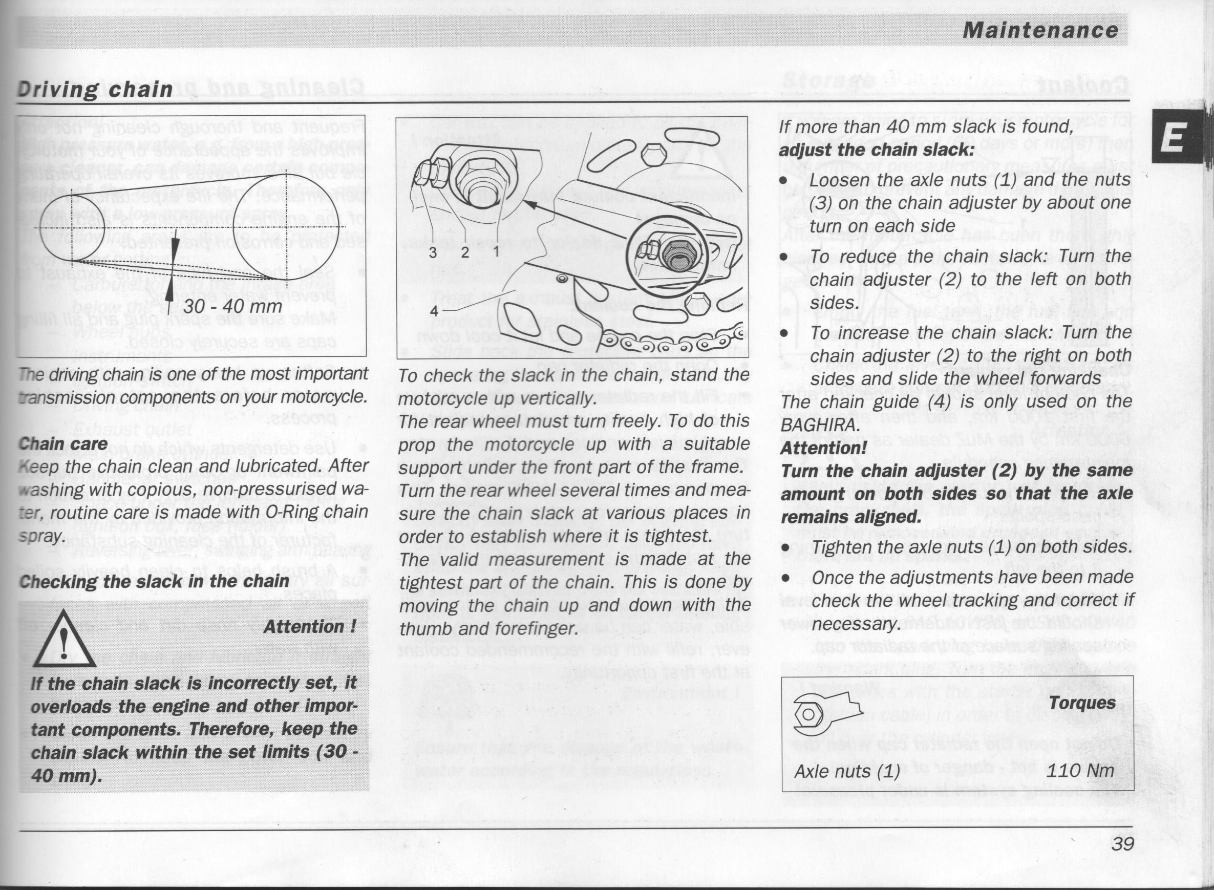

Postby Glidd » Sat May 03, 2014 2:33 pm
Hi, the Baghira/Mastiff owners handbook shows this for chain adjustment.
