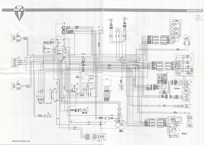

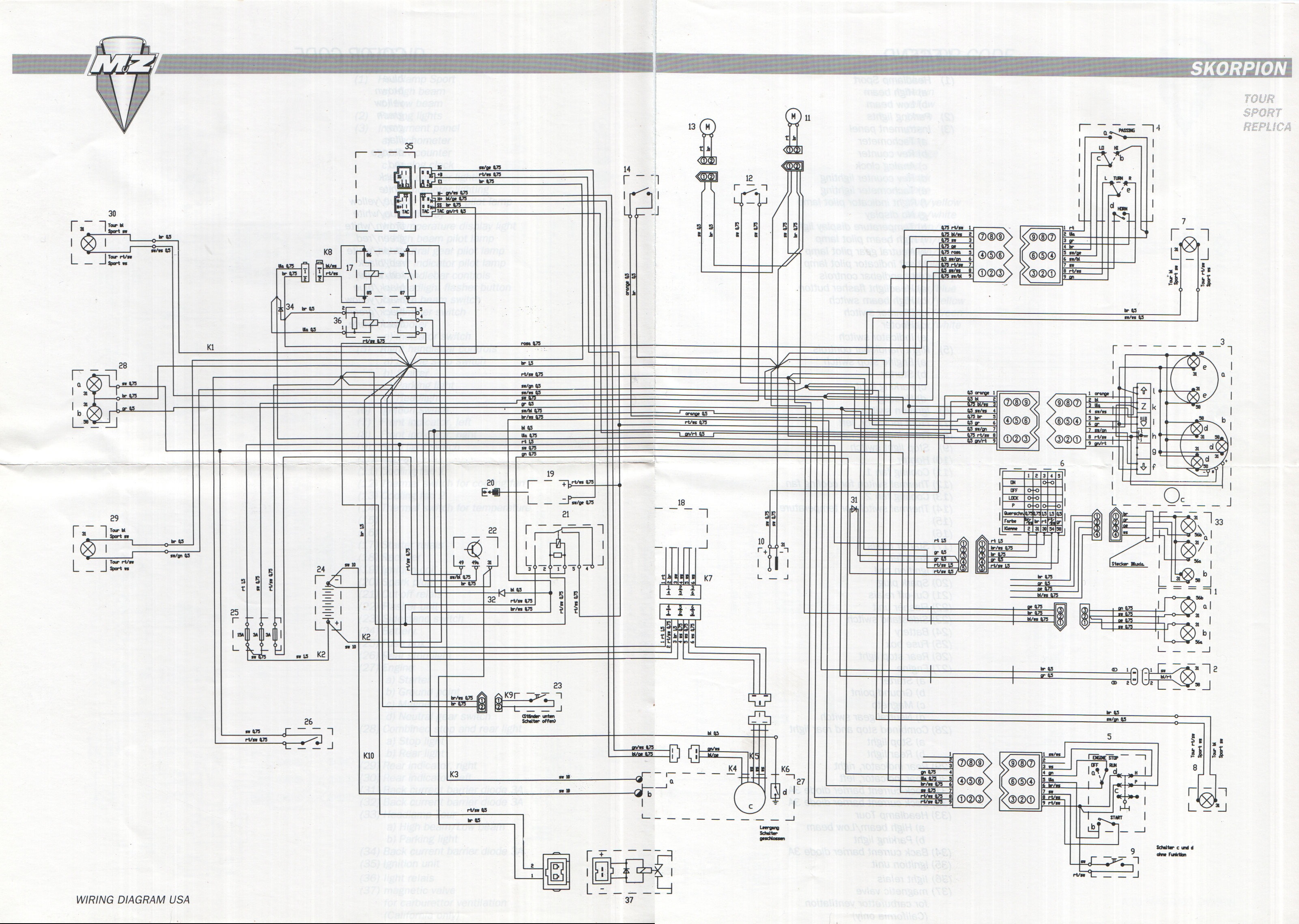

Postby Norman Wade » Tue Apr 29, 2014 1:10 am
Try these:
Norman
Norman Wade
Posts: 134

Postby poppanitrous » Tue Apr 29, 2014 8:56 am
Norman Wade wrote:Try these:
Norman
NORMAN, you have officially made my "cool list", thank you much bro.

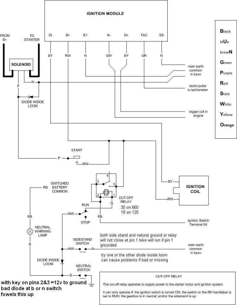

Postby DAVID THOMPSON » Tue Apr 29, 2014 10:16 am
click on file to make it display larger
