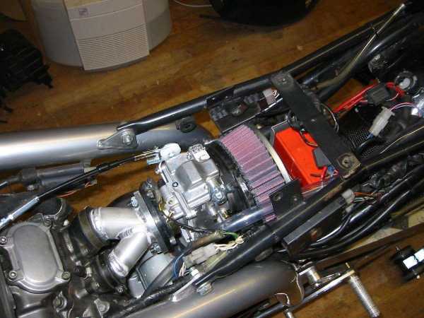

look upposts by morbidell117 and bill jurgenson, both have a couple of pics I believe...Mike used a rhino manifold with an FCR41 and Bill used a TM40 Mikuni on a Grizzly manifold,
Both have to have adapter plates to match the inyake bolt pattern on the head..Eldebrock had a carb and manifold for the raptor that would work, seen them on ebay once in awhile....

Google never ceases to amaze me. I input "mz skorpion single carb" and immediately had access to pics of a single carb manifold. :D

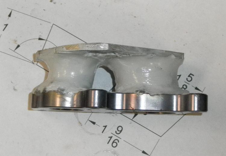

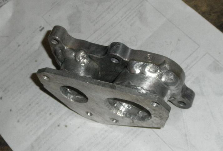

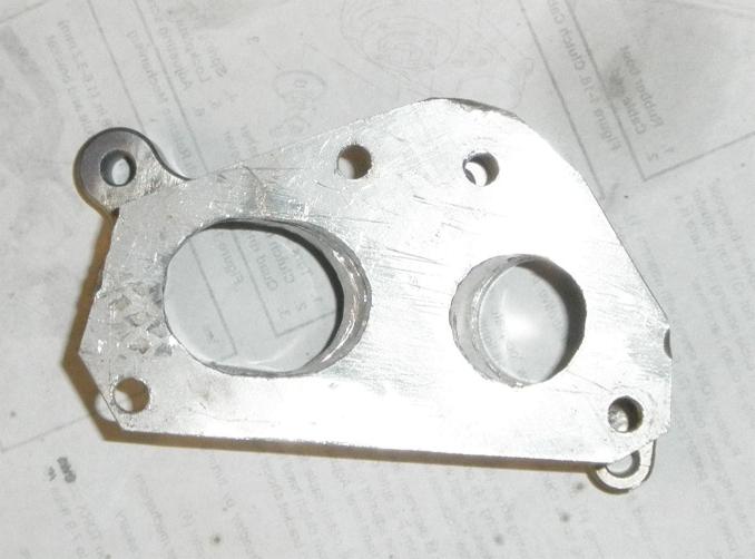

Postby harold » Wed Dec 25, 2013 7:00 am
While it looks terrible, it is hard to weld the pipes I attached to the spacer, since you can't get a mig tip in some places. Silicone to the rescue. The polypropylene spacer was used to get the tilt right. It is beveled both ways. I never could tell a difference in taking out the brace, which gave me the room to mount everything.
This is all the pictures allowed, so I will post another with the spacer.

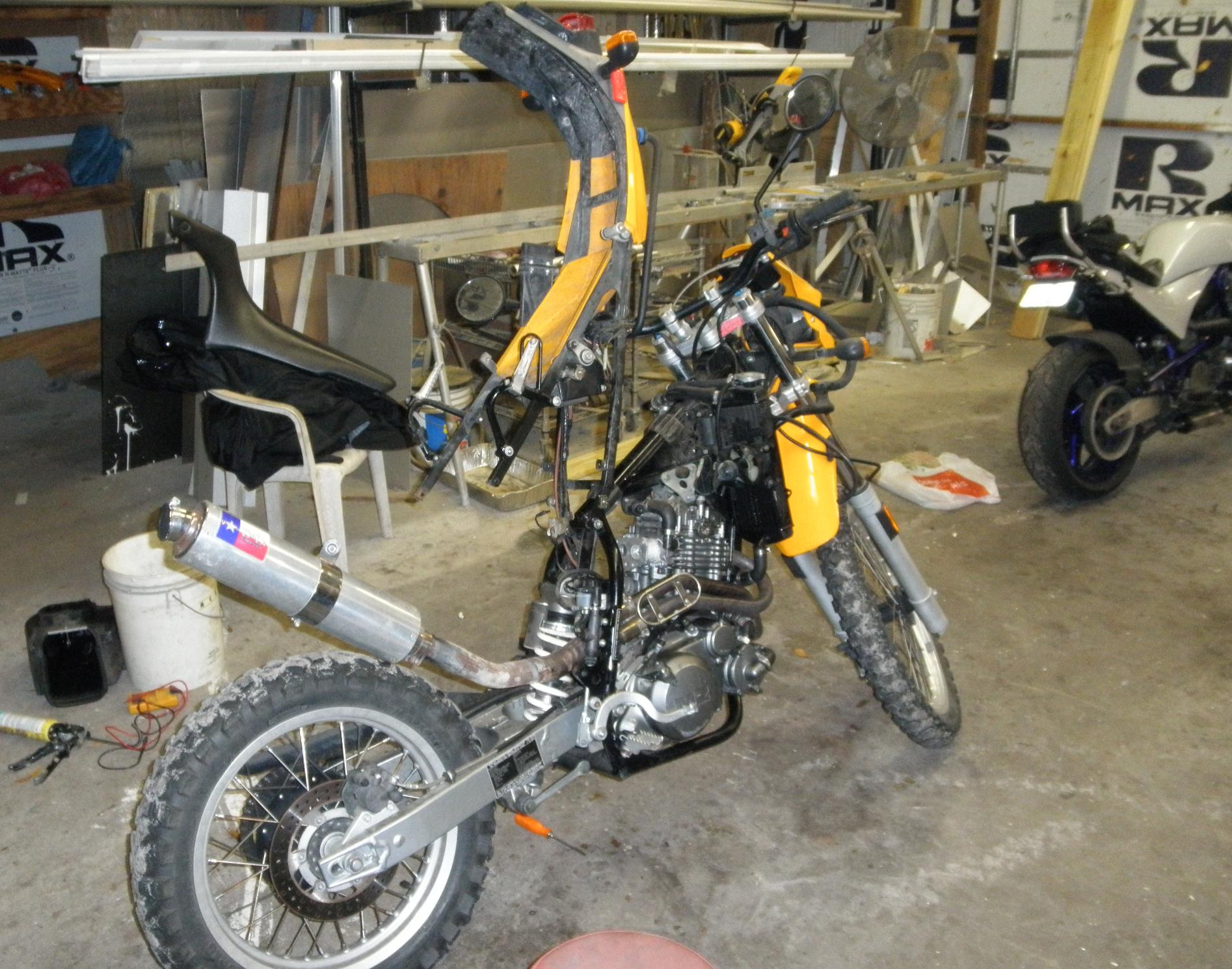

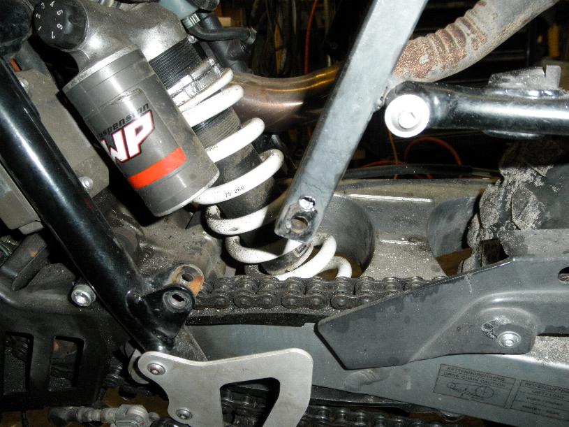

I just noticed my spacer picture was already in my post from 2 years ago. The other thing that made a big difference was lowering the seat. Mine tilted you towards the gas tank, and when I flipped the rear frame forward to get the stock air box out, I cut and re-drilled the support arms. That lowered the rear of the seat, and took the tilt out, without affecting the suspension.
