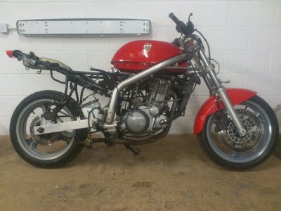

Hi All.
I've been getting itchy at the thought of chopping my Baggy and can't bring myself to it so I've found a donor for a winter project.
I've just got my grubby hands on a Skorp in boxes, back together now and running. I intent to fit pod filters to reduce clutter for a cafe racer style conversion.
Anyone been down this road and have any advise on weather or not I need to rejet and if so any base settings to get started? I realise there are a lot of variables that will affect it running but its a stock motor and a short cone exhaust.
Any help would be much appreciated.
Chalks
