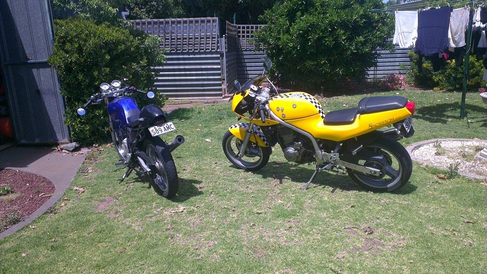

My little Scorpio and the skorpion
Someone has used liquid nails to stick metal washers for a tank bag on it
