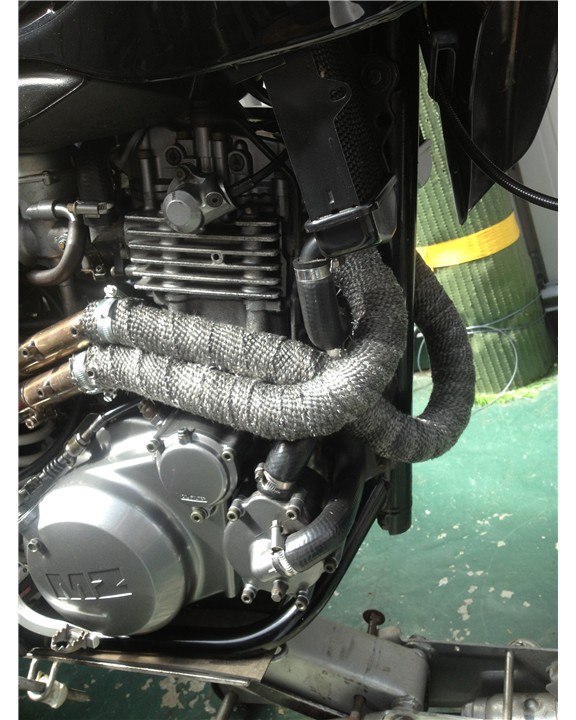

Hi maty , I and many others here have reported the very same issue , My 04 baggy gets hot within 30 seconds and the heat from the headers is always worrying but i've been told not to worry "they all do it", its something to do with the wall thickness and overall size of the downpipes,,Ive just finished wrapping mine with exhaust wrap just to stop my leg burning,,lols,If your worried about engine overheating and causing a problem then just monitor your spark plug colours for an internal indication of your engine's health,I'm sure there are plenty "spark plug whisperers" on this site,
baghira exhaust wrap
