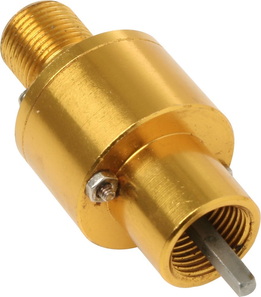

I just bought a used Baghira with a speedo that is in kilometers. Would like a speedo in miles/hour.
Thanks

hi there , well you got two choices if you want to keep the clock you have ,, you could either get a sticker that converts kph to mph that goes over the clock face , (very hard to find )or print one yourself ,
or a gear ratio adjusting device that fits between the front wheel speedo drive and the speedo cable..see my photos in the gallery and look for the gold device on my front wheel.
or if its a rat baggy just use tippex (corrector fluid in the usa) on the clock face and a marker pen,, :twisted:
there are two types , the blue one is for fitting under the clock(if there is space). But on a baggy ,there isnt.so you go for the gold one,,this fits at the wheel inline with the speedo cable.
kph to mph gear speed adjuster
