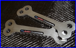

Hi All,
I'm 6ft6" and 110kg,build like a brick toilet cubicle,lol, Always thought the bike was a bit low but been told thats just me,, i'm too big,,i checked its not the hr model ages ago so i knew i neede a raiser kit .. word on this forum that bikefam. are the way to go but they're expensive and in germany,,post too high,$$$.Then i found a link here thats years old but guess what,,there still going strong and i've ordered a set of dogbones that let you have four choices of hight increase.I know i've paid just about the same as bikefarm but i get stainless steel and four options.
baggy tail raisers -1 to +40mm

just an update on how the bike rides with the maximum tail raise , no load ,balancing of the side stand the screw in the rear indicator to the floor measures 1000mm=1mtr,,it feels 1000 time better now in the corners,, easily have the confidence to proper drop it low and power out ,if you're tall or heavy or both i would recommend winding down the rear shock spring ,, adjust the damping to hard and a quicker rebound and raise the tail...i heard the factory setting for the spring weight is 75kgs,, is this correct,,
