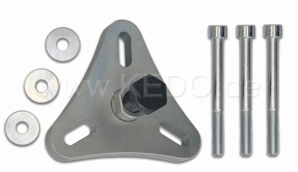

Postby edfmaniac » Fri Mar 29, 2013 7:03 pm

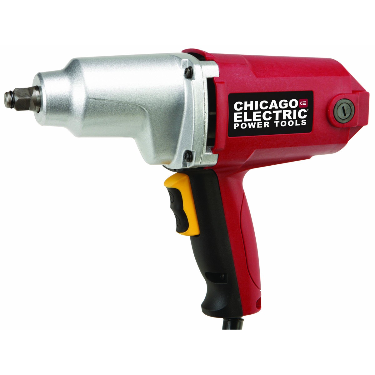

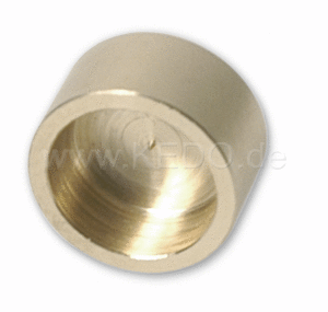

If you need to pull the flywheel, do yourself a favor and build one of the 1/2" plate pullers that are posted in previous threads or use KEDO's flywheel puller in combination with a good air impact. Harbor Freight's $50 electric 1/2" impact will work too. :D I thought something snapped when it finally popped off. :lol: Don't forget the thread protector that KEDO sells as well. You'll destroy your crank if you don't use something like it. As far as I know, the only US dist. is The Vintage Spoke. Their site is down right now but you can reach Tammy at tvs.tammy@gmail.com. Have your catalog numbers ready. http://www.kedo.com/products/30270.html KEDO also sells the Mikuni's that are already jetted for our engine.

Postby catman » Sat Mar 30, 2013 4:48 am
Yeah, I've surfed KEDOs catalog much.......Have gazed with a lustful eye at the MIKUNI carbs......good advice on the flywheel puller. Pulled a few Raptor flywheels to do starter clutch repair, and sometimes it makes you want to smoke a cigarette afterwards when that sucker finally cuts loose......
