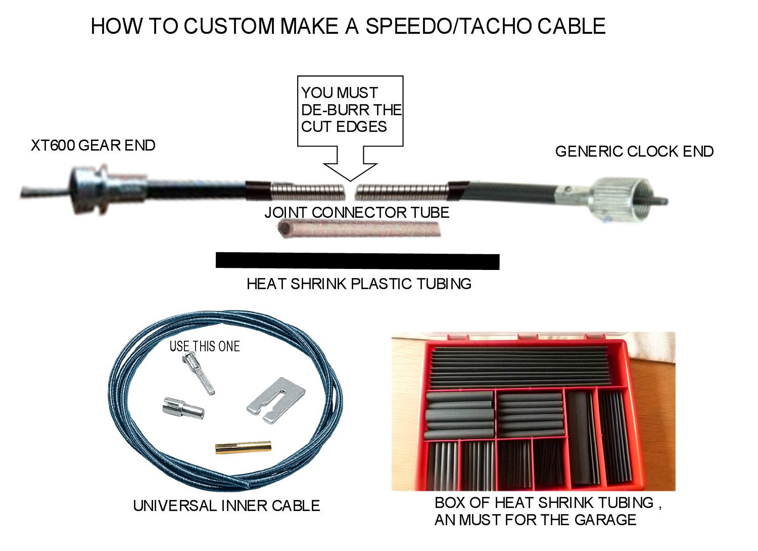

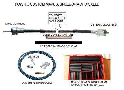

This is how i made the cable
first i bought an xt 600 cable, took the inner cable out and saved it , . attached it to the bike and its too short//.leave it attached and fit another odd cable (standard fit) to the rev counter,remove inner cable,,trail it down alongside the xt cable. now because you have to cut the cables its best to select an section that runs straight because to rejoin them i used a 2" piece of metal tubing and some heat shrink tubing to hold and seal.Now you have the right length and right fixing ends i purchased a universal speedo cable from ebay,it comes in a 1.3 mtr length and has a selection of end shaped drives that just crimp on when you have measured the correct size,http://www.ebay.co.uk/itm/Speedo-Cable-repair-kit-Top-quality-by-Motion-Pro-/190812987698?pt=UK_Motorcycle_Parts&hash=item2c6d572132,

Postby den » Sat Mar 23, 2013 11:51 am
Honeybadger wrote:Awesome, so I can just use an XT600 elbow, any old (square drive?) mechanical input tach, and what type of cable?
do you have bigger pictures, den?
ANY OLD TACH AS LONG AS THE RATIO IS 1-TO-4
