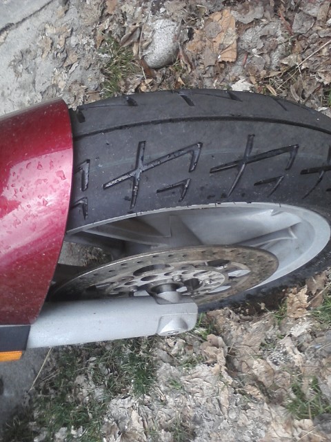

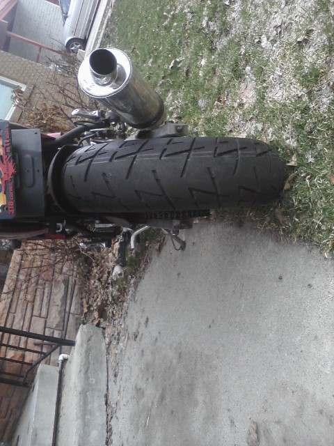

Those tyre sizes 120/70/17 front and 160/60/17 rear, are not recommended for a Skorpion as the wheel rim's are too narrow,
The front in particular will have pulled in the sidewall and made the tyre too pointy giving you a fast turn in and maybe nervousness at speed.
110/70/17 front is right, the standard rear fitment 150/60/17 is regarded by some as also being too wide, and a 130/90/17 as the ideal.

The fitment is called "+1" sizing(an industry standard term) and I have personally found, over the lhe last 35-ish years riding, building, pit crew and racing motorcycles, that "+1" works very well. Now as I stated in the o/p, for THIS weight and power level, the tires are OVER KILL..... no doubt.
Well the tires have a Really nice round profile and not "pointy" at all, the side wall is not angled out much more than the 110 was, 5-ish-mm per side is fairly un-noticable. a nice fit, not un-like the front of the Ducatti 750 SS that was next to it at the bike shop. Not nervous at all to 90-ish mph..... The mis matched tires were not the most stable at 80+ and the Speedo is ALMOST accurate now.....But opinions vary.......... :wink:
Rear
Front
