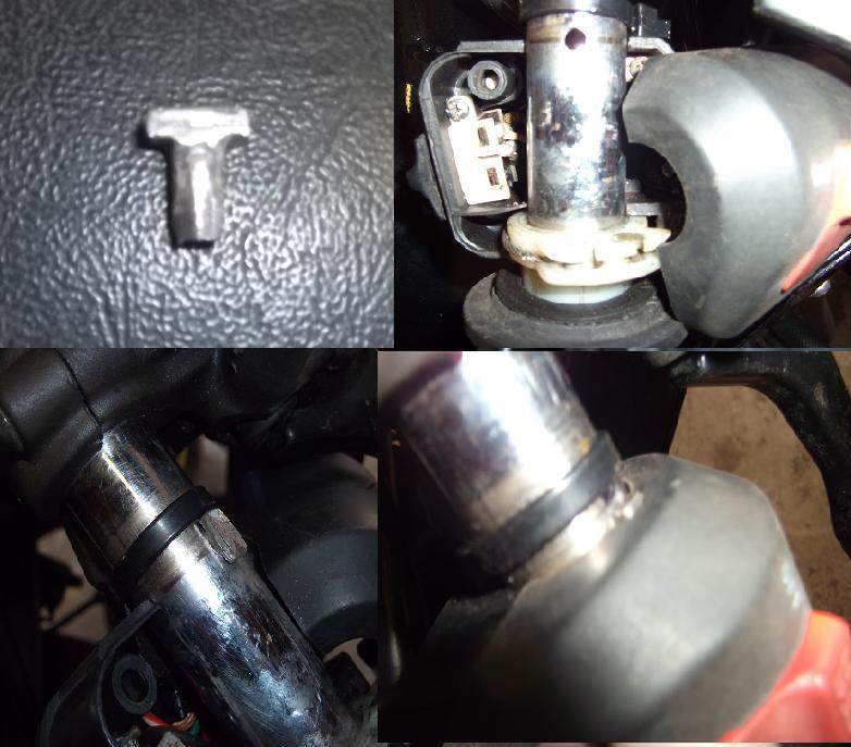

In the meantime I've managed to anchor mine properly :D Can't give photo's but will if I get time tomorrow. Firstly fitted Screws very kindly sent to me by Linegeist,( Thanks Mate you are a real Gent 8) ). As you say tightened up lovely and secure but still twisted on bars. Ages looking at it thinking how to strengthen pegs- but couldn't replace with steel and didn't want to put something weak back on which would just fail again further down the road. Why not have a peg in the handlebar which located into the switch instead? :idea: :idea: :idea: Hard to explain without pics but made a 3mm dia nail into a T shape by hammering/filing the head. The bottom leg of the T about half inch long, the top bar about 3/16". Marked where centre of the top left half (opposite end to the choke :roll: ) of the switch mated to the bars, removed it and drilled a 3mm hole in bars at that point. Insert bottom leg of T into the hole with the top bar running along in the same direction as the bars. Place top half of switch back on and mark position of the T peg where they meet. Then file small square notch in outside of the plastic housing so it sits nice and snugly over the peg, insert your screws and the jobs a good un........... If the top leg of the T is too long trim it off a bit and I guess it could be araldited into the bars to stop any movement or just made so it's an interference fit. Whatever, it works :D and I'm well pleased :D :D
Not the ideal engineering solution (for the purists) to the problem but if anyone can come up with anything better please let us all know................... :wink: :lol: A lot better than one of the PO's of mine who simply wound loads of tape around the bars and tightened the two halves of the switch onto it stripping the screws in the process of course.......wondered why the switches were a bit stiff :roll: Anyway hope that helps and will try to get a pic on tomorrow, if I survive the dentists :cry: :cry: :cry:

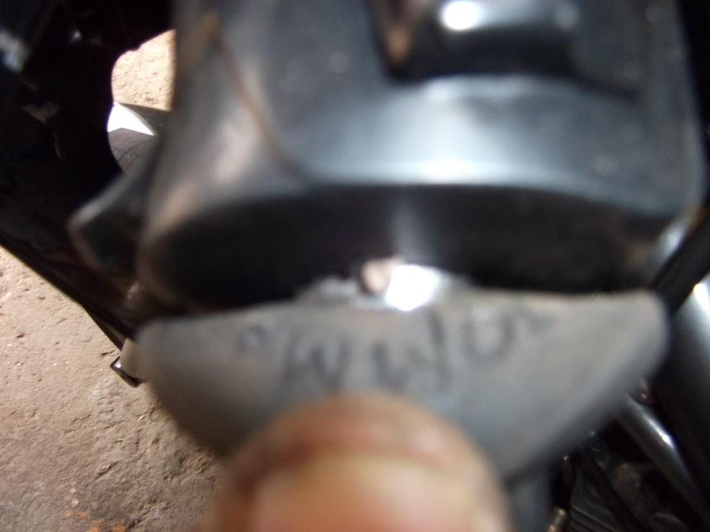

Here are the pics, sorry quality not good, glare from flash on chrome and wally pushing the button :roll:
1, Tpeg made as described. 2,hole in handlebar (make sure filings do not get inside the switch :wink: ). 3,Tpeg inserted in hole running in same direction as handlebar. 4,switch reassembled with notch filed out to fit over Tpeg. 5, Choke end switch, you can just see the peg sticking out between the grip & switch. This left on so you can see where it is but can be cut off flush. I intend loosening the switch off and run a very small amount of silicone sealer to prevent water ingress, but from the condition of inside both switches they are regularly full of water anyway.
No doubt others will have refinements or better practises which can be applied to this mod but it works! Both switches are rock solid, no movement at all, and it costs only a small proportion of 2 secondhand nails :lol: :lol: :lol: Now that's my kind of economics, wouldn't care to buy new switches.... :shock: how much? Hope this helps someone else too 8)
