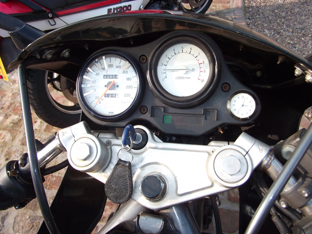

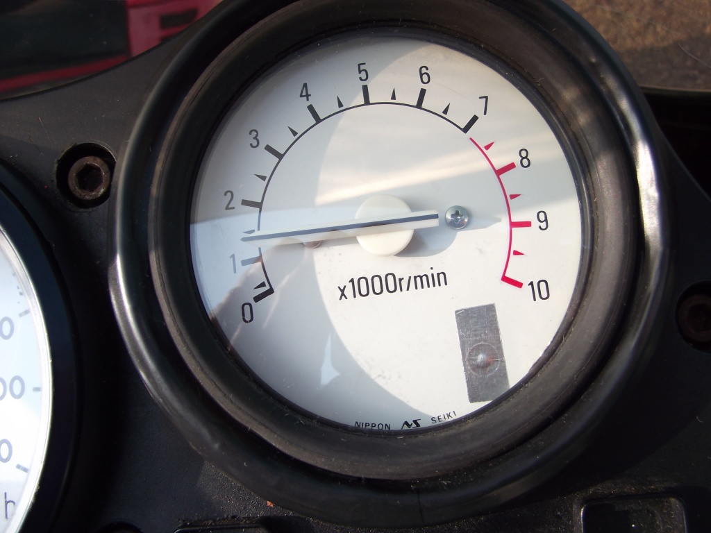

Well, can't find an original one anywhere so it had to be a mod. This is what I've fitted
It's electronic having same three lead (pos,neg,pulse) connection so is compatible and works :shock: It took some fitting and isn't a simple swap but I don't think it looks at all bad 8) Believe it or not, it came off a Yamaha XV1100 XV1100SE Virago approx 1996. Now need to adjust it a little as I think it's maybe overeading by 300rpmish, should be able to do that on the needle but if not it's near enough. Could have modded it to take the skorpion face but needle was very tight so left it as it was. Incidentally needle is rock solid steady and not a hint of a shake :D :D :D

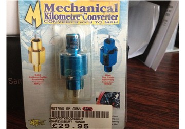

Just gave it another run and it hits rev limiter circa 7,500rpm. So maybe it's just about right??? Incidentally, has anyone tried a mechanical kph to mph speedo converter on a skorp? I see there are some cheap on ebay about £28 :?

Thanks - lucky I came across one, don't think I'd have tried it if I'd known what it came from! Will have to get it on a tuner to check actual revs but I now think it may be a little better than that. Seems to read only 100rpm over 7400 rev limiter, I can live with that 8)

mechanical kph converter,, If you look at my gallery you'll see i have one in line with the speedo cable at the wheel end , I'm using the gold one because i have limited space under my clocks , I have a blue one that does the same thats fits under clocks if you have the space,special price to my friends here , one only ,doh, £15
there geared to convert kph to mph but Ive never had chance to test how accurate they are , they have little gears inside so someone must have done the math,
Mechanicle speedo converter , blue is for under clock or gold for bottom of cable by wheel

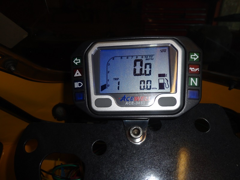

This the Acewell I recently fitted. Could'nt put up with the wavy tacho or the constantly blowing bulbs. Took me a couple of evenings to fit.(electrics are not my strong point). As to the fuel gauge,( obviously redundant) this unit was heavily discounted so being a tight fisted type I don't care if it flashes empty all the time!

Looks fine, thought of one of those but wanted to keep classic type appearance :D Always like a heavy discount too! :lol:
As an update, have now had my tacho checked out and it is reading spot on :lol: :lol: 8) Just my ear is not yet tuned to modern big singles, still listening to Enfields & Ajays in my mind :oops: Rock steady needle and doesn't look like it doesn't belong either. Great result 8)
