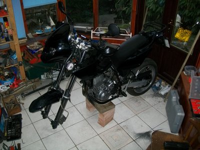

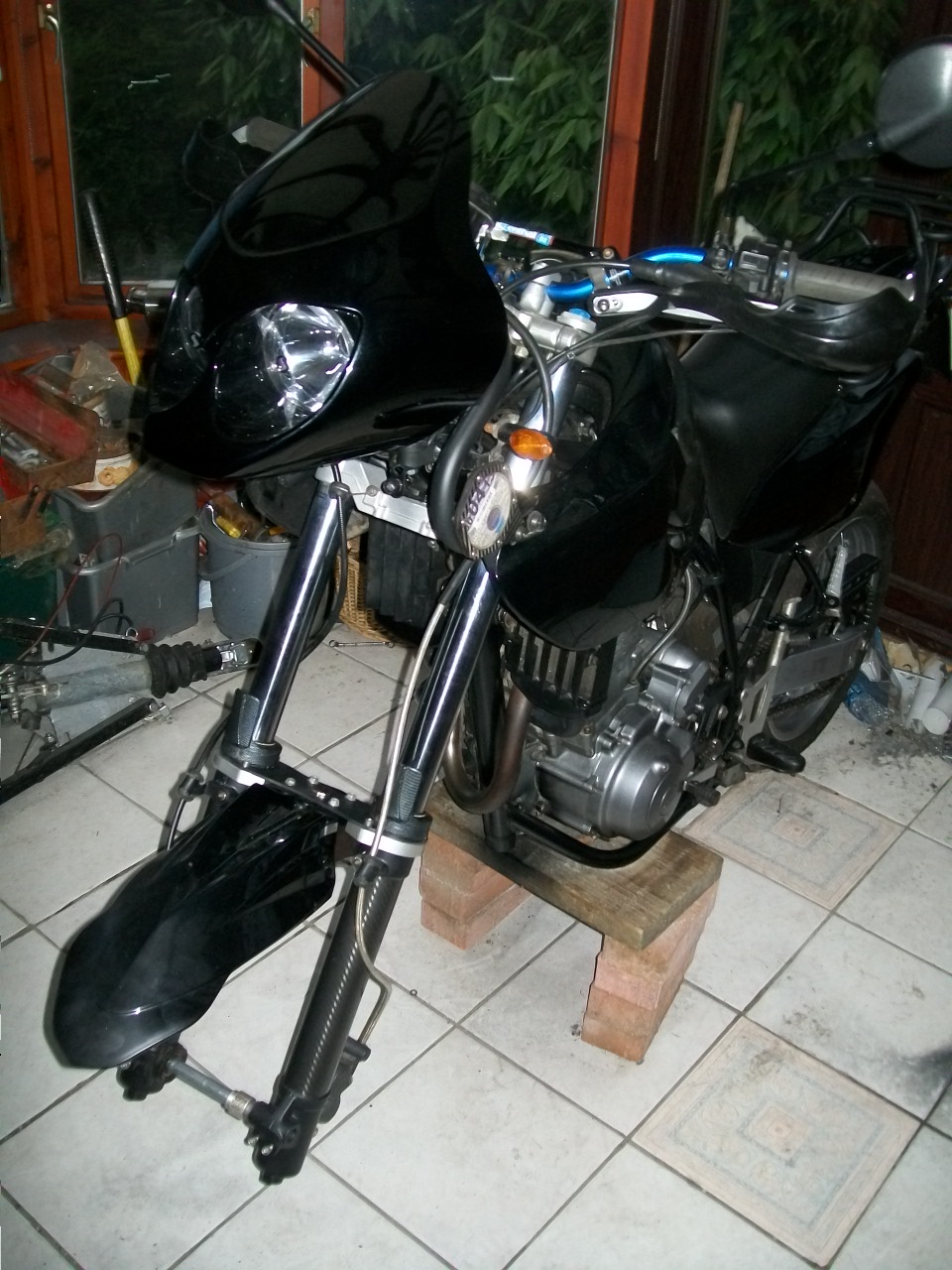

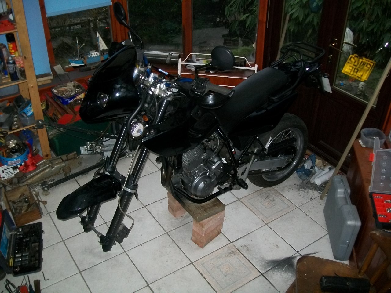

Mastiff Pics of work in progress. New lower yoke from German ebay (cost £100 delivered). New wheel spindle from German ebay (£30 delivered) Rebuilt Baggy forks Simson predator fairing. Saddle to be rebuilt (cost around £150 to £200) and twin exhaust to be made (cost under £100 for silencers and link pipes) and bars to be changed for clip on fireblade or 955i bars (cost about £30 from ebay). Wheel to be straightened

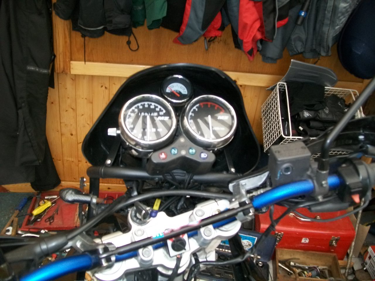

Simson side predator (cost £50 from ebay and £40 at simson to upgrade the lights) is an excellent fairing choice. Really easy to fit. Firestorm rentec carrier welded to hand rails (cost £5 for paint the carrier was surplus). Carbon wrapped lower forks (cost£2). Home made (cost £4 not £40)alloy fork brace mudguard mounting. Volt meter from chinese quad (bashan i think) has a matching chrome body like the clocks.
New wheel bearings, steering bearings, and fork seals. All bulbs to be converted to LEDs. Still to be polished up after that.
I think thats it so far.
