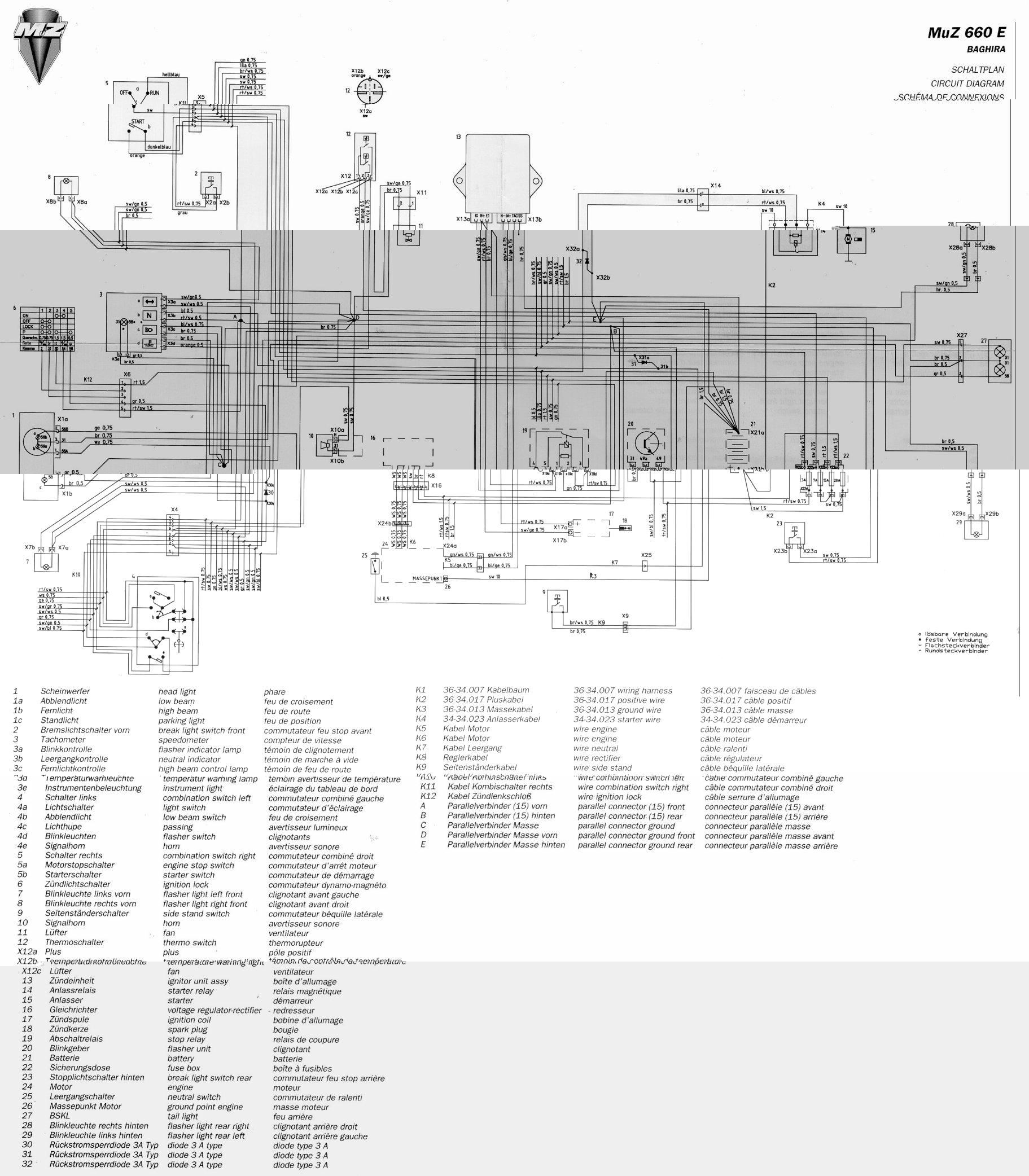

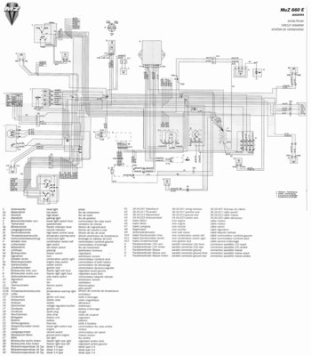

Postby OLDMTNCARVER » Fri Feb 22, 2013 2:44 pm
Mr. Large,
Wiring diagram...
