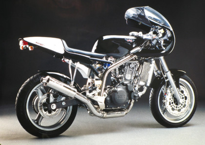

I spotted this one recently while browsing and some more pics here :
http://vicente-design.com/one-off-motor ... er-rocket/

Postby edfmaniac » Sun Feb 10, 2013 1:02 pm
Chalks wrote:It sound like a good plan to me! When you're drip feeding cash into a project it doesn't seem to feel so bad.

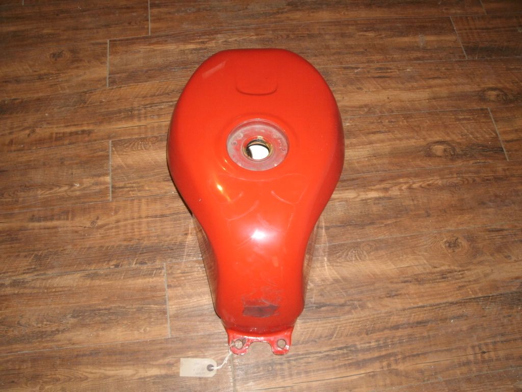

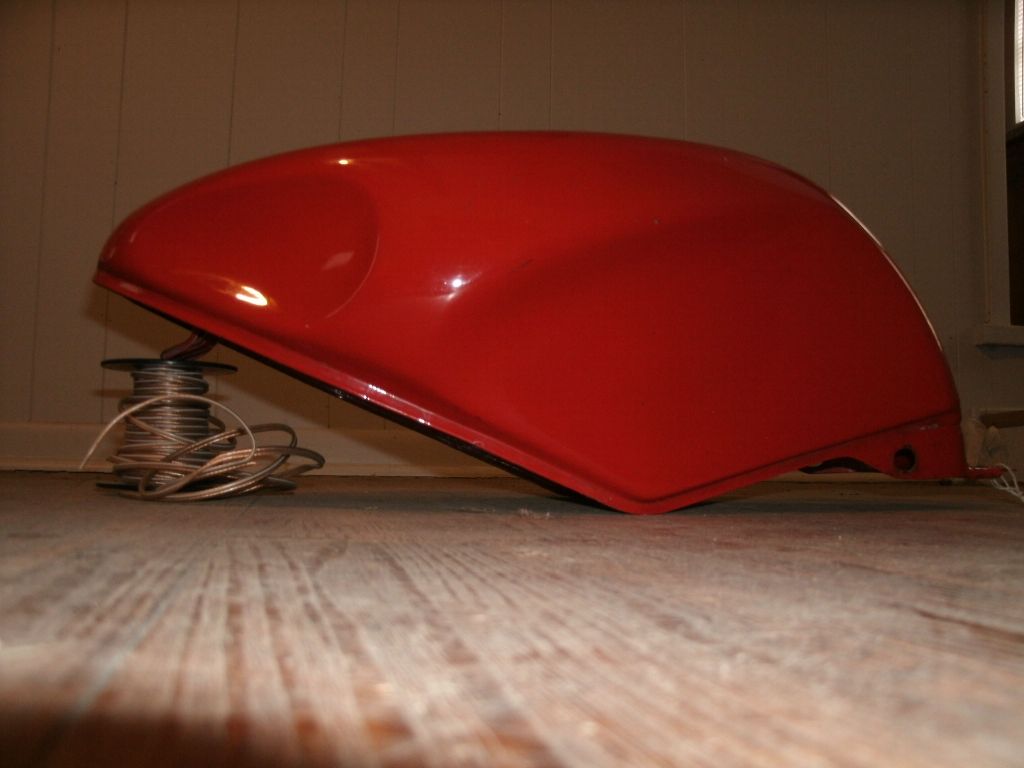

You've discovered the bike that inspired me. I actually got in touch with the person who designed that bike to find out what tank he used. It's off of a '93 Suzuki RG125. After many months of searching, I finally found a guy in England who would ship one to me in the US. My bike will have a similar tail on it but will be a little different, since I'm shaping it by hand, and both the tail and tank will be white with MZ logos. No fairing up front, just a big round headlamp with a Scitsu tach. Frame and swing arm, as well as the rims on the spoked wheels will be black. Hubs will probably end up being silver unless the gold anodizing on them is close enough to match gold Brembo calipers. New oil tank and subframe will be aluminum and will be set up similar to the custom bike in the photo. I'm shooting for under 320 lbs and 60 Dynojet hp at the rear wheel.
Postby edfmaniac » Sun Feb 10, 2013 7:03 pm
Here are some pics of the RG125 tank so you can see the shape of it more clearly. I never liked the shape of the stock tank, even when it had all of the body panels in place.

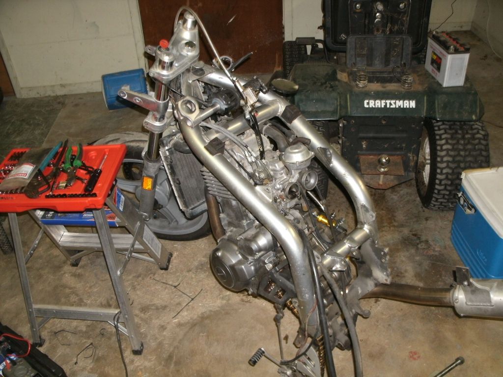

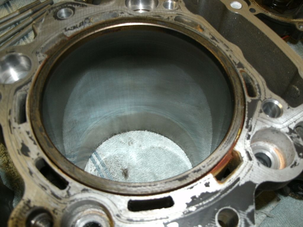

The engine is almost as disassembled as it's going to get for this rebuild. Flywheel and balancer drive gear still need to come off but so far, everything that isn't getting rebuilt or replaced looks good for quite a few more miles. It looks like the head had been off because there was black silicon everywhere, but considering the engine has around 40k miles, I'm pretty happy with the condition. The cylinder still has hone marks around all but a small section where the stock piston skirt was rubbing. You can't feel any grooves or ridges. I was even pondering reusing the OEM cylinder with stock bore hi perf piston instead of the 686cc aftermarket cylinder and Weisco piston that I already have. The aftermarket casting isn't nearly as nice as the OEM casting and I think I remember someone saying that boring this engine really doesn't do you much good until you stroke it too(edit:dont' listen to me about the stroke). Decisions, decisions! :?:
The head is getting sent off for port, polish and valve job to a guy who comes highly recommended on the Raptor forums. He's been doing porting for over 20 years, seems like a real nice character on the phone, and will do the whole head for $350 plus any valves or other parts that need to be replaced. If memory doesn't deceive me here either, oversized valves and/or upgraded spring/retainer system aren't necessary for Stage 1 modifications.

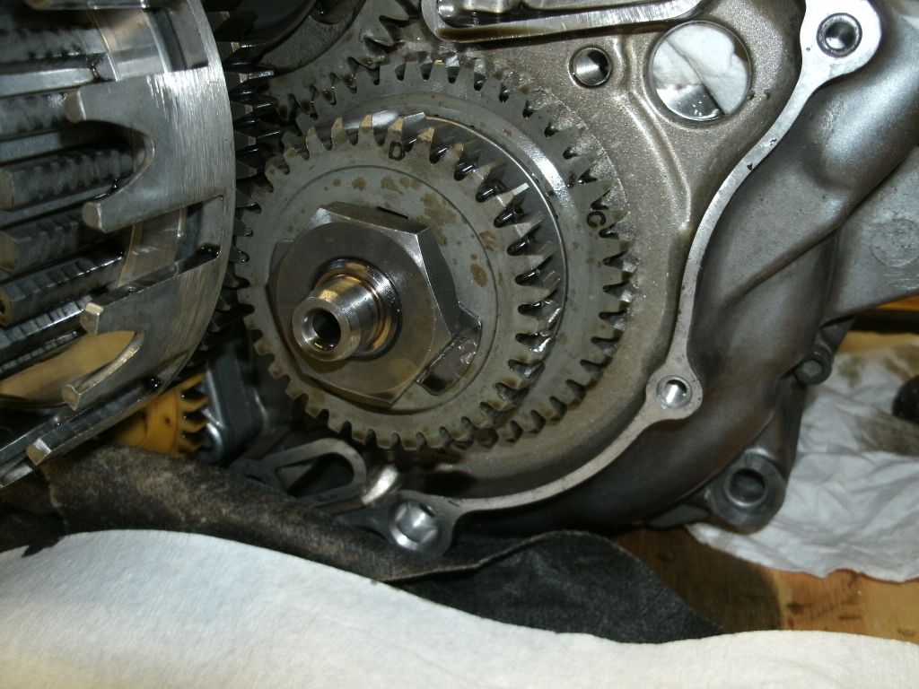

Will you let us know wether the nut on the balancer drive wheel is loose and only held in via the retainer washer,Also ,did you find the sprung drive gear,how was it , word it it comes loose and damages the keyway,,Ive bought a solid one from a raptor to replace mine just in case,

I already opened up the retainer washer and gave an initial try to break the nut, but I didn't get to put that much force on it without having a friend to hold the engine down. It isn't reverse thread is it? And are any of the other shafts inside the engine reverse thread? I will post info on the gear when I can get it off. Thanks
Postby edfmaniac » Fri Feb 15, 2013 10:20 am

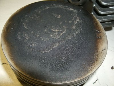

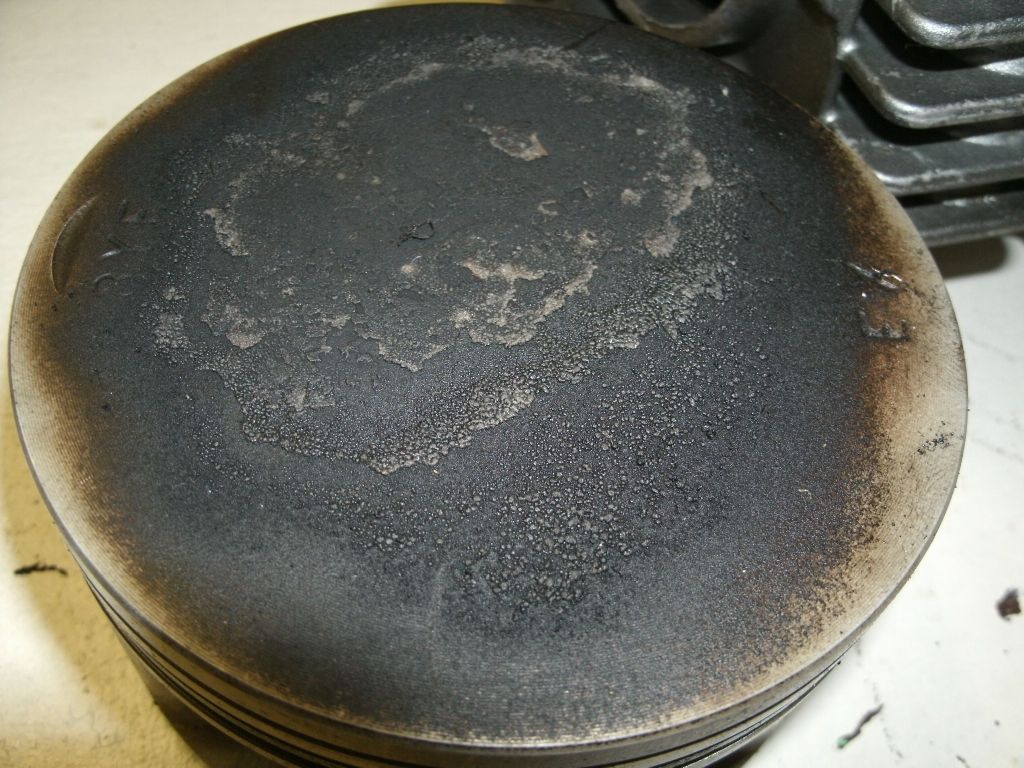

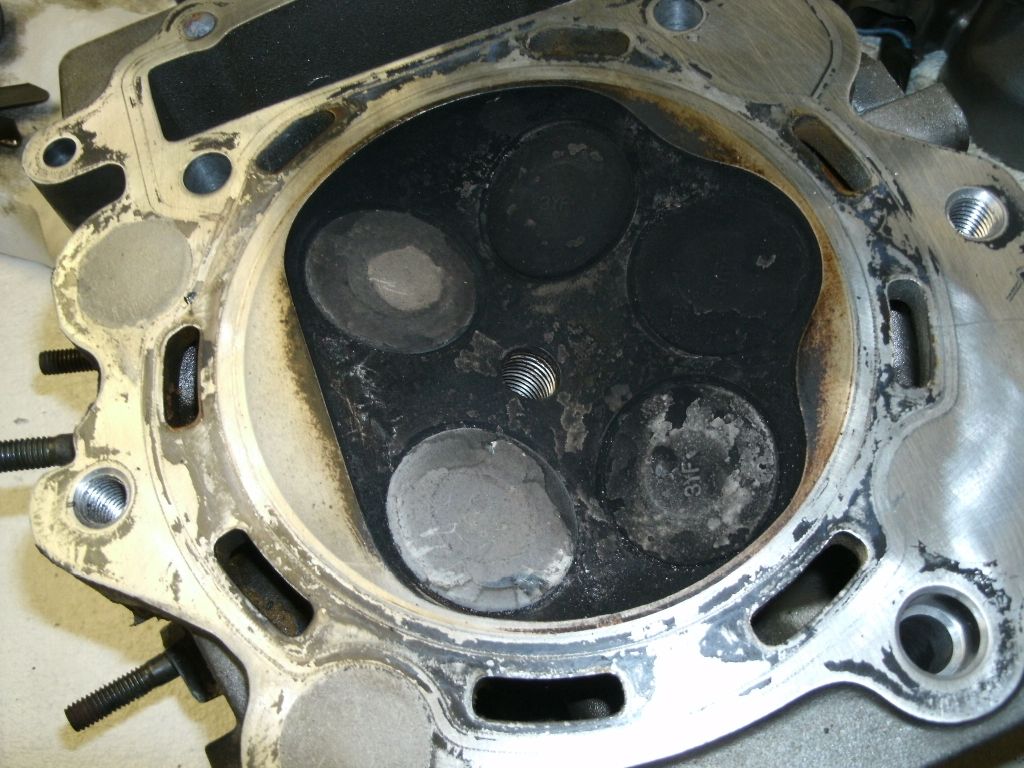

Here are some pics in case they help anyone. I also have some questions about the condition of the combustion chamber. The plug was a light tan so I was expecting to see a chamber that looked pretty good. Instead I found this build up that looked almost like mineral scale on both sides of the exhaust valves, as well as the usual carbon build up. The photo of the cylinder shows the only vertical wear marks to speak of.

Postby basser23 » Fri Feb 15, 2013 10:45 am
by your pics,it seems almost normal...perhaps the exhaust valves were running too tight...you said head had been off before, may have been running rich for awhile too..
since you're sending the head out anyway,see what your machinist says.....

basser23 wrote:l...perhaps the exhaust valves were running too tight...
The exhaust valves had some gap because I could move them @TDC. The intakes were all 0 gap. :shock: What will that do to your performance?
Postby Chalks » Fri Feb 15, 2013 2:45 pm
No valve clearance is bad! It can contribute to premature cam wear, burnt out valves and seat, poor performance, bad starting, etc etc. It's bad maintainance if they're out, it's an hour's job tops to keep them within tolerance.
You'll need the clutch drum off to check the nut on the balance shaft, on my spare motor it was as slack as piss! :evil: The gear itself was a bitch to pull from the balance shaft probably due to early stages of a keyway being pummled! The sprung gear that causes the balance shaft damage is on the crank shaft.
It may be a good idea, if we change the the sprung gears on our cranks, to pull the balance shaft gear fron the shaft and check the keyways just incase it's too late. I haven't had time to replace mine yet but the bike is parked up far away from the salt that's being sprayed on the queens highway. :(
