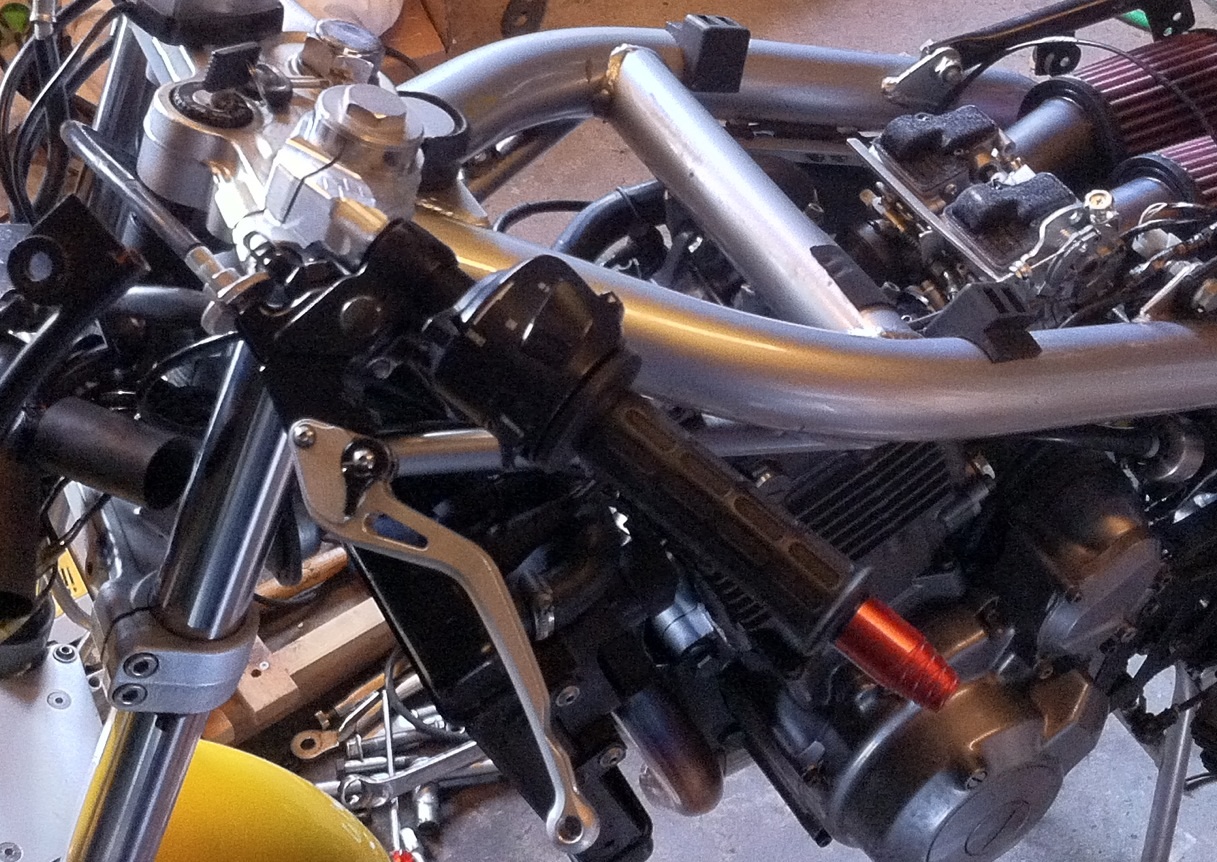

just use the whole perch from another bike. I'm using R6 lever.

mforza wrote:just use the whole perch from another bike. I'm using R6 lever.
Lightbulb moment. I can also try the one of my other bike just to see.
World of adjustable levers opens up!

Bought a used set '05 Yam R1 brake and clutch lever with adjustable ABM levers for about $ 40,- ... Must say the brake cilinder is to big for a single disk setup. But the clutch is much easier, helped by a straightened routing. This also meant a new inner cable due to the length of the clutch lever setup. Worth it.
