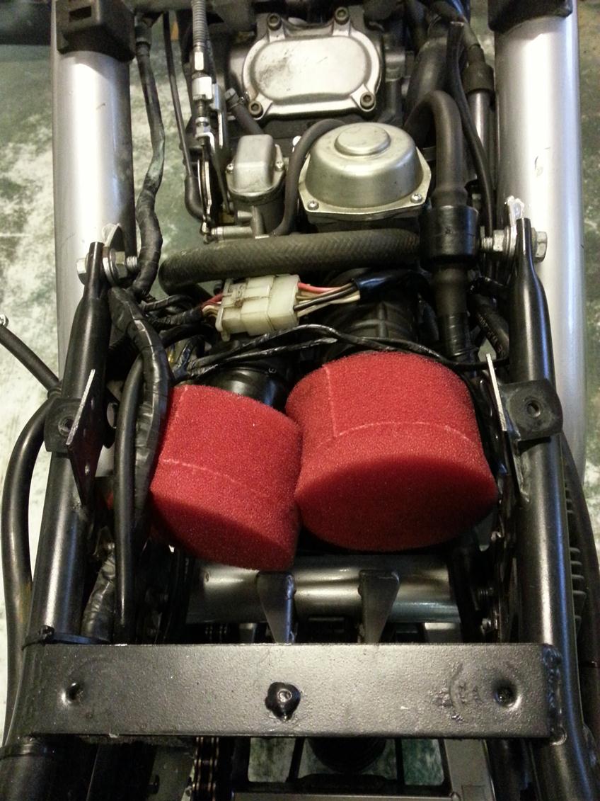

I found these neat foam pods and have fitted them on my 96' Skorpion. Due to their size I had to mount them on the "trunks" from the OE airbox.
The intake noise has improved dramatically and makes me long for spring even more :D

intrested in the product name and part number. Also where/how did you relocate the battery?

I have no idea whatsoever concerning parts number on the pods. I've bought them in a swedish low-budget warehouse for car parts :roll:
Try this link: http://www.biltema.dk/da/Bil---MC/MC/Re ... ddy-82596/
I'm gonna clamp the battery to the subframe crossbeam just behind the pods. Doing that I dont need to alter the wiring and it gives a bit of protection from any rear wheel spray.
Hopes this helps :D
