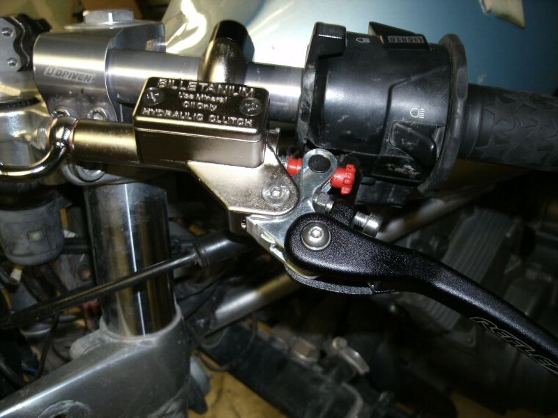

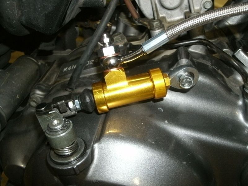

Installation complete for now. I'd like to add another 1/4" or so to the bolt that screws into the engine case, as well as the spacer, to relieve the angle on the slave cylinder a few degrees. Evidently the Raptor case is quite different in that area because there is no way that the Raptor kit will fit the Skorpion without a few little tweaks, but it does work. I also had to notch out part of the switch housing to allow clearance for the clutch lever. It didn't hurt my feelings too bad because once I get most of the components in place all of the switches are to be relocated when the simplified wiring harness gets built and the tear down/paint/rebuild happens.

hydro is better in every way IMO. I had one on my zx7r and it is one of the only complaint I have a bout the MZ. I think this will be on my list here, what an awesome kit. I wish it hooked up a little better though. I'd feel more comfortable if they had a bracket or something off of the frame aside from the case bolt.

I'd go with the Magura if I had to do it again. It's a little more money but appears to be a superior design and uses a stock style bracket, if not the actual stock bracket.

Took your advice and ordered the Magura kit. Figured I would try the Raptor 660 kit and hope for the best. Worked pretty damn good. The actuator on the clutch end is way too long for the Baghira but there are ordering instructions to get an actuator the proper length. I just piled a bunch of washers until the length was correct. The clutch lever fits without any modification to the switch housing but the angle has to be just right.. cannot rotate it too much.. But for me, it ended up where I wanted it anyways.
