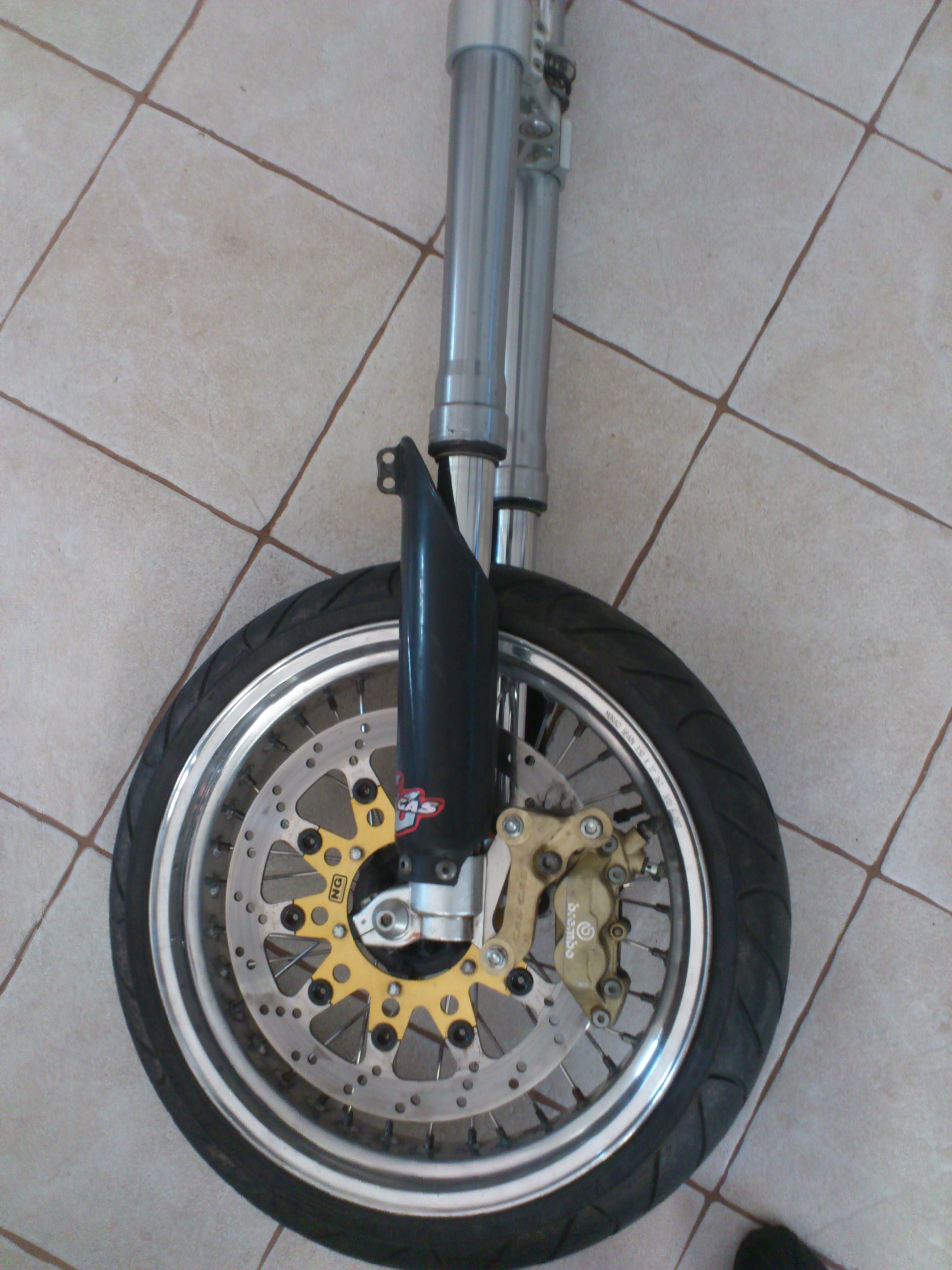

Postby Chalks » Tue Oct 09, 2012 3:43 am
Hi, I've recently broken a 450 Gas Gas with 45mm Mazorocci upside down forks, 17 inch Supermoto wheels, 320mm disc and 4 pot Brembo caliper. I can't help thinking how sweet they'd look on my Baghira. I'm sure resprung they'd work well and it would sort out my wooden brake problems. I have a friend that works in a machine shop and I'm sure he could make me a steering pin if required.
Any tips on the conversion or if they would be suitable for the job would be much appreciated.

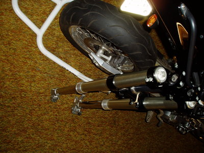

Postby malachi » Mon Oct 15, 2012 4:16 am
these are the one's on mine think they are ccm but maybe wrong

Re: Baghira upside down forks???
Postby Chalks » Wed Oct 17, 2012 4:28 pm

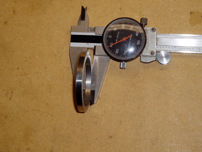

Postby OLDMTNCARVER » Wed Oct 17, 2012 10:58 pm
The Baghira steering head uses bearings with the outside diameter the same as a 1999 - 2003 YZ Yamaha.
The YZ steering head stem of those years works but is too long.
The solution is to make a spacer with the YZ bearings O.D. and .190 thick and it's a bolt on, useing the YZ bearings and triple tree or stem of course...
Spacer .190 inch
2003 YZ Forks with TAG Triples
Regards,
Robert
Postby DAVID THOMPSON » Thu Oct 18, 2012 8:35 am
did you place the spacer on the top or bottom of the stem
Postby OLDMTNCARVER » Thu Oct 18, 2012 10:10 am
David,
I believe I installed the spacer between the lower bearing and head set, not the upper.
I recall the YZ bearing and race thickness being less than the factory type allowing contact between the head set and the lower triples casting... I'll check it as soon as I can, and provide pictures of the assembly.

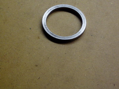

Here's another view of the spacer.
Regards,
Robert
